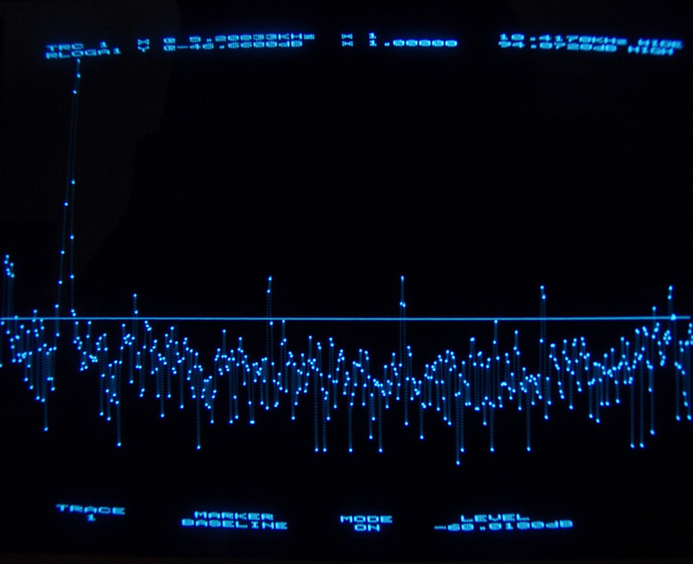

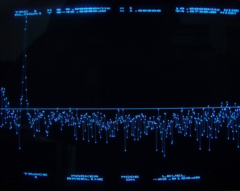

I bypassed the SAA7220B/P and now all tracks look very nice. The problem was caused by that spunky digital filter!
Still, the low level linearity is better with the SAA.

A very good TDA1541A S1 with oversampling filter SAA7220B in a Philips CD960, no averaging = original noise floor.
The horizontal line marks -60dB relative to the input signal.
Now the SAA7220B bypassed, no oversampling.
There is K2, K4, K6, K8, K10, each 10dB above noisefloor.
You hear it...
