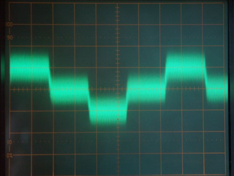

In both oshifis and my measurements it looks like some bits are not stable = oscillating or ringing, maybe it has to do something with the DEM.
oshifis said:
Each step is 16 samples
And each corrupted step ( bit ) includes exactly 16 spikes. 🙂
I am not sure about this. I will check the tracks with Waveditor, but each level has 16 identical HEX values, so the problem must be somewhere in the chip. It would be good to know more about the internals of this DAC, especially the active dividers that SoNic_real_one refers to. I will also disable the DEM clock just to see what happens.Bernhard said:And each corrupted step ( bit ) includes exactly 16 spikes. 🙂

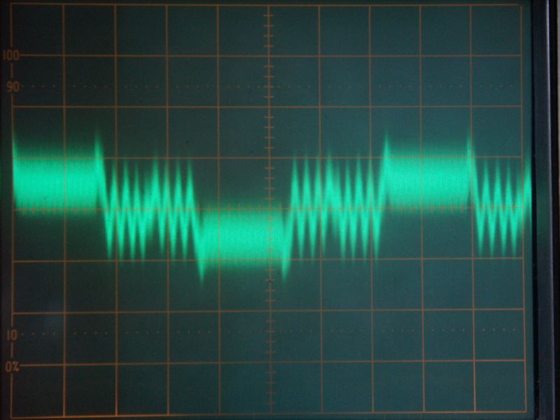

I measured several TDA1541 and 1541A and they all behave differently. The strange distortion seen on Post #24 occurs at different tracks/bits on every sample of DAC chip. I have suspect that it is somehow related to the DEM clock. Now the task is to find a sample that shows the waveform seen on Post #23 at each bit...
oshifis said:Now the task is to find a sample that shows the waveform seen on Post #23 at each bit...
Remember: Every TDA 1541 has two channels
Yeah, but both channels behave identically on every DAC I measured so far...

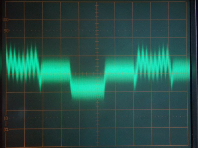

Hm, I found some interesting: I replaced the SAA7220P/B in my test Marantz CD-94 to a SAA7220P/A and the waveform of Post #24 moved from Track 3 to Track 2. In general, most bits up to bit 9 are nearly perfect with the B version. Bit 10 to bit 15 looks like Post #25, 26 and 27.
And this is identical with every TDA1541A chip I tried so far (maybe there are some minor level differences, difficult to read off the scope)...
I tried this also on a Marantz CD-74 modified to NOS and digital filter bypassed. Here most bits are perfect or nearly perfect, except bit 9 which shows some oscillation-like noise on the bottom level, but not serious. Another reason for NOS?
