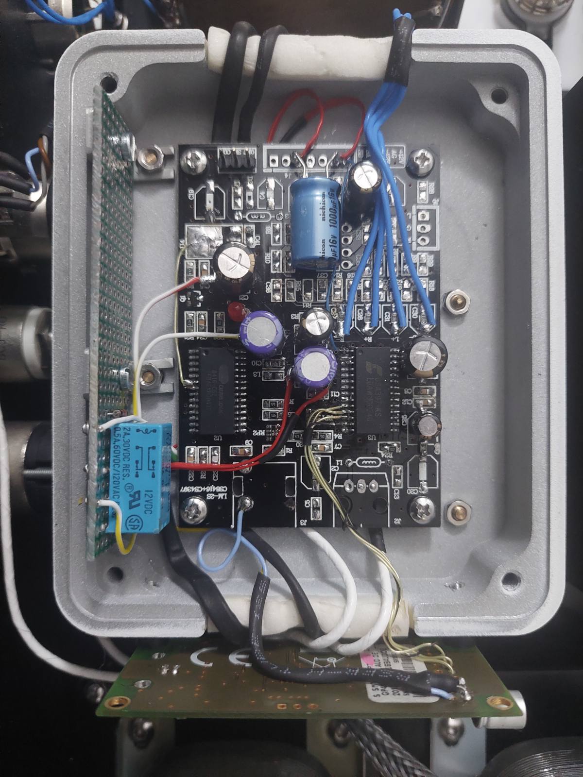

In this setup with the Lampucera 1.0 and Lampizator CS8416 + CS4397:
  • The CS8416 functions as the S/PDIF receiver, feeding the digital signal to the CS4397.
  • The CS4397 then converts the digital signal to an analog voltage output, which can be passed directly to the analog stage or amplifier.

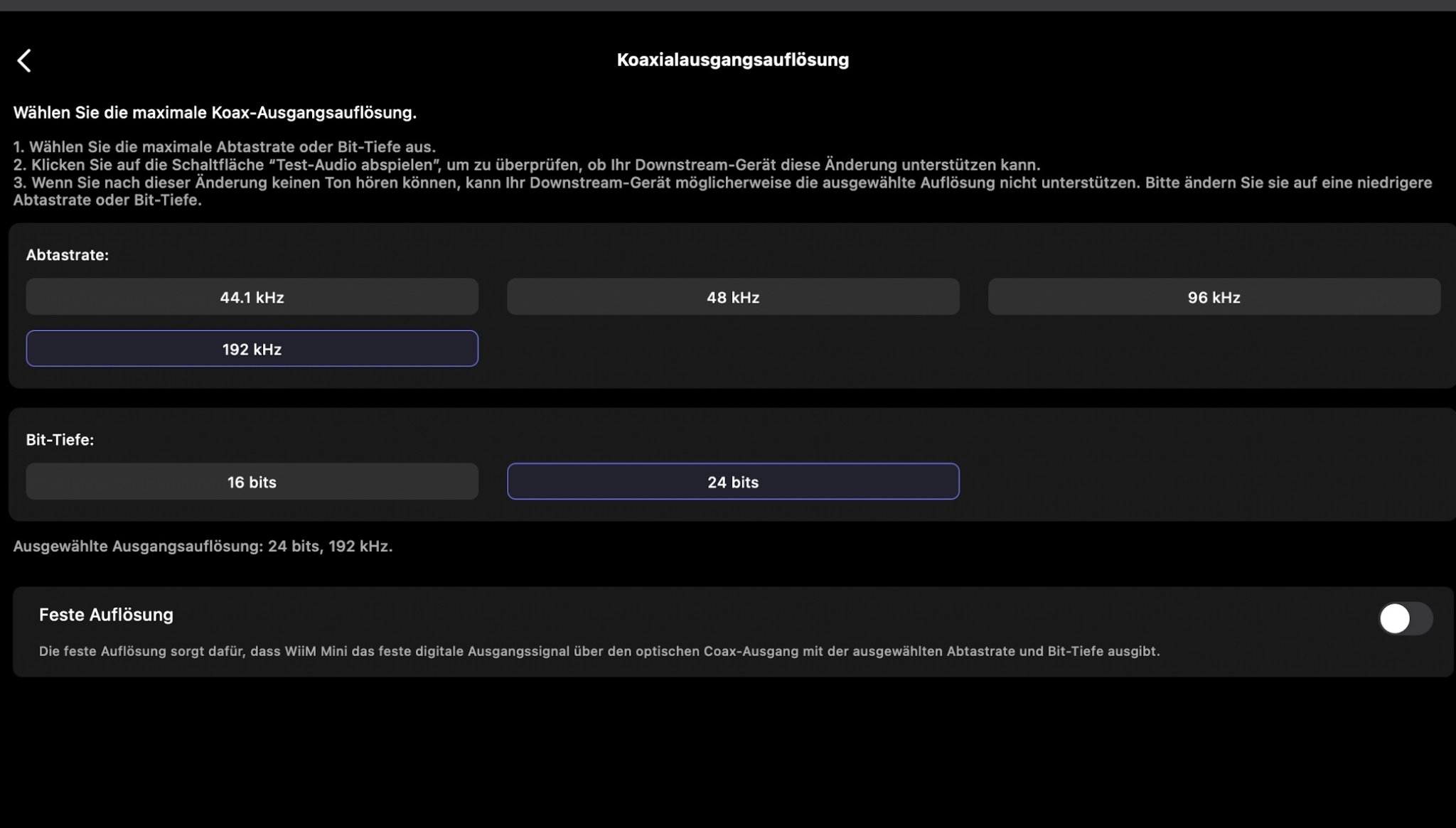

not sure, what you mean, Puffin. I run this DAC right now on these settings...

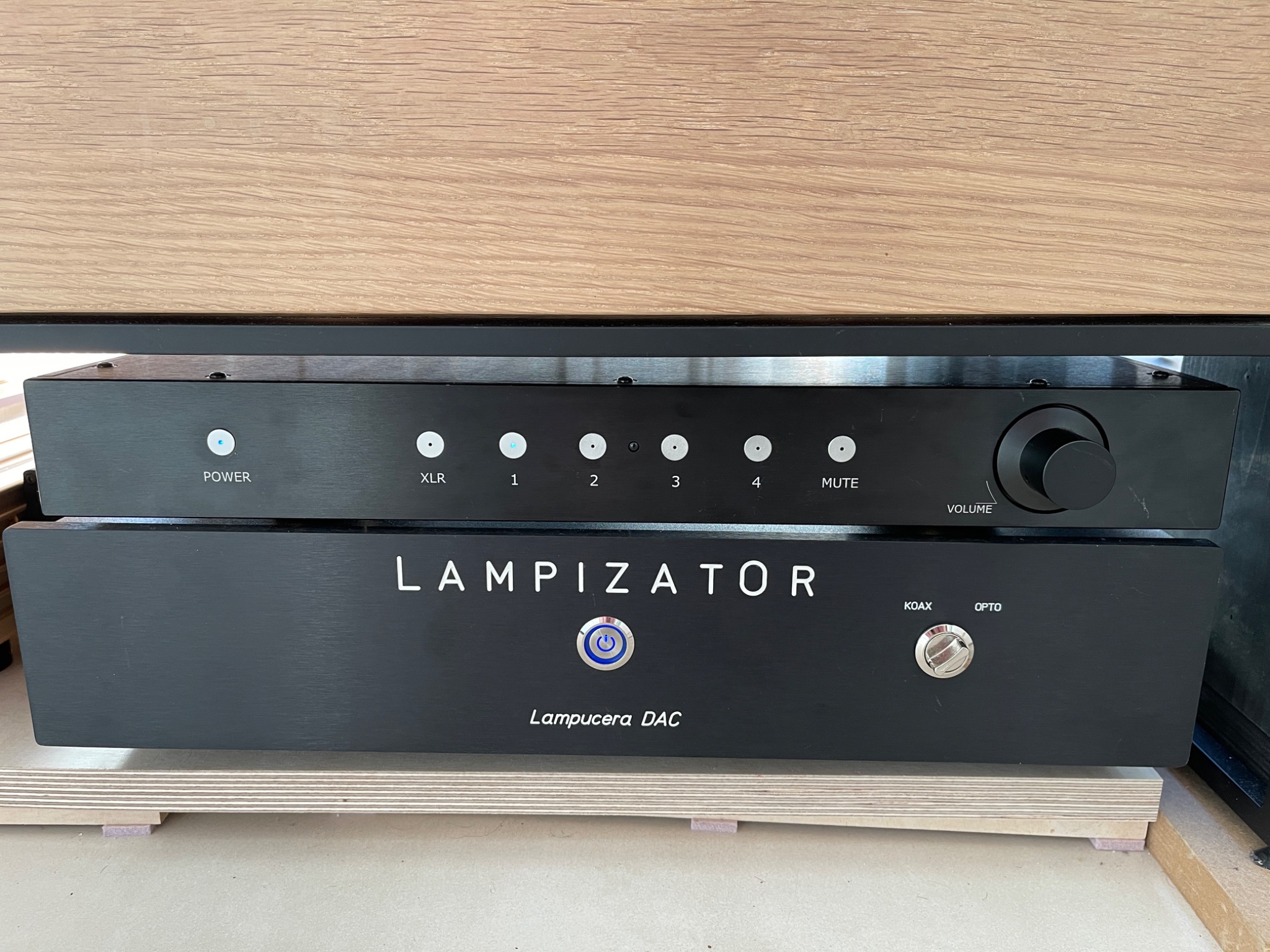

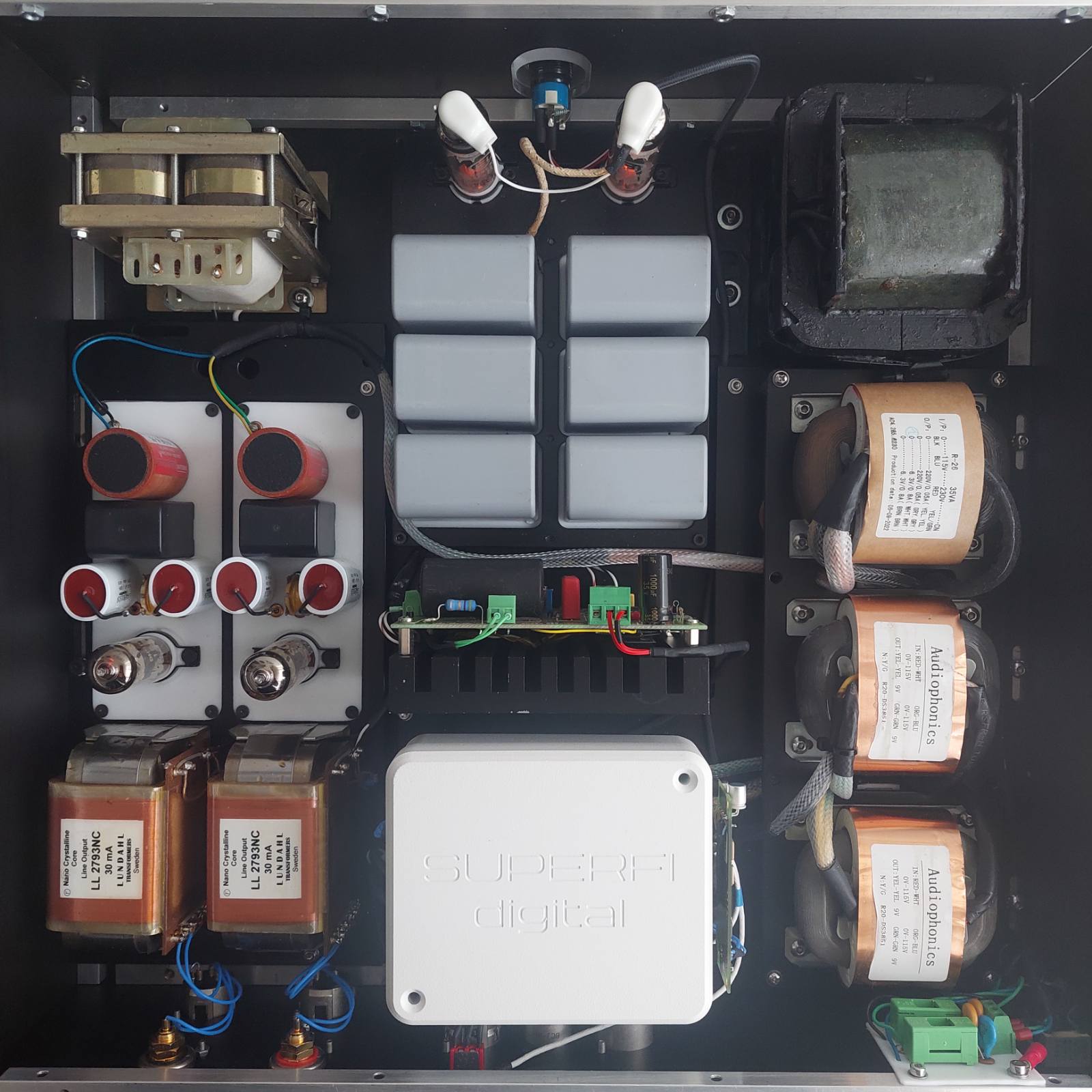

Another Lampucera, this time slightly different output section (very much Raven-like from Lynn Olson)
Tubes used are E182CC, OPT are Lundahl nano-crystalline LL 2793NC, B+ is shunt regulated by Vacuum state Superreg etc...
Audio path compenents are on teflon as well all DC link caps and damper diodes PY88.
Build entirely by a member here, @simplicisius
Must say its end game DAC for me...quest completed. Before I had few Lampizator's and Aya form Pedja. I like Lampucera most.

I can no longer use the Wiim Ultra's USB output to connect to the UAC-1 and then via coaxial input to the DAC. The USB option cannot be selected, as my Lampucera does not provide the necessary feedback. This issue, though unusual, is mentioned in the Wiim forum. As a result, I now play directly from the Wiim Ultra without using the USB connection. Can I hear a difference? No idea. I will try to experiment with different higher tier streamers.

You lost me. What has the USB option to do with the Spdiff connected Lampucera?
