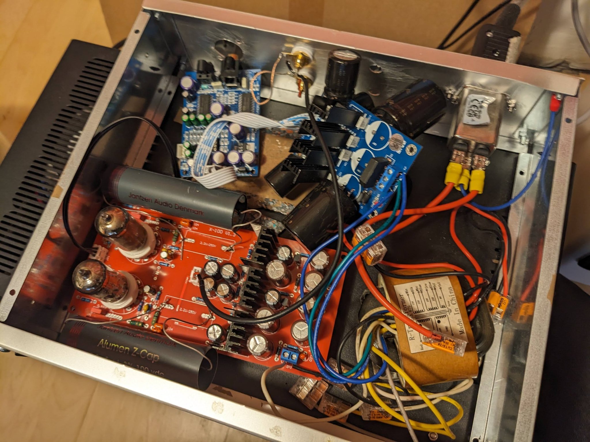

What caps did you recap? I went for the two big ones on the tube buffer board, changed them for Jantzen Amber Z Caps. Also I changed the caps on the power supply board for bigger ones, had to solder some of them to the back of the board and now it doesnt fit anymore in the housing haha. Any ideas how to fix that? I dont even know how to fasten it properly now.Excellent kit but need separate good power supply for the DAC and the Buffer. Also remove the op amp chip if you decided to go with tube buffer.

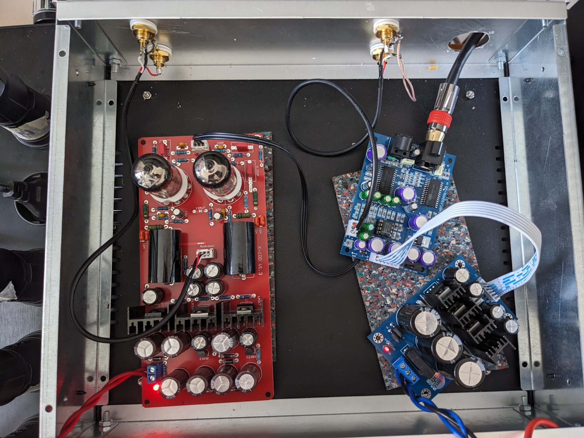

@ Sebastian: I went for the tube version, preferred in my setup. I can send you a picture of the parts later, I never got to really fastening everything properly though.

I went with mundorf. Need to move some to bottom of the board and rise it up.What caps did you recap? I went for the two big ones on the tube buffer board, changed them for Jantzen Amber Z Caps. Also I changed the caps on the power supply board for bigger ones, had to solder some of them to the back of the board and now it doesnt fit anymore in the housing haha. Any ideas how to fix that? I dont even know how to fasten it properly now.

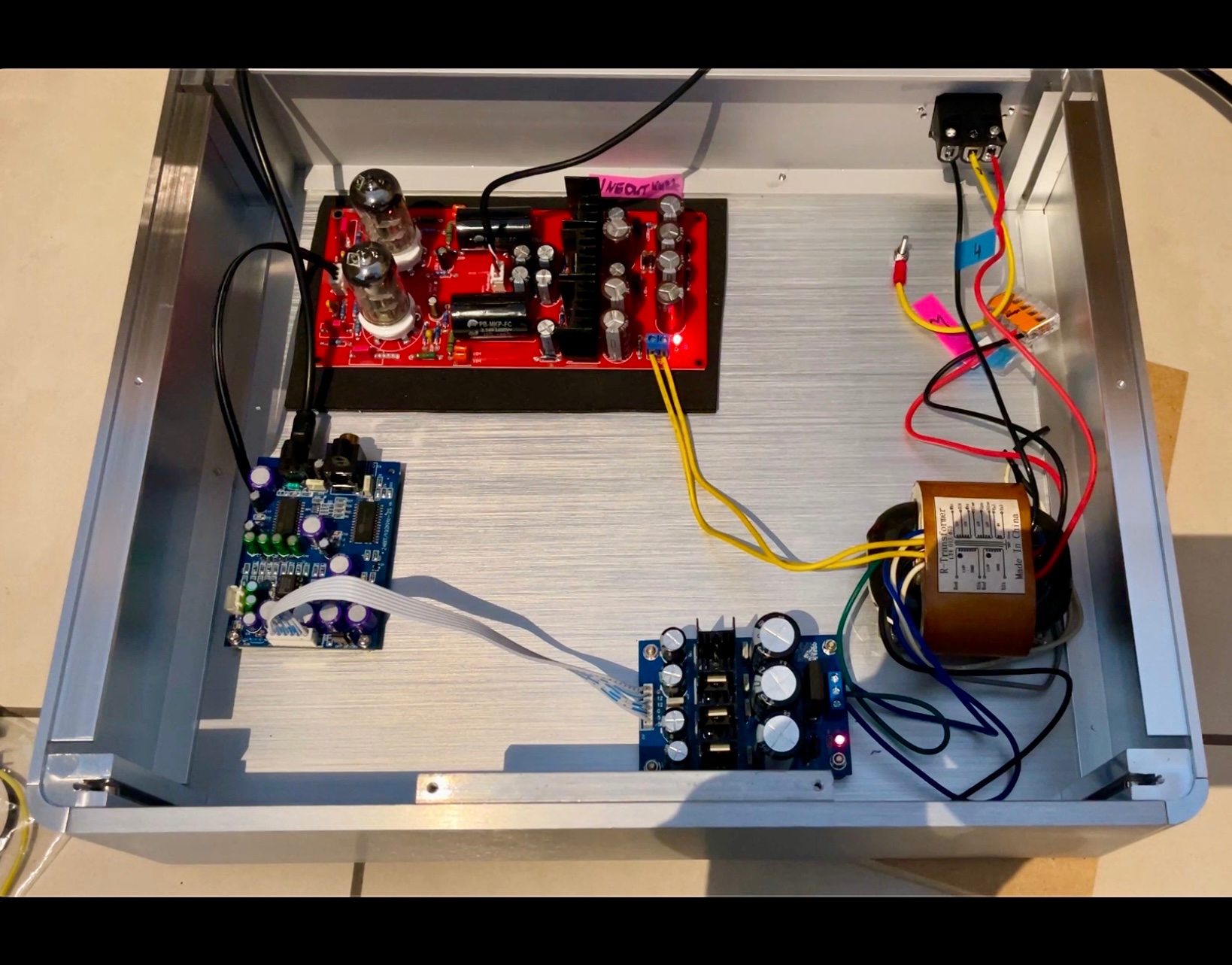

Both op amp and tube buffer sounds good and I love the options of having both.

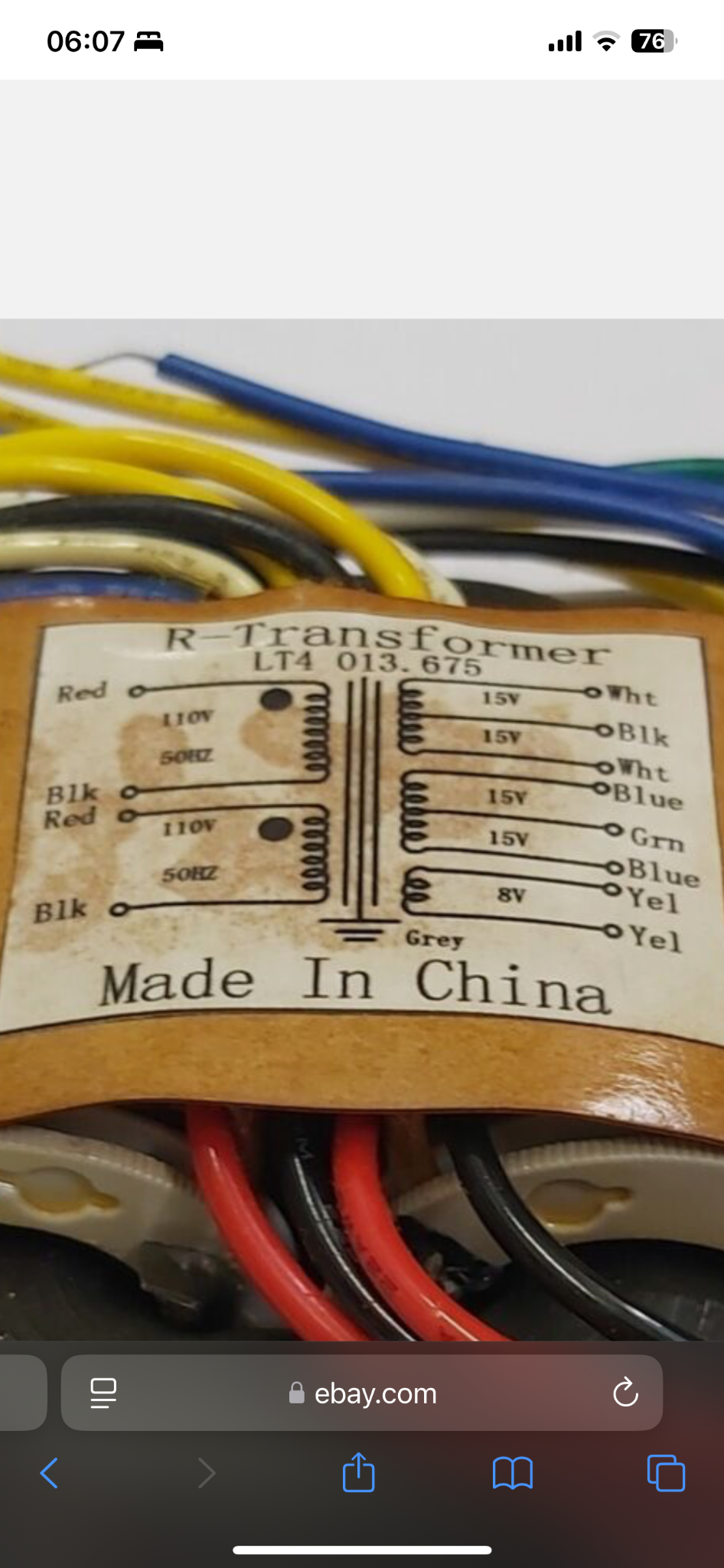

I can say that I am successfully using his r-core transformer for both boards and it works really well. Probably 2 are gonna be better but I am not sure by how much. I might be experimenting with r-core and toroid at some point but at the moment I am barely using the Lampucera anyways. Have you already ordered it?Thanks for your prompt reply. Pictures would be much appreciated. Thanks for the heads up on the placement. I will try to come up with something. Please advise on the two transformers. This is what I got from the kit seller as info, see picture. But it is a primary/secondary r core type. I‘d rather go with two separate units.
Looking nice! Did You change the tubes as well? I went with Amperex Bugle Boy NOS as recommended by the seller. They sound a lot better than the stock ones.I went with mundorf. Need to move some to bottom of the board and rise it up.

I ordered the kit twice. One with the tube section and the other without. I have not ordered his r core yet as I found it overpriced. I am spoiled price wise by all this black week „nonsense“. I will try to find an alternative today. If not, then… helas, I will take the mentioned r core unit.
Yes, I have the bugle boy, genelex and the stock Chinese tube that came with the set. Depends on what I match the pre and amp with. Like the Chinese tube really compliments the McIntosh. Amperex goes well with my Gryphon. Genelex, once’s burned in, is in between the two.Looking nice! Did You change the tubes as well? I went with Amperex Bugle Boy NOS as recommended by the seller. They sound a lot better than the stock ones.

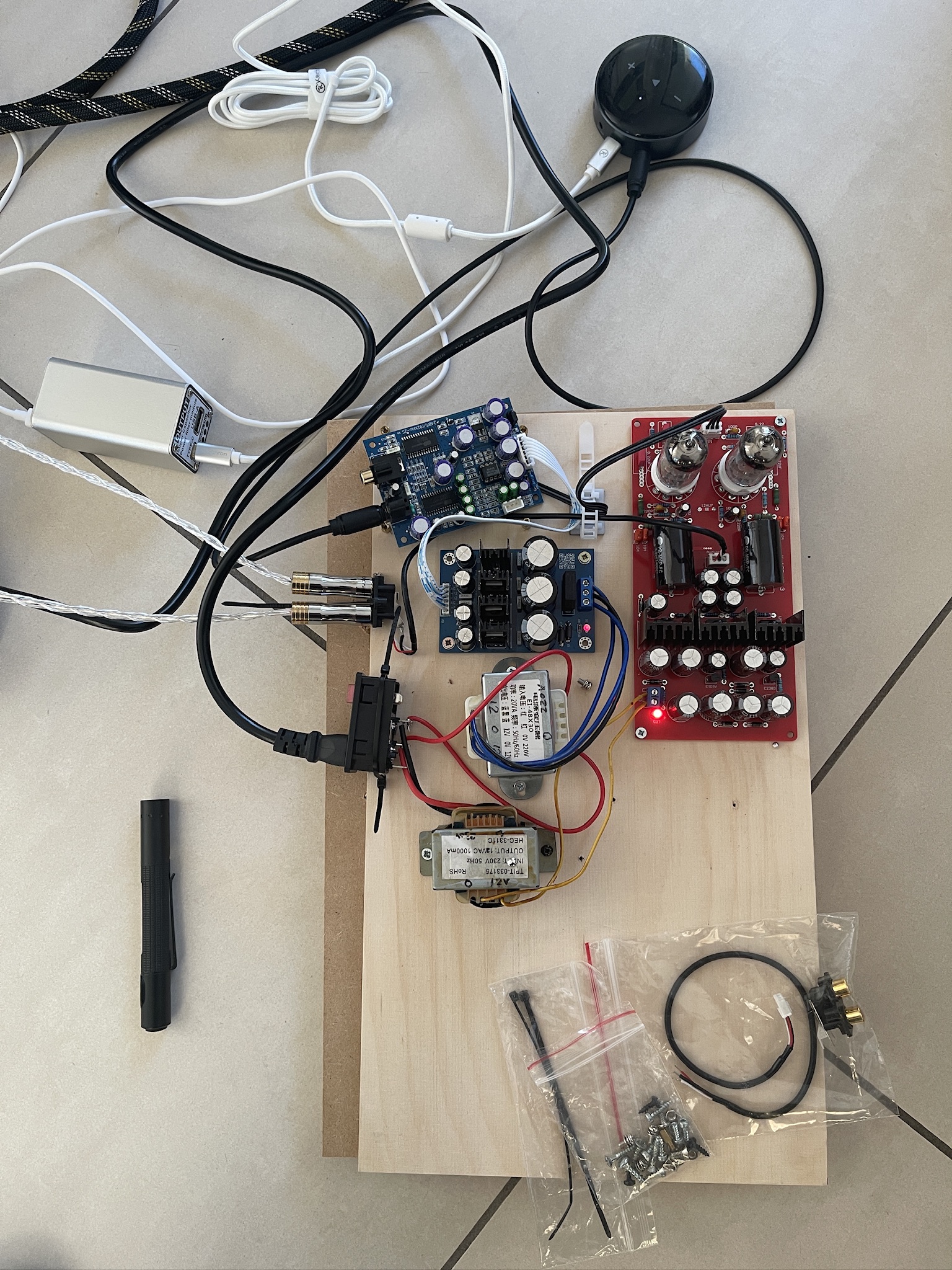

Finally, the time has come: The first components of my new HiFi setup are up and running! With the Lampucera-Lampizator, I was able to gather my first listening impressions today—and what can I say? It already sounds incredibly promising. The combination of these two devices delivers a fascinating level of detail and a soundstage that completely immerses me in the music.
But this is just the beginning! Tomorrow, the DAC will be connected to the F5, and together with the M1, I’m excited to see how the sound signature evolves. I’m particularly curious about how these components will interact with the F5 power amplifier and what new sonic dimensions they might reveal.
In the coming weeks, another exciting step awaits: A better Rr transformer will be added to the setup. I’m hoping for even more precise highs and improved clarity in the midrange. After that, I might experiment with various capacitors—after all, tuning is one of the most thrilling phases of any HiFi project.
I’m looking forward to sharing each step of this journey with you. Stay tuned, as it’s going to be fascinating to see how this setup develops. Have any of you had experience with these components or tested similar combinations? I’m eager to hear your feedback and tips! 😊

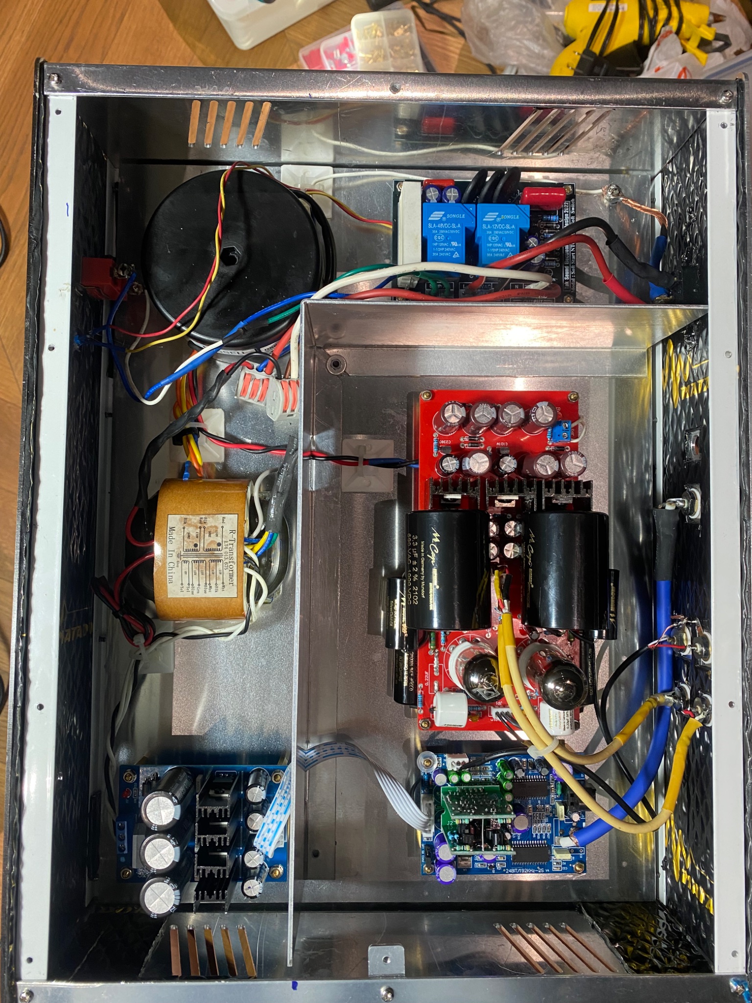

R-transformer installed, and the kit has been moved into a proper enclosure. The sound is excellent, with no noticeable step back compared to the Denafrips Ares II, at least to my ears. Not yet burned in, but the potential is already clear. A very rewarding DIY kit that offers both great performance and the satisfaction of hands-on craftsmanship. Next steps: upgrading to Jantzen Silver caps and switching tubes.
I switched to a Wiim Pro Plus Streamer, feeding the Lampucera DAC with an auth-filter and a super capacitor in the power supply (a LSP) is on its way to me: compared to a MacMini M1 with LSP this sounds already so much better in every way. I will borrow an Ian Canada streamer and will compare...Regarding the front end of your setup: your source does not do this DAC justice at all. For a really good streamer, I can recommend IAN CANADA products (eg Raspberry Pi streamer) with decent reclocker (FifoPi Q7 if you wanna go all the way), then Coax into the Lampucera. It will blow your brains out 😉 check out Gabster:
