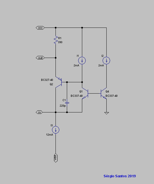

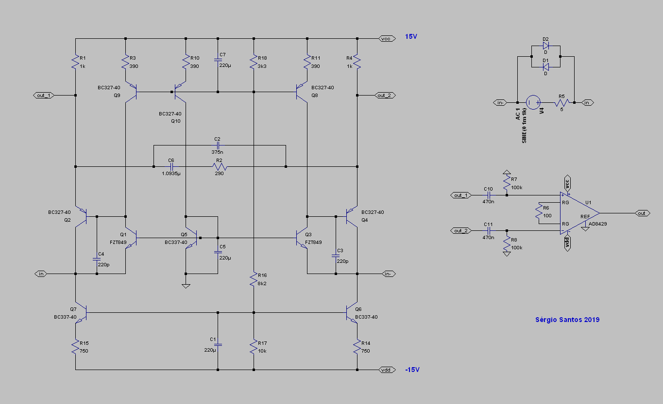

This week I've been thinking about alternatives to my I / V converter, because since I'm going to use 8 channels and balanced connections to the amplifier, that means I'll have to use 16 of these circuits.
A very interesting alternative is to use Jan Didden IV converter with a small change. just added a current source to increase the gain, the results are promising.

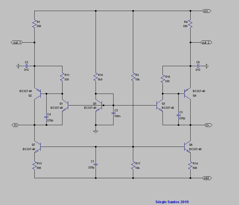

JD IV converter

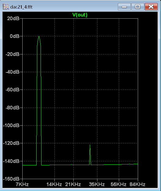

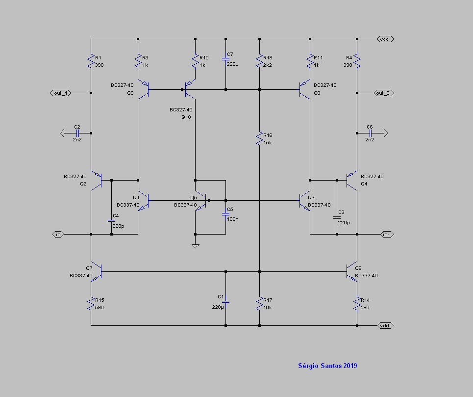

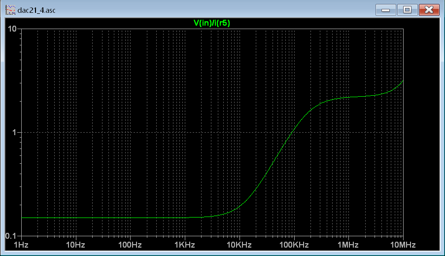

This is the Fully Differential IV converter, it has low input impedance with 0.2 ohms in the audio band and 2ohms at 1Mhz and 3 ohms at 10Mhz.

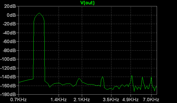

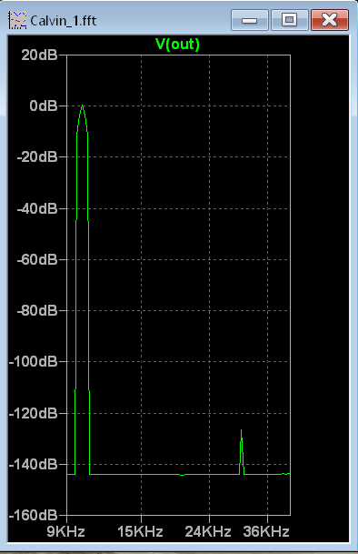

Distortion 10KHz at full output is also very low with only 3th harmonic as the differential nature of the circuit cancels even harmonics.

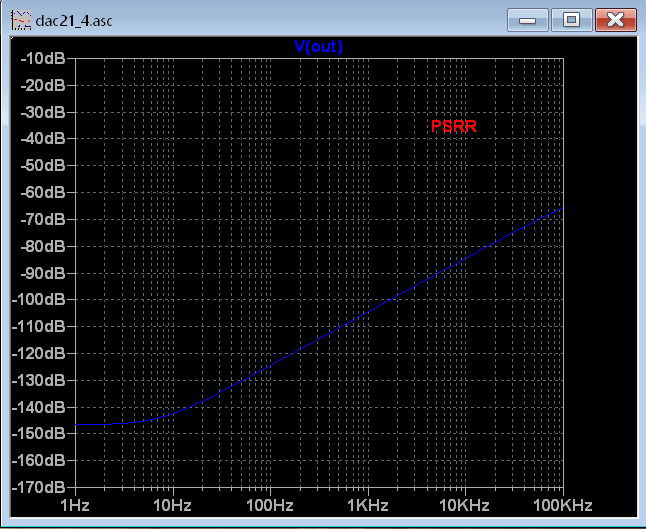

The PSRR is also good, but in reality will be worst than this depending on the tolerance of the components.

Even simpler, similar to Calvin's circuit in # 899

Indeed it's better suited for that as it has no thermal compensation.This could be used as the input of an MC phonostage.

It´s like the ES9018 at full output , I use a voltage source of 1.65Vdc /1.5Vac with 790 Ohms in series resistance

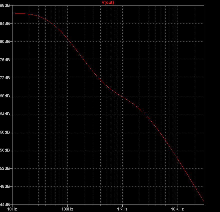

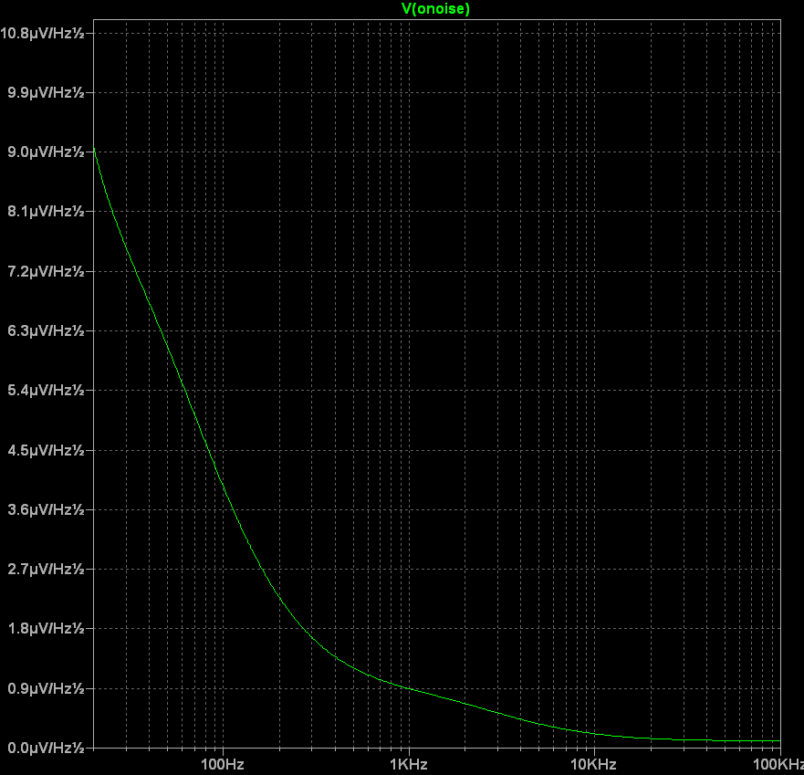

Here's what you asked for.
The calculated input noise with 5 ohms input is 0.36nV/Vhz
The gain at 1kHz is 68db but can be adjust changing R6 value.
The distortion is with a 1mV 1KHz input signal ( 2.5 V output )

WRT all these open loop / local FB / discrete designs, always good to start at 10 or 20kHz, as that is where they usually have problems with non linearities due to modulating capacitances.
But I've seen from your past work, you understand this well and have achieved excellent results.
