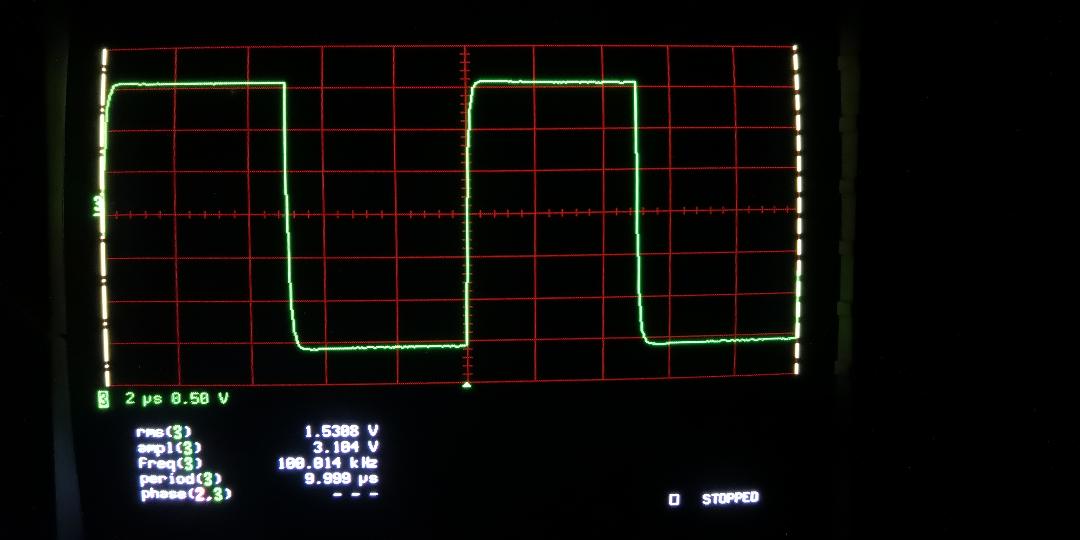

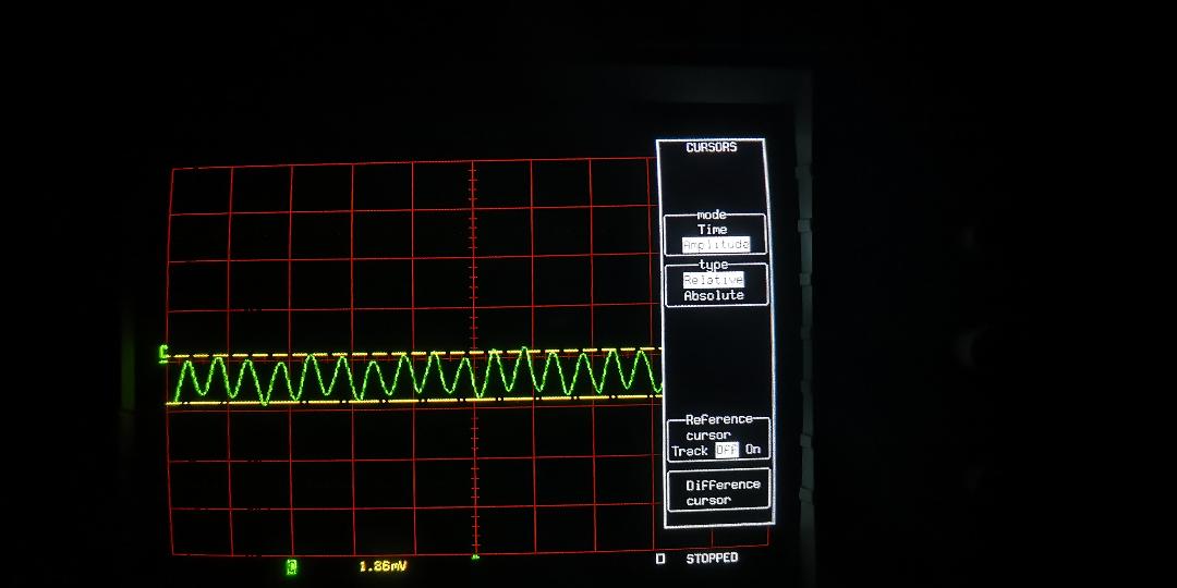

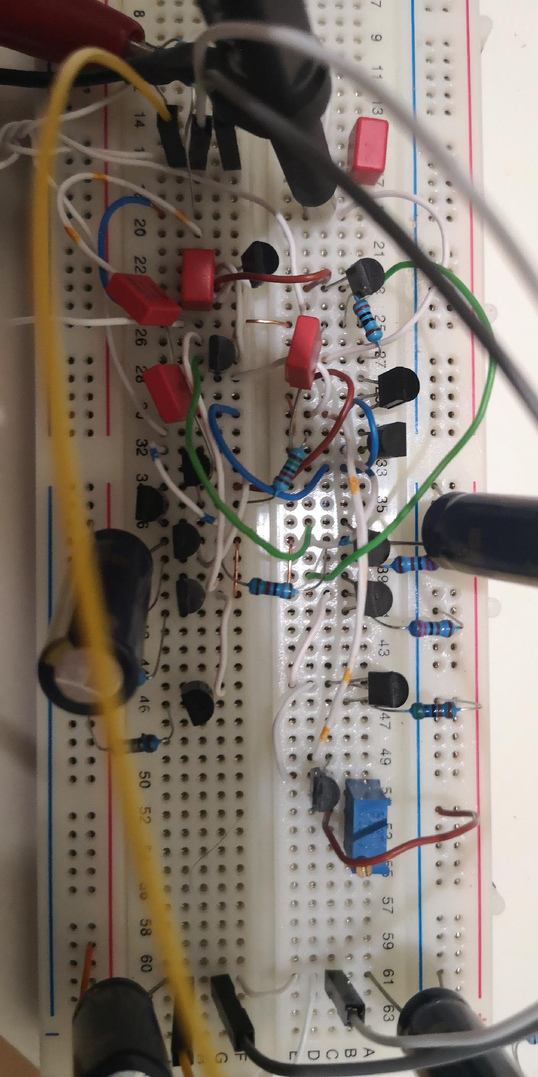

This week I tested the circuit with the input (complementary compound pair), and I am quite happy with the result, the circuit behaved exactly as expected by the ltspice, the input impedance is less than 0.5ohms to 1Mhz (photo2) as provided in ltspice, and should be around 25mohms at 20khz, in photo 2 it is possible to see the voltage at the input with a signal of 4mA pp of 1Mhz.
The third photo is of the output with a square signal of 100Khz, very clean with no signs of over-shoot or riging.
Thanks to Jan.didden for showing me the circuit of Michael Smedegaard, it was very inspiring.

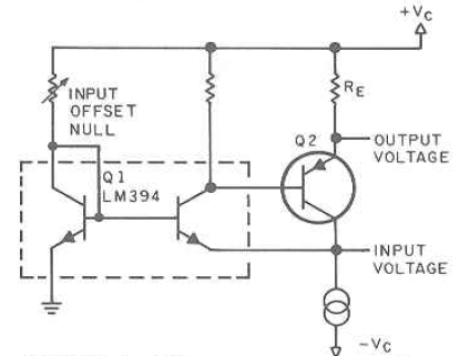

i have a few lm394 and i could pair it with 2sa1038 (ultra low noise high hfe transistor), 2sa992(low noise, high hfe too) or ztx951, much lower hfe...What would be the best combination?Another inspiration (maybe): my own first steps in this area:

would this work well for low iout dac, less than 1ma output current?
I would use a low noise jfet for ccs , but i'm not sure if high transconductance j-fet are stable enough with high current modulation.What would you recommend as current source, a cascode, simpler?
I am not interested in ultra low thd, everything that i usually design is in the ballpark of maximum 90db of LtSpice, which is most probably 75 db in the real life but i don't really want anything higher than that.I am only concerned with stability of operation , low noise and high bandwidth.
Obviously both high Hfe and low noise would be beneficial.
For the current source it is important that it doesn't change too much with temperature. As the offset adjustment is open loop with the trimmer, CCS changes will lead to a change in offset voltage at the current input which you don't want to get too high. For my case that should be less than 10mV for best results, but modern DACs often allow more offset without degradation in linearity, check the data sheet.
Note that the CCS does not see any current modulation (the input current is into the emitter, the CCS is, as its name says, constant current), and also very, very little voltage modulation (the emitter doesn't change more than a few mV due to input current).
