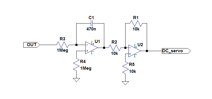

The Dc servo will be one of this, the first is recommended by Bob Cordell and only use 1 capacitor. Can you guys recommend a jfet opamp with good dc precision for this, no need for low noise.

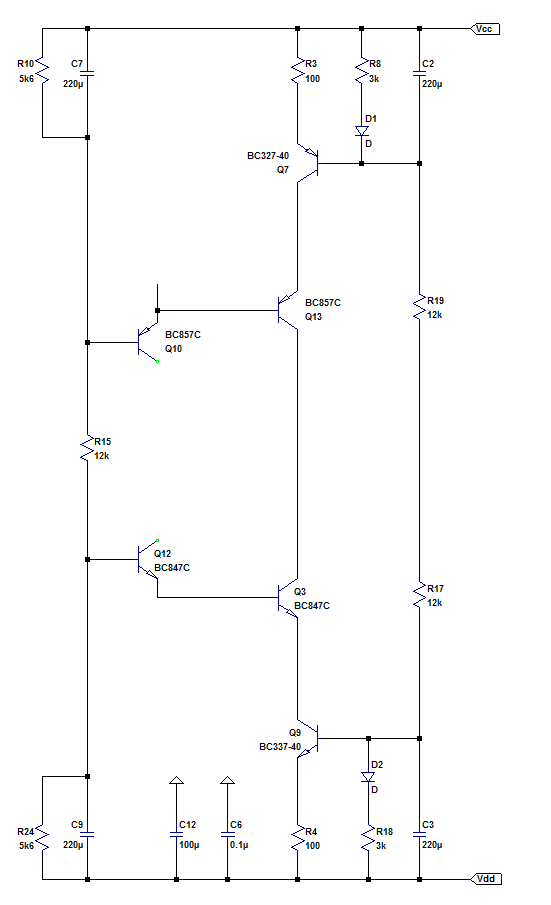

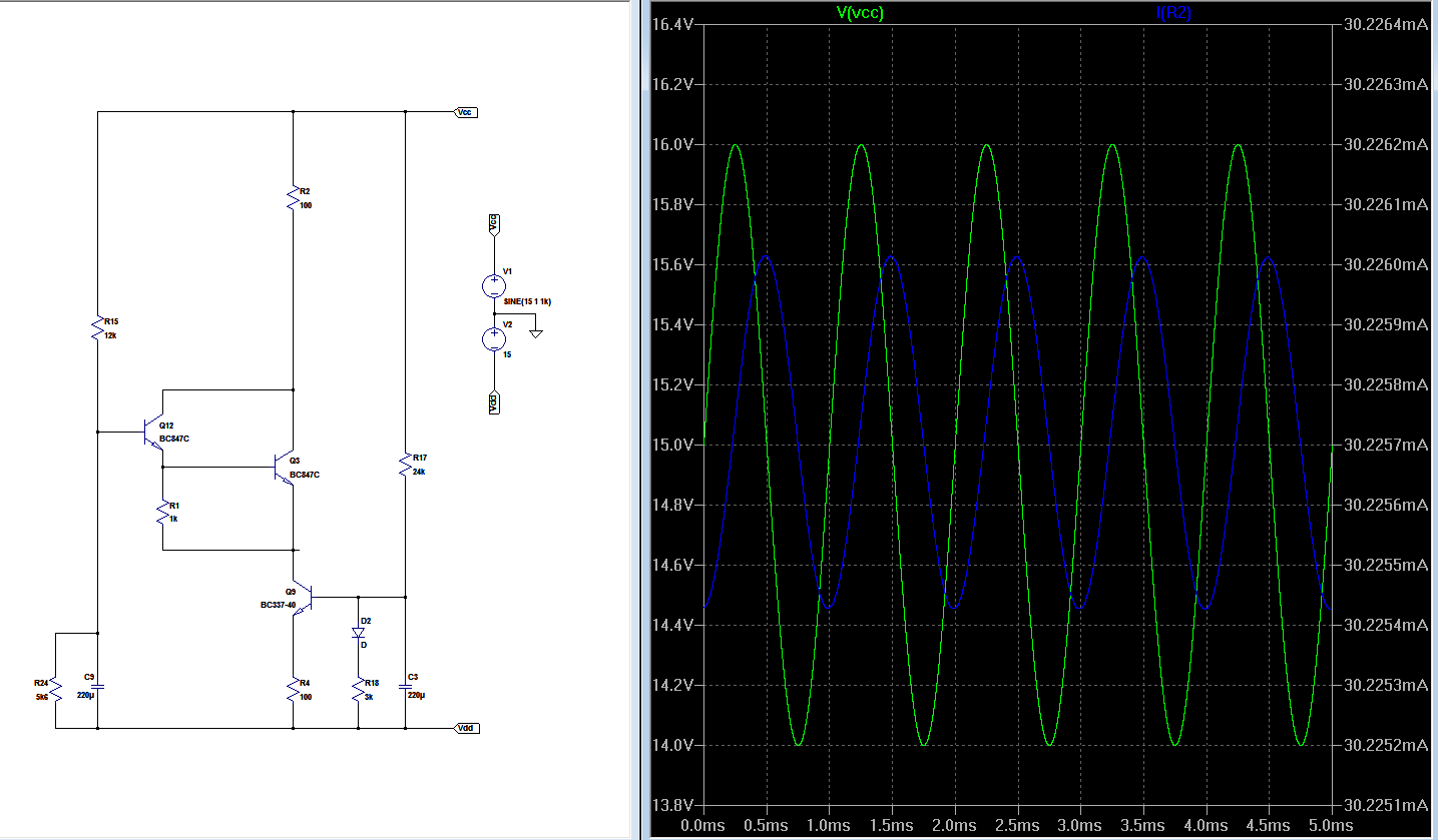

MiiB, this is not really a current mirror, it depends the way you look at the circuit.
In this picture there is a simplified schema of the current source, as one can see i have change the 2 bipolar transistors by 2 diodes because they are connected as a diode and they only serves to temperature stabilization.
the voltage at the base of Q7 and Q9 are stabilized by the capacitors C2 and C3 ,normaly you see zeners or led in the place of resistor R8 or R18, but as long as vcc and vdd dont vary with temperature (use a lm317, 337 in power supply ) there is no need as C2 have much less impedance than any zenner or led.
this ccs is also cascoded so the output impedance is very high. Please trust me, this is a very quiet ccs , the noise floor of the I/V converter is realy very low. i will post pictures of that later on.
TL052 is a good jfet opamp.
tl052 is a possibility. But i will use for now OPA2134, of course others opamp can be use.
I have test the circuit with five OPA2134 , 2 of them give output of 200uV, 2 give less than 100uV and one give 800uV.

A servo should only take care of the last few mV of DC offset for temperature drift and component drift over time. The major DC offset fix should be a trim pot somewhere.
/S

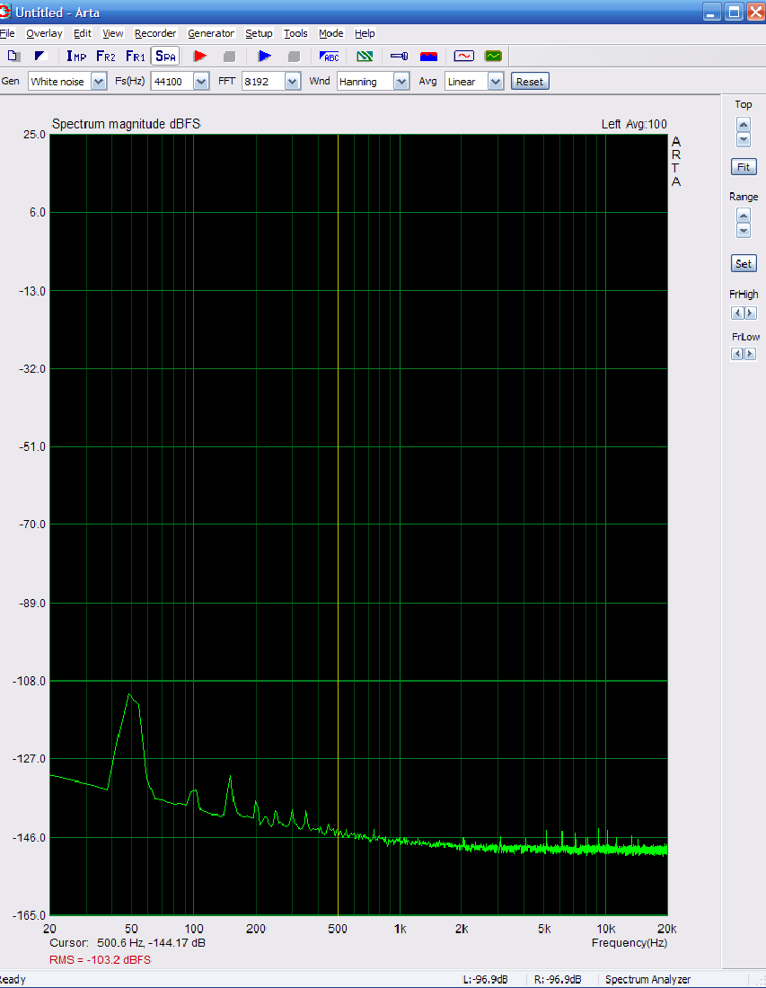

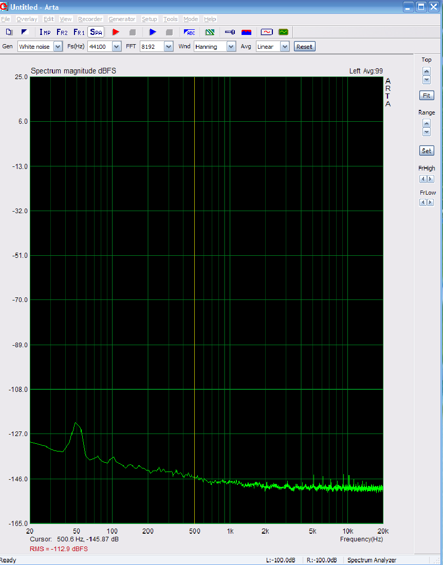

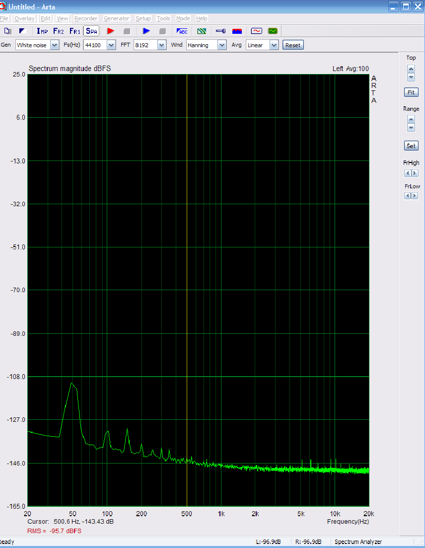

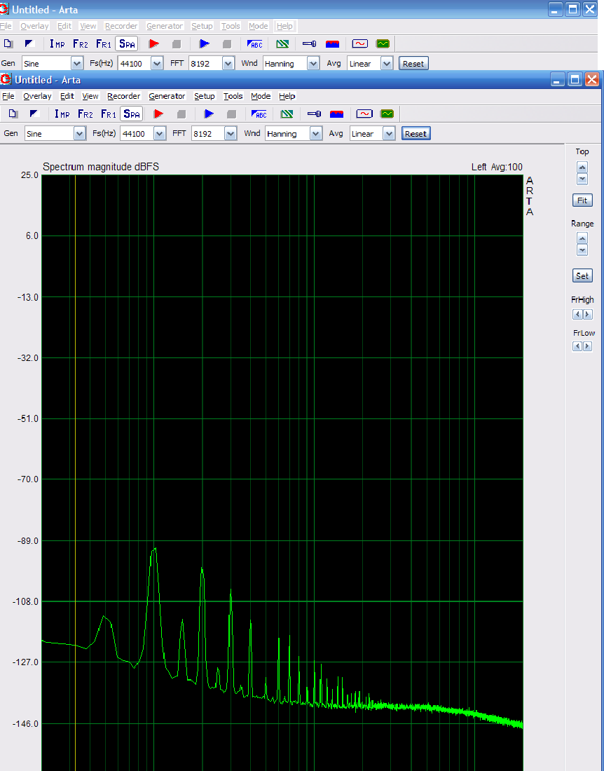

There is no need for a trimmer, the output D.C. voltage of the I/V converter is always the input offset voltage of the servo opamp, i have inbalance the input with 8ma on purpose and the D.C. output stay in the 100uV. i have also made a temperature test, and there was no variation at 50Cº.
The servo that i test is this one, i use a 1Meg in R4 as staccatiss suggested but there is no difference, but i will leave it like that. the next image are the I/V converter noise floor with servo, the second image is without servo, the third is emu1212m alone. The last one is the power supply noise alone.
