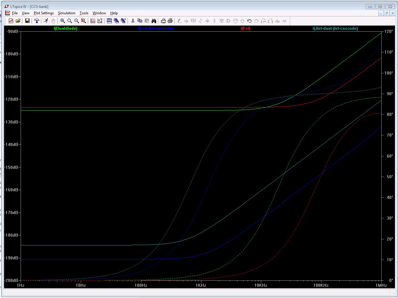

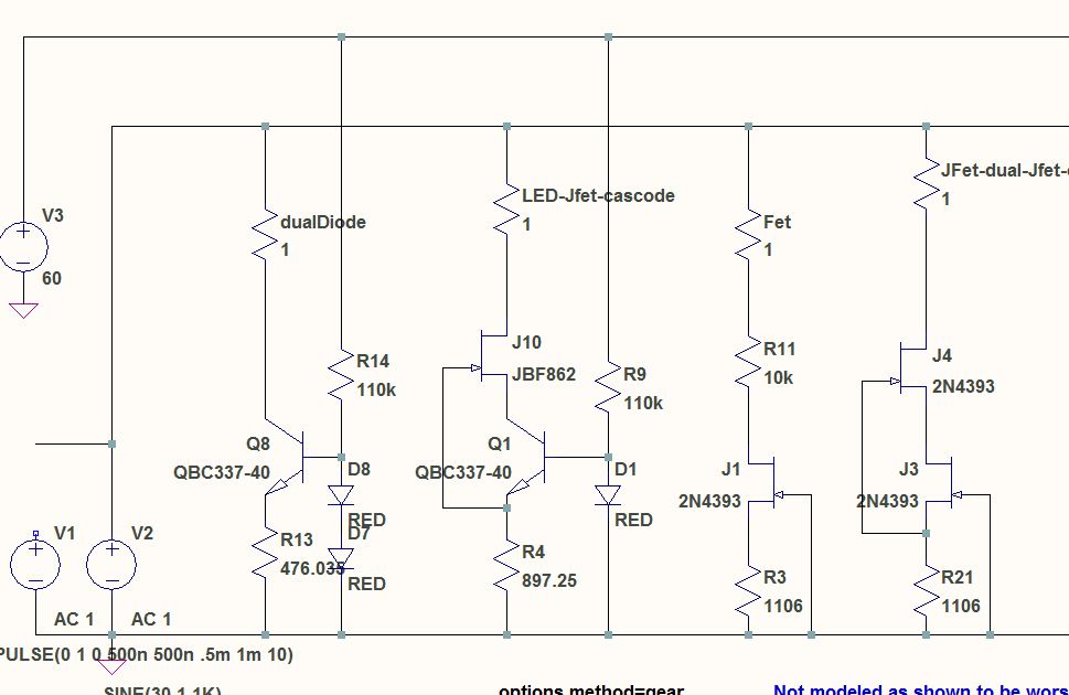

the TL431 has high impedance but starts loosing it after only 1K, but is stiller better at 100KHz than the two other... Can you make one cascoded Jfet... ??
I'll give it a try tomorrow.
Thanks very much for the sims Avro. I was thinking in stabilize in temperature the first Ccs that you post with a transistor connected as a diode in series with the led. The tl431 sims nice but I am afraid that it will be the noisier. And difficult to do a complement.
Have you tried to shunt R15 ?
No difference in doing that. I think that the only thing that we need is to chose the current sources type. Next week I want to have the PCB ready.
You may be right..., however my LT simulator says different.... I wonder if the models aren't sufficient even to calculate CCS impedance.... hmmm So much for for believing that..
In my experience the ltspice do very good simulations with bipolar transistors, very close to reality. But is not very good with jfet, it gives to much gate current leak in every models that I have use, but I don't have investigate the problem further.

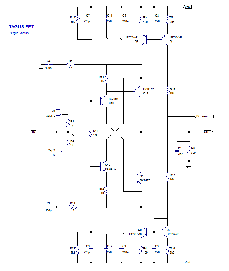

As the pcm1794 has a high output impedance i thought about using the 2sk170/2sj74 pair in the input. I have bought 4 matched pairs from Spencer Cheung, they are not cheap, it cost the equivalent of 1 Kilo gram of BC327 😀 . but i am very curious to try them, and this project seems to be perfect for them. So there it is, the version that I going to build.

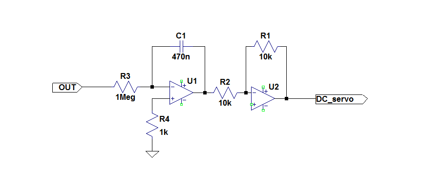

I have found an elegant soluction to connect the dc servo, instead of connecting the servo at the input as usual, the servo will be connected to the input of current sources, any noise that the servo generate will be filtered by C2 and C3 (I have already test this, and work very well). So this I/V converter will not have output capacitor.
In the schema is absent the ccs of 6,2ma for balance the pcm1794 dc_offset.
I will do also a version with BC327/337 transistors in the input. And i am working in a I/V for the ESS9018 .

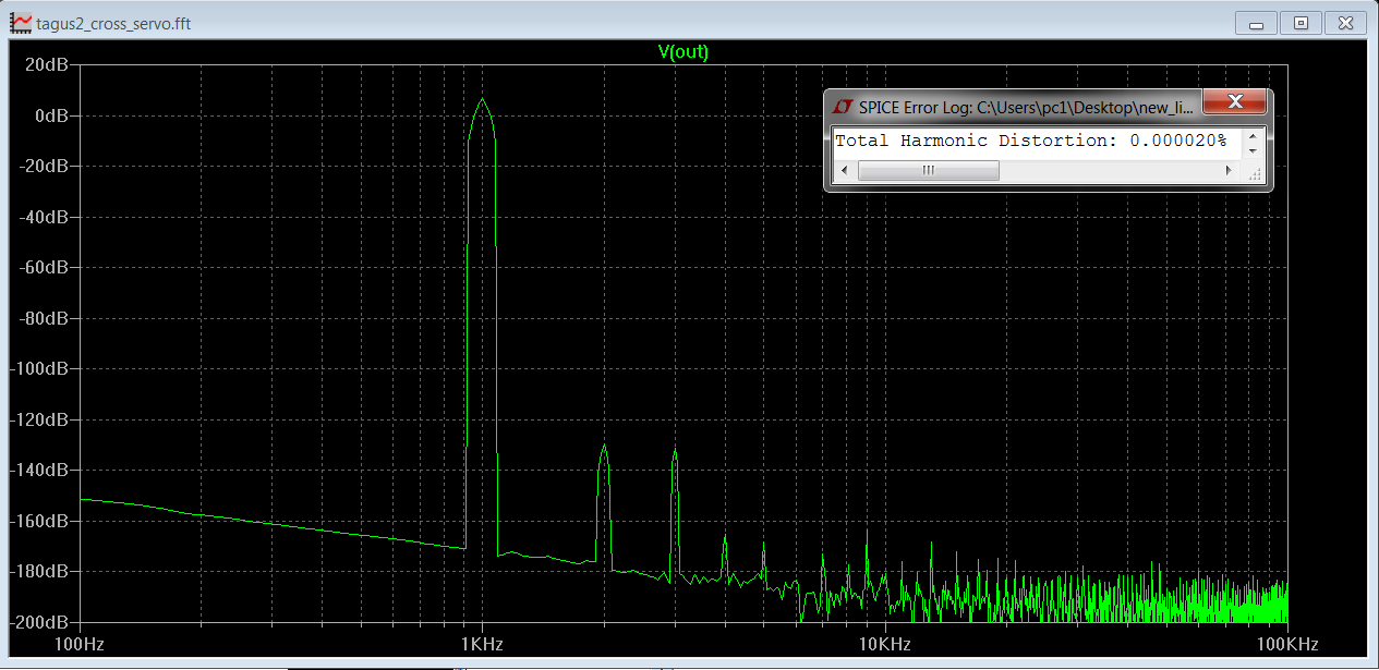

Just for curiosity, the fft of the output with 2Vrms out , 7,8ma p-p.
The impedance of the source is 100k with lower impedance the distortion will be worse. But pcm1794 has a output impedance higher than that, so no problem 😎 .
in the schematic , Q10, Q12, Q13, Q3 will be the BC550c for npn and BC560c for pnp. not bc857c bc847c as this are smd.
edit: This is a ltspice simulation,i will do real measurements when i receive the jfet.

I have more faith in the BJT version.. I have made phono-stages with Jfets, they always sound nice, but also wailed and cloudy compared to the Bjt's

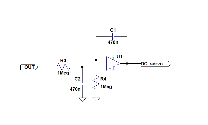

Like your Servo- very much, the same way I designed one in for the paradise phonostage--there we use the OPA134.
I would make a jfet current source instead of the two resistors setting the current. and then insert the servo with two 100 kohm resistors on each side of the CCS.
I would then use the 6.2mA countercurrent to trim the offset to 0 before engaging the servo.
Then you know the servo is just dealing with thermal drift.
I only have experience with the second example (one op amp).
For this I would use OPA211.
The Dc servo will be one of this, the first is recommended by Bob Cordell and only use 1 capacitor. Can you guys recommend a jfet opamp with good dc precision for this, no need for low noise.

OPA211 is a bipolar input opamp , i prefer jfet input.
Miib i also use opa134, but there are others with lower offset voltage.
