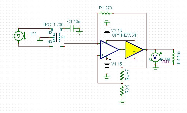

very low distortion. Like zip. too many zeros to count.
maybe you are using an ideal transformer. no distortion
Nope, it is modeled after the Lundahl LL1517. There all kinds of capacitances and winding resistances and core types in the non-linear transformer model I'm using. I've switched to the LME49990 and performance is even better. I'm not going to hijack this thread so I'm not going to talk about this any more. As an amateur, I want certain results, so I will probably build something like this. I don't have a model for the LME49600 buffer, but that's the one I'm going to use (instead of the BUF whatever that's in there). The buffer is required because the feedback network has very low impedance.

What he does is canceling the secondary DC impedance of the transformer. That helps in the bass but not in the treble. That is more complex.

I build the circuit post 414. It works. DC offset at input is still under 10uV. Speed is even a bit higher at 5.5MHz, -3dB. Interestingly gain is the same as before so it is not 6dB higher then a usual balanced input. I am not sure though if the output of my generator is floating.
It could be that the earth lines of my generator and scope are connected.
I will find out when i put it in my system.
When i think about it the 3 Ohm input resistance works like a voltage divider on the 6 Ohm source resistance. That can explain that the gain does not go up. It is a very unusual circuit but very flexible. this is new territory, lets explore it.
I also occurred to me that when this circuit works it is a balanced to unbalanced converter.
That could also simplify the design of a balanced input I/U converter for DA converters.
Common mode performance can be optimized by putting the same phase signal into both inputs and then trim the 3 Ohm resistor. That trimmer can then be substituted with a fixed resistor.

So, I have two designs for an IV converter. One has an input impedance of 3.5 ohms and THD (@1kHz) of 0.00057%. The other has an input impedance of 15 ohms and THD of 0.000058%. For both simulations, I use a current source set to 8mA in parallel with a 2kohm resistor to simulate the output impedance of the PCM1794a. Given that this DAC is designed to work into a virtual ground, would it be better to choose the one with lower input impedance in spite of the 10x higher distortion, or should I go with the one with the lower THD anyway? The noise for both is basically the same. Both have frequency response down to 1Hz at least.
I wish there was a kind of feedback that lowered input impedance. I've heard of feed forward, but I don't know enough about it to say anything.
I should add that the one with the 3.5 ohm input impedance is made from discrete parts, so that in real life it's likely to be worse (possibly much worse) than in simulation, whereas the one with the 15 ohm input impedance is made from chips that are more likely to be closer to the sim in real life.

I read through it quickly. I still like my solution the best (with an input transformer) but I suppose it's possible that the DAC will interact badly with my circuit. Right now, it's unknown, but I'm gathering the test gear I need to actually figure this out. This will take time and money. I do note that he said the IV converter stage should have an input impedance of less than 5 ohms, though the CEN and SEN seem to have higher and work OK. I did order two Lundahl transformers yesterday. One step at a time.
