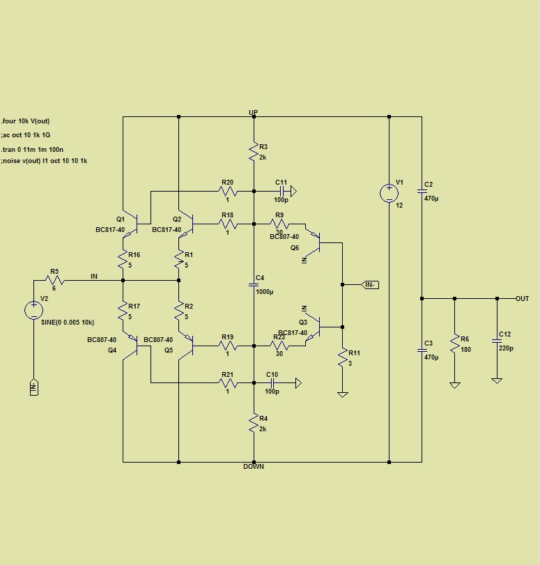

This is the idle per transistor so the input stage draws ca. 32mA in total.
The simulation of your circuit gives 8ma for each at 12v. the values for resistances you post is the ones that you use?
Yes, i reduced the 5kOhm to 2kOhm.

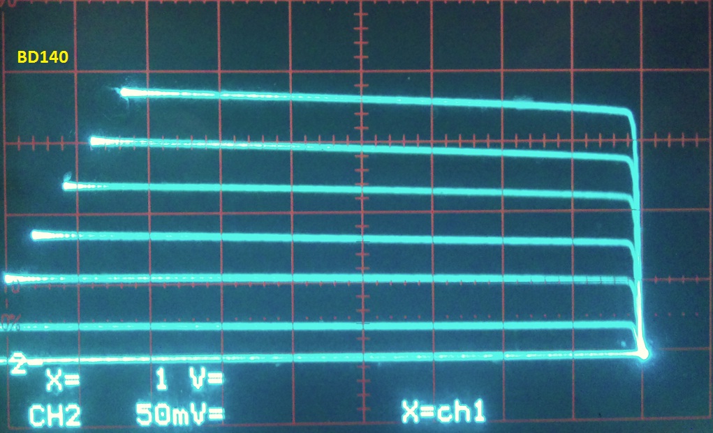

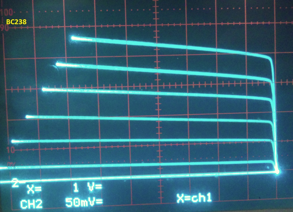

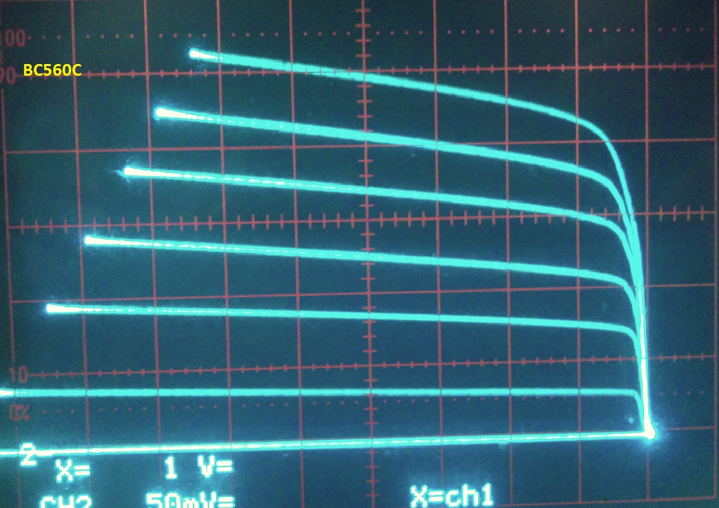

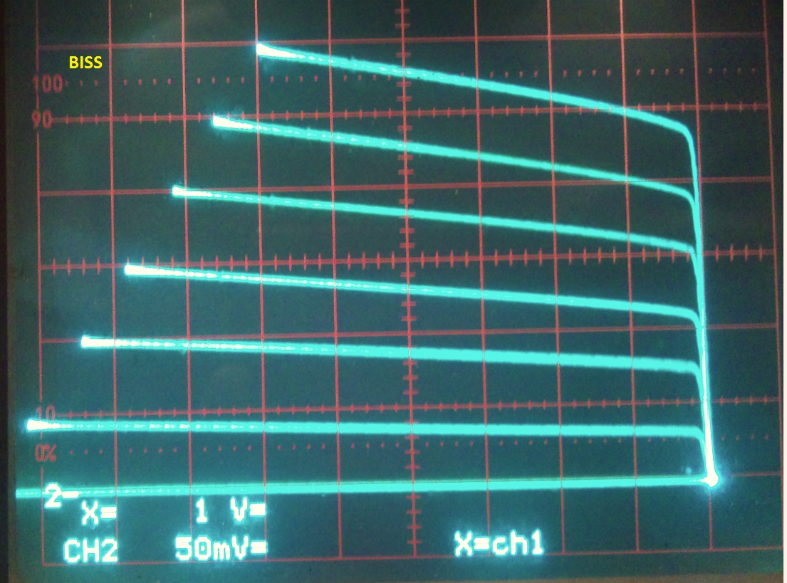

some pnp transistors curves.
The BD140 have the best curves, but the gais is lower than the rest.
The biss transistor (0,5 Amp) have the better Hfe.
The BC328 is from a old stock.
the bc337-40 that i test have the same gain as bc550c , i test 5 of them and the hfe was similar.
The npn transistor all have better curves than pnp, the bd140 and bd139 are the ones with the most similar curves.
the BD140 and bBC328 where test with 50uA Ib steps the biss and bc560c with 10uA
the scales are horizontal 1 volt/cm Vertical 5mA /cm

The BD140 looks really good.
What could also work well is the KSC3503 / KSA1381 combination.
2SC3601 / 2SA1407 is even better. Very fast and Rbee`in the 2 Ohm region.

I think the old BD140 and BD139 are very linear and truly complementar.
And i bet the Rbb are also low.

I measured the voltages again. Now ca.90mV ( plus-minus 2mV ) develop over each 5.1 Ohm emitter resistor and 30 ohm base stopper. The voltages of the version with the collectors on the input shows even more similar values on all resistors as before.
The idle current is about two times higher as in the simulation you did.
By the way 5.57V develop over the positive 2kOhm resistor and 5.67V over the negative.

Should i change the idle or use other resistor values with the BD´s ?
I think you will be fine with the same values

Well, I guess you can call it push pull, since in order to be really balanced the impedance of each side has to be equal to ground. But, that's ok, it'll probably work good. Only one way to find out!
When I did it, I used an input transformer, but I guess that's considered cheating these days.
One thing that could work, is use a dummy coil similar to the MC coil in parallel, and then run the cables close to the cables of the MC head and connect to the IN- input, the noise pick by the coils and cables are in phase and is canceled by the circuit.
Maybe a moving coil head amp would be a good application for a zero field input transformer arrangement?
http://www.lundahl.se/pdf/7101.pdf
Delete R1 and R2 and you have basically a zero input impedance, balanced! (I know that doesn't make sense... hahaha)
