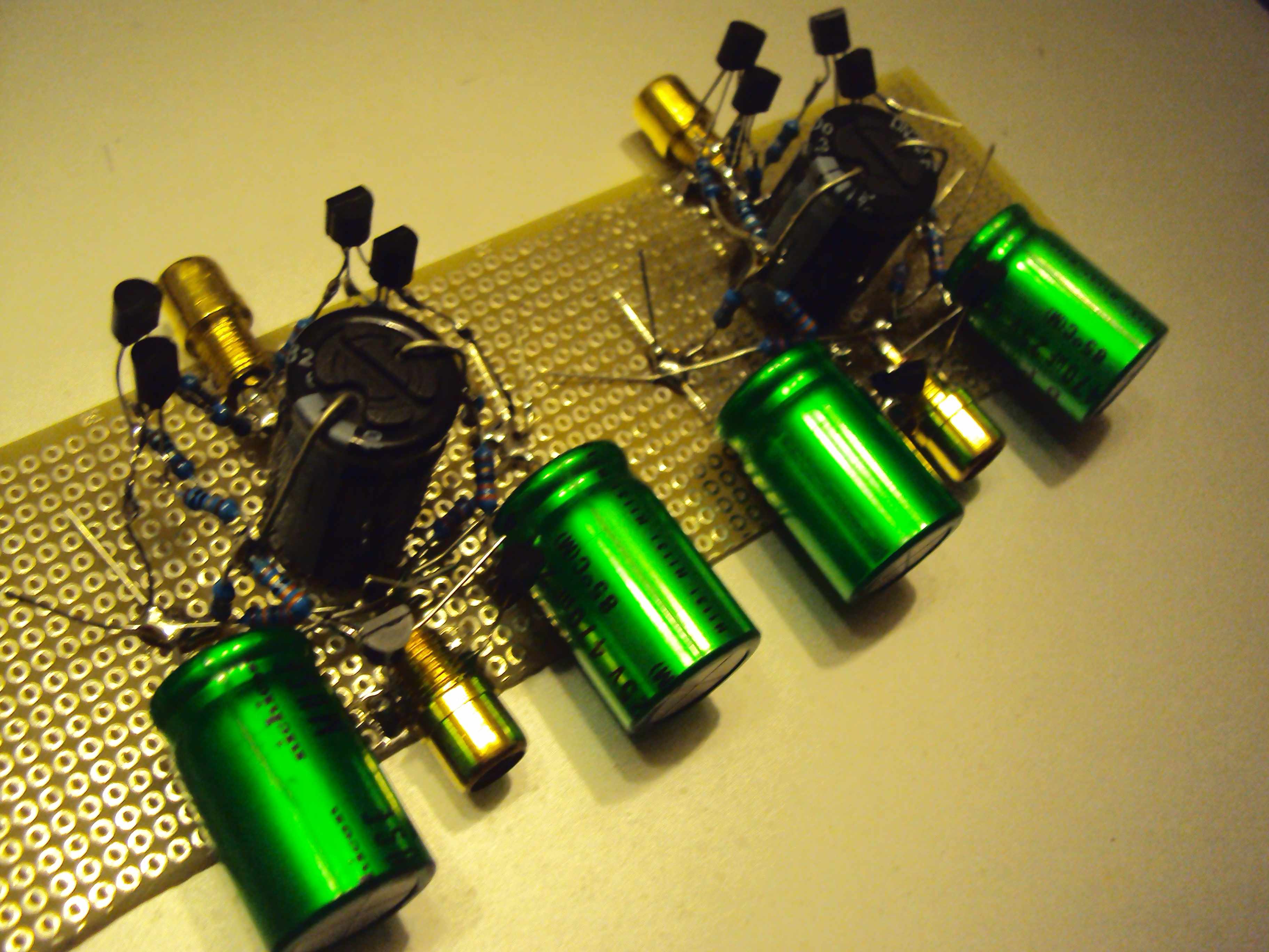

Something practical. LowDist I/V MC nearly ready.

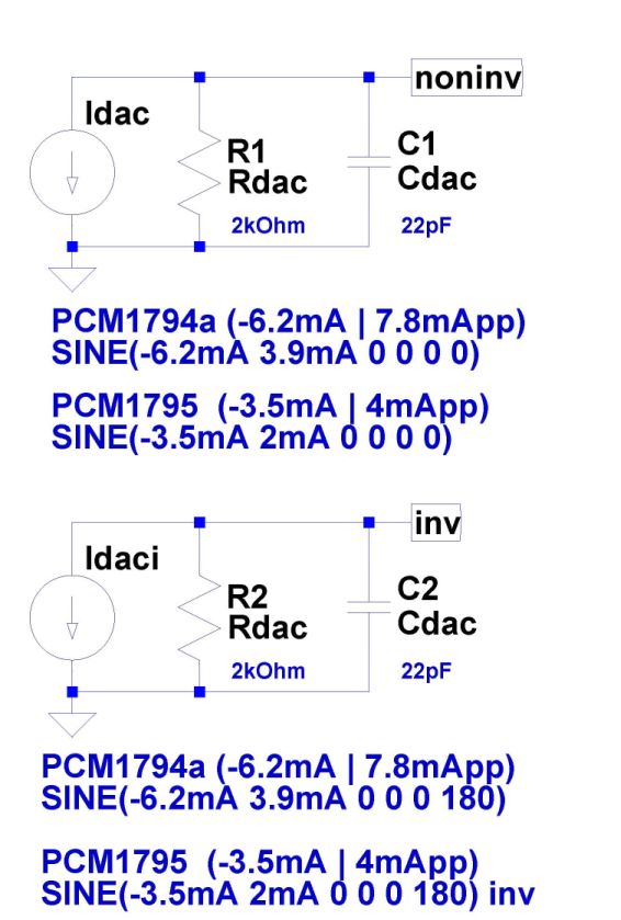

Correct, each ouput pin is never more than 3.9mA from the quiescent point. So, the pk-pk current output from EACH PIN can never be more than 7.8mA. I think confusion may stem from the fact that, indeed, no single pin can output 15.6mA. However, the pk-pk differential net CHANGE in current between pins is equal to 15.6mA. These currents are anti-phase, so you won't ever measure an in-phase 15.6mA from the output pins. If you look at the 'X' chart on post #155, you can see that the current difference between IoutP and IoutN swings from 7.8mA peak at one polarity, through BPZ where the 'X' arms cross, to 7.8mA peak at the opposite polarity. That's a peak-peak difference of 15.6mA.
Think of that 15.6mA net change in terms of the voltage a differential I/V stage would produce. If the I/V resistor were 1k, then IoutP by itself can produce a signal voltage of 1k x 7.8mApp(+/- 3.9mA) = 7.8Vpp. However, the outputs are differential, so we have IoutN to account for. IoutN by itself can also produce a signal voltage of 1k x 7.8mApp = 7.8Vpp. If fed anti-phase inputs from IoutP and IoutN both, a differential I/V will then produce a signal voltage of 2 x 7.8Vpp = 15.6Vpp. Which means that 15.6Vpp / 1K = 15.6mApp current is conducted through the I/V resistor.
So, are you saying that we should use 15.6mA for the current generator in our simulations when it is connected in differential mode as shown for example in the attached figure?

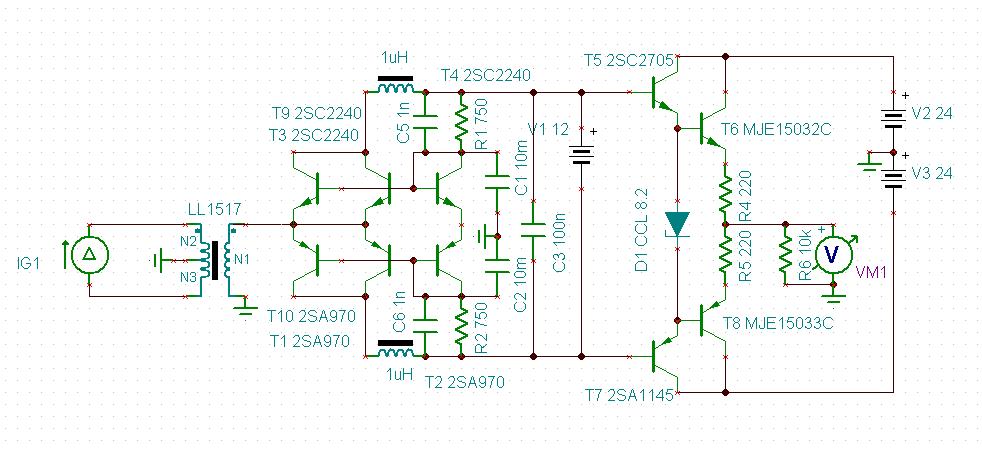

An issue with using DAC chips such as the AD1955 or AD1853 with a grounded-base I/V circuit is that the differential current output pins on these DACs want to see a common-mode input voltage that's offset above D.C. ground. For those ADI DACs, the figure is near +2.8VDC. The PCM179x series, on the other hand, wants to see a common-mode input voltage that's at D.C. ground. This issue can be addressed by level shifting the grounded-base input bias reference level from ground to the required D.C. offset, with a resistor biasing network and A.C. ground coupling capacitors.
How the simulators handles differential signal source generator modeling might make giving an simple answer problematic. The most clear advice I can think of is to use whichever of the two current values for the source gen. which produces a 7.8mA peak and 15.6mA peak-peak signal current swing through the I/V resistor of the I/V stage being simulated - assuming, of course, that both output phase currents are being differentially utilized.
One other point. When modeling a two-terminal differential signal source you should set the internal source impedance equal to twice that of a single DAC output pin impedance. For example, if the impedance of a signle DAC output pin were 1K, then set the modeled generator internal impedance to 2K. That is because the DAC differential outputs are effectively in series with each other with respect to a common, differentially driven load. Which means their individual output impedances are also in series, again with respect to a common, differentially driven load.
An increased source impedance has beneficial THD implications for the I/V stage. Although, the doubling of the signal current magnitude then degrades the I/V stage THD.
OK, thanks.
The outputs from the current generator in the image I posted above are 180 degrees out of phase and half the value of the generator, so it appears to be functioning as a differential current source. I've done this with the voltage generator in other circuits in Tina also with the same effect.
(edit: whoops, made a mistake. Setting the current generator to 7.8mA produces that amount on BOTH pins of the generator, not half like I thought)
in Mono mode the DACs currents just double to -12.4mA | +-7.8mApp for the PCM1794a, or -7mA | +-4mApp for the PCM1795.
Now the outputs of L+ and R- must be connected together as noninv current summing point. Same applies L- and R+ for the inv sum. The DAC must be set to mono mode and the appropriate channel Left or Right selected via setting of Pin1 and Pin2 of the Chip.
As mentioned before low THD requires that the signal current stroke remains small against the current conveying transistor´s bias current. As such a PCM1795 in Mono mode has similar current values and this results in similar IV-distortion figures as a PCM1794a in stereo mode. On the other hand will a PCM1794a in mono mode lead to increased THD of the IV-stage.
Higher DAC output currents are not neccessarily a improvement.
If for example one bypasses the digital filter section of the DAC chips a PCM1795 in Mono mode may be better than a PCM1794a in stereo mode.

Good circuit 🙂
I have built quite a few circuits based on these principles using mirrors to
sum the +and- phases then that current modulating cascoded OP stage.
DAC's , front ends of open loop SS power amplifiers and even a mic pre that
have a bal IP and SE OP (fully complimentary).
I have also implemented the same type of OP stage with those cross
coupled darlingtons. They do work very well to linearise non linear base currents and capacitances.
It's really a design twist of the 'Baxandall pair' connected BJT's, using the
'error' current from the bases of the main OP BJT's as + feedback. Your sim
numbers tell the story.
It all works just like it should in real life too with one gotcha - stability.
You may or may not have stability issues. It depends on layout etc. C1 will
certainly help but you may need additional base stoppers in either the main
OP BJT's or the 'helpers'.
Once you get the whole thing on a board and prototyped, it really is worth
having a good listen with and without all the Baxandall collector connections
to up/down labelled points. With these connected, the distortion will
certainly measure a lot better, however it may not actually sound better.
IME, with all these small + feedback loops, the sound can be worse. Without
them it is often more natural, but you won't get the super low dist numbers.
I'll be interested if you have similar results with this design. Keep us posted.
BTW, your choice of 327 / 337 in most locations is a pretty good one for 2
reasons - who can guess what they are?

the current mirror reminds of an ´full Wilson´. See for example sboa046 "IMPLEMENTATION AND APPLICATIONS OF CURRENT SOURCES AND CURRENT RECEIVERS" of TI/BB.
A ´complementary full Wilson´ is the Zetex part ZDS1009 in SM-8 casing, which might be a possible replacement part for the discrete BC327/337, because of the matching issues/oscillation issues of these cascoded current mirrors.
Well You can of course imbalance the whole stage by increasing the lower ccs bias current, but what´s the deal in designing a symmetrical stage just to spoil its symmetry right away to accommodate for the DAC? Yes, a dedicated CCS would mean more complexity and a slight noise penalty. But a simple JFET ccs is the simplest and the least noisy ccs You can have here, just two parts, a JFET and an R. Noise figures will be slightly higher (1-2dB), but still be well below -110dBV.
In the case of a current sourcing DAC with an offset current a SE-circuit, basically using just the upper half and a ccs towards the negative supply, would be more elegant and less complex.
I agree with Terry, that the multiple loops and cascoded mirrors may give stability problems and may sonically not be as overwhelming as the distortion figures imply (which have yet to be proofed in reality).
In my tests a simple SE-grounded base stage (rem. "Jocko" or SEN) certainly sounded better than a similar, but more complex and lower THD Hawksford current steering I/V stage.

Thanks for the tip about ZDS1009 and the interesting literature about current mirrors , i will see if i arrange time to read it.
In the last circuit i have post the distortion is smaler with the -6.2ma off ofset that without them.
about the stability, i have talk about that in my last post, and the final circuit will not have stability problems.
I have been posting the evolution of this project, i start to doubt if this is the best thing to do in this forum, but ok.
the idea of using a small current output dac as pcm1795/96 is a very good one, i will see the datasheet on this dac.
The input snuber will have very low interaction in the audio frequency, and is not a burden for the dac.
