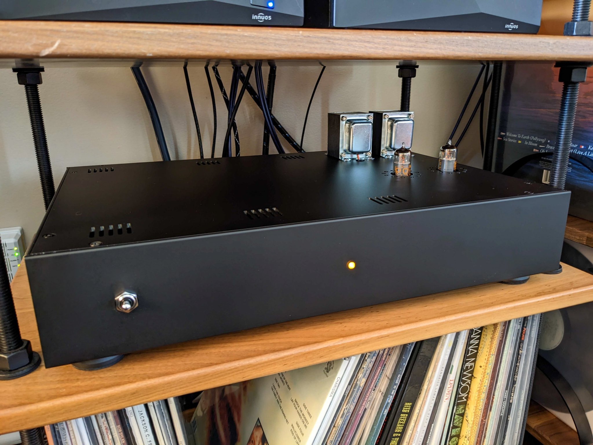

Very nice but in the same time very impractical because the tube are exposed and can be accidentally broken and on top of the DAC box you can't put anything. For example the power amplifier is recommended to be on top for better cooling.
My guy, that is what audio racks are for! If I was concerned about practicality, I wouldn't build with tubes at all 🙂

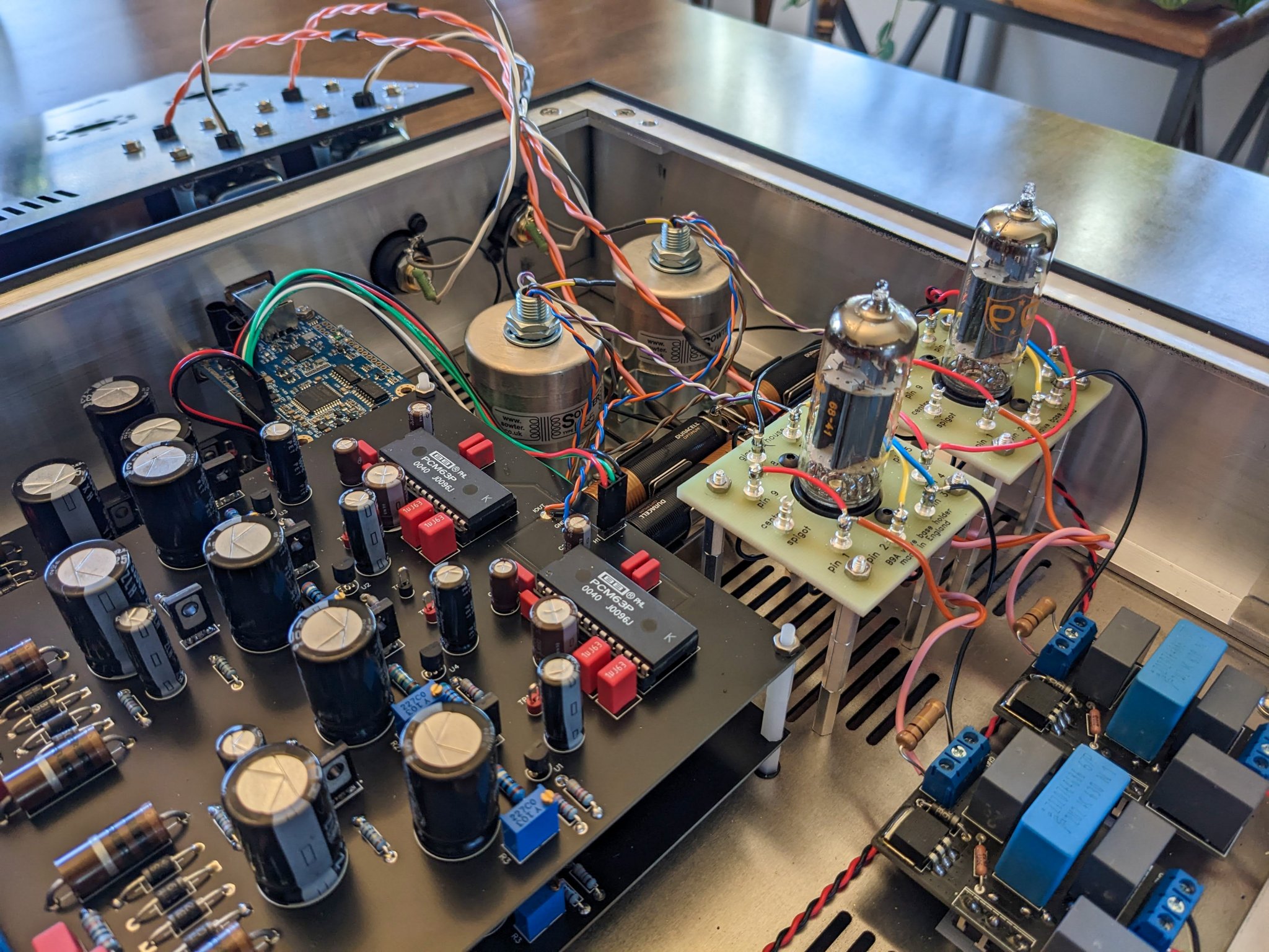

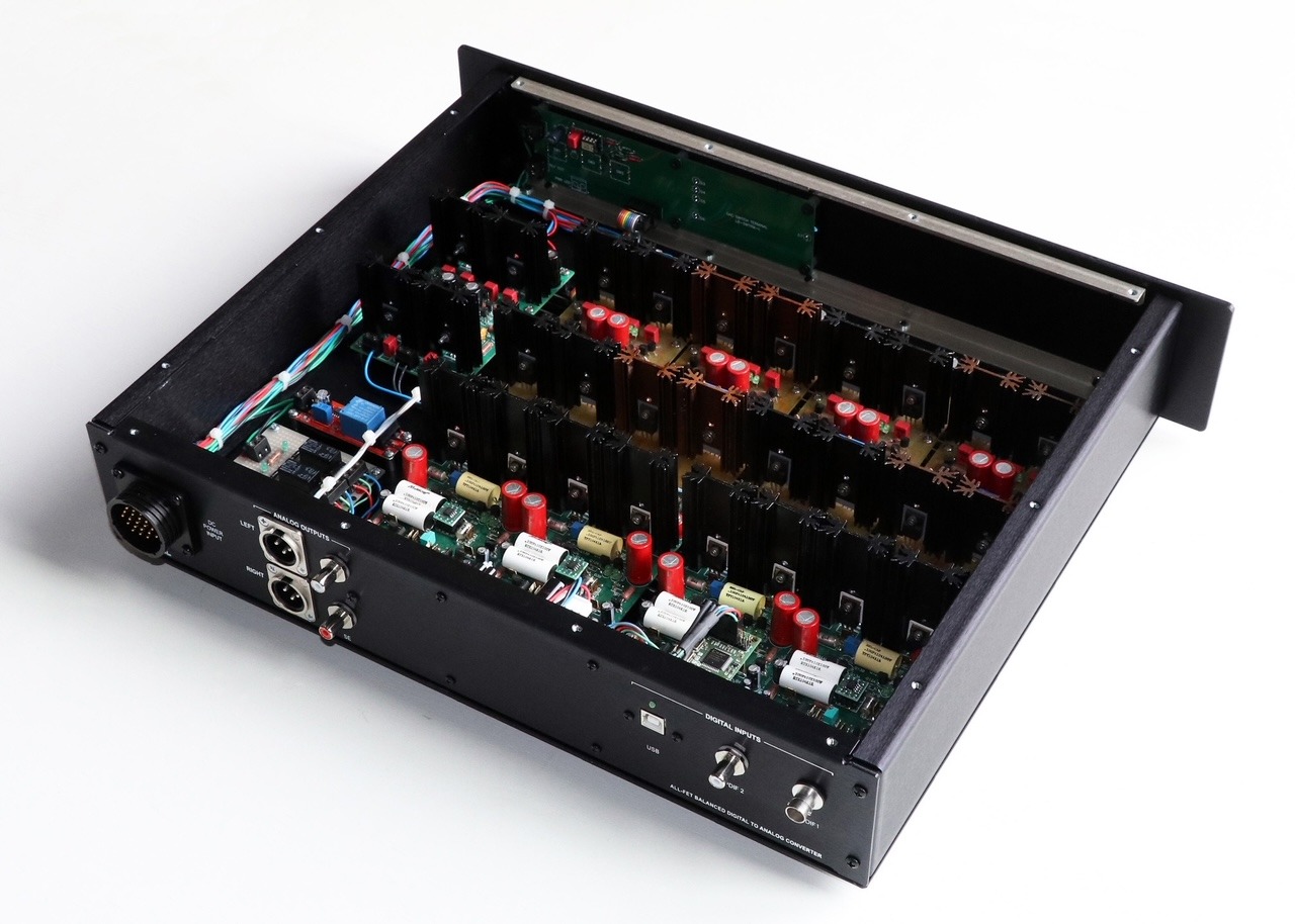

pair of PCM63 in parallel per channel, NOS design. I/V conversion done by Sowter 1465 SUTs, coupled to a E182CC / 7044 / 5687 tube gain stage, battery biased, and loaded by Sowter 9705 line output transformers. B+ supply is Maida regulated,
Nice build. How does it sound?

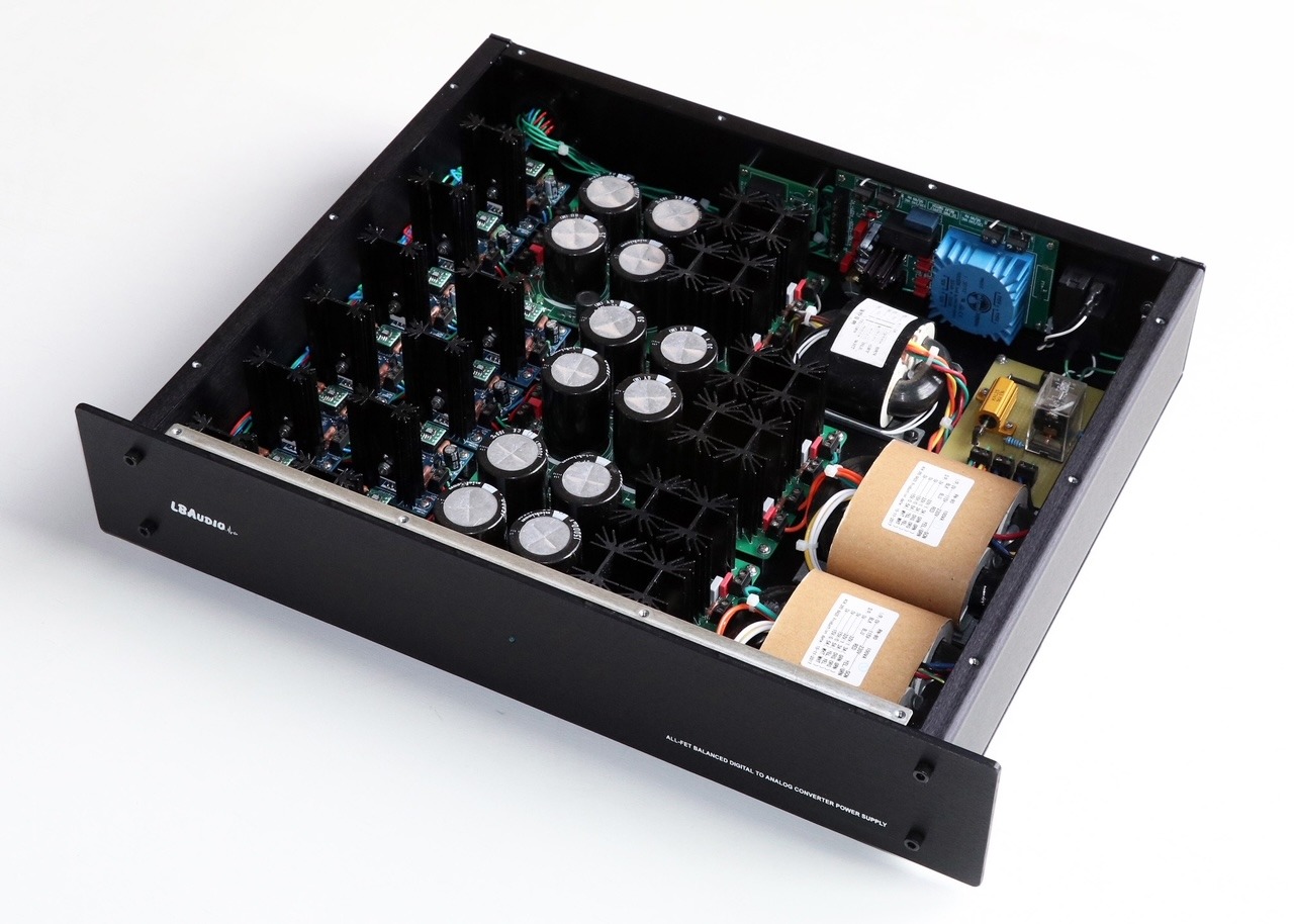

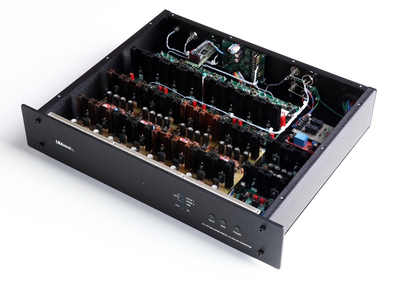

I sourced the parts and built the boards and Les Bordeleon did the chassis and assembly

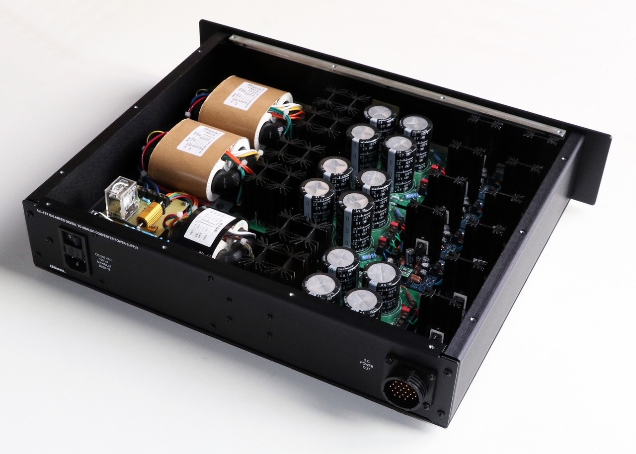

2 chassis - dac and power supply
AC soft start
8 x 1704 K grade multiplexed for 192/24 fully balanced
3 x 100w R core
3 x diy audio CRC power supply boards with IR hexfet - Quasimodo CRC snubbed
200,000uf filter caps
10 Jung super regulators as pre regulators
10 Borbely super Shunt regulators 389/109 jfets and 2013/313 fets
Borbely jfet/ Fet 80 ma bias current Class A single stage IV/output buffer 389/109 and 2013/313
Blackgate electrolytics
Relcap teflon and polystyrene caps
Texas Components TX 2575 signal path resistors
Silver wire
It sounds great, extremely lifelike, airy and spacious with tactile bass. It's the best digital source component I've owned, head and shoulders above my first PCM56 design as well as my Audial S5 NOS DAC.
Please, can I ask you about your design decisions in this fine build?
1. PCM63 in parallel per channel Q: why x2 PCM63? Twice the cost for what? Maybe 3dB SNR? Seems redundant?
2. I/V conversion done by Sowter 1465 SUT. Q: why use a trannie for IV?
3. Battery biased Q: are the batteries rechargeable?
4. B+ supply is Maida regulated, one per channel. Q: why SS B+.?? How does SS sound? They are pricey – could one do both channels?
5. Heaters are also DC regulated. Q: Coleman regs?
Thanks 🙂
1. I picked up four of these chips together about a year ago, as such I wanted to use all four in a single design. I considered a balanced design, but decided to go parallel. Half the I/V secondary resistance is needed for a given output voltage with two chips in parallel, which will improve performance. There is also a theoretical averaging/error correction of the R2R resistors with two chips in parallel. Also just subjective testimonials of running two chips in parallel, I wanted to try. Cost was not a concern for this project.
2. Sowter SUT I/V was recommended to me by a fellow DIYer, I used it in a previous build and was happy with the result. Relative to other passive I/V (i.e., resistor), it provides voltage gain, allows for a lower reflected impedance to the DAC output, and provides low pass filtering.
3. In class A1, tube grids will draw no current, the batteries are not drained, they need to be changed at the shelf life of the battery. For AA, that is ten years.
4. The regulators I used are a friend's design, they are very high performing, I've used them in multiple designs, they are not expensive. I used two regulators for better decoupling between L and R channels
5. Not Coleman regs, these are not directly-heated triodes. DC heater regulator is my design, purpose is to avoid coupling of 60Hz noise into the output stage.

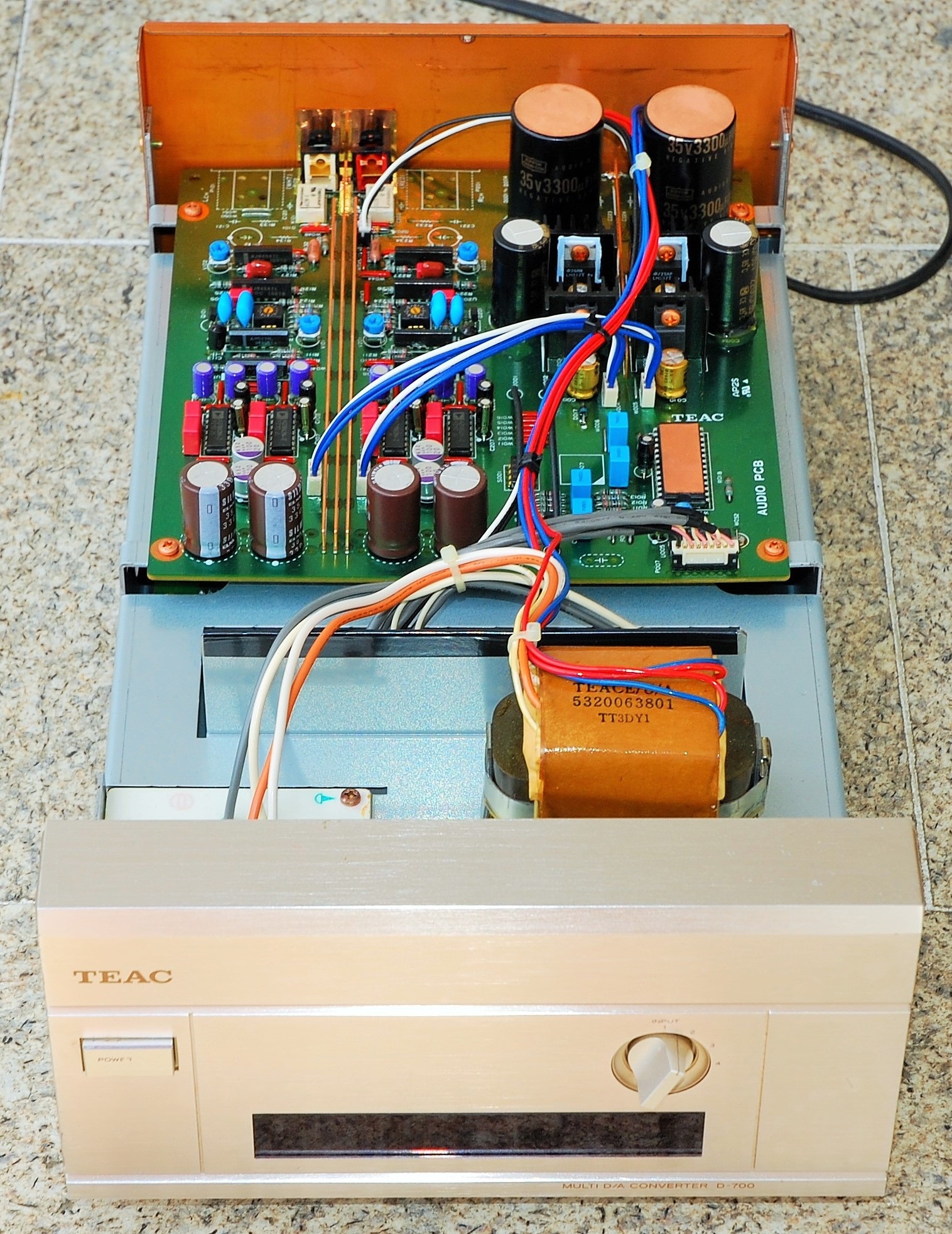

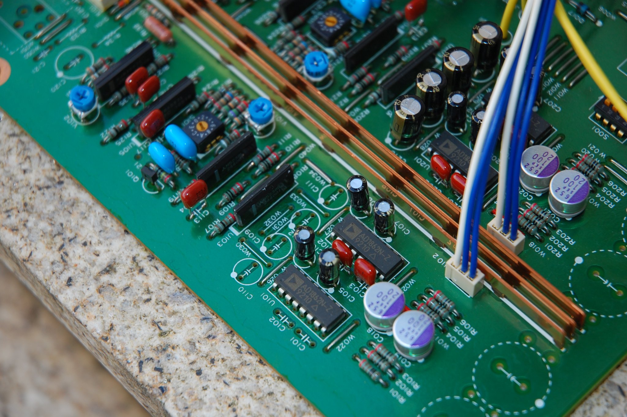

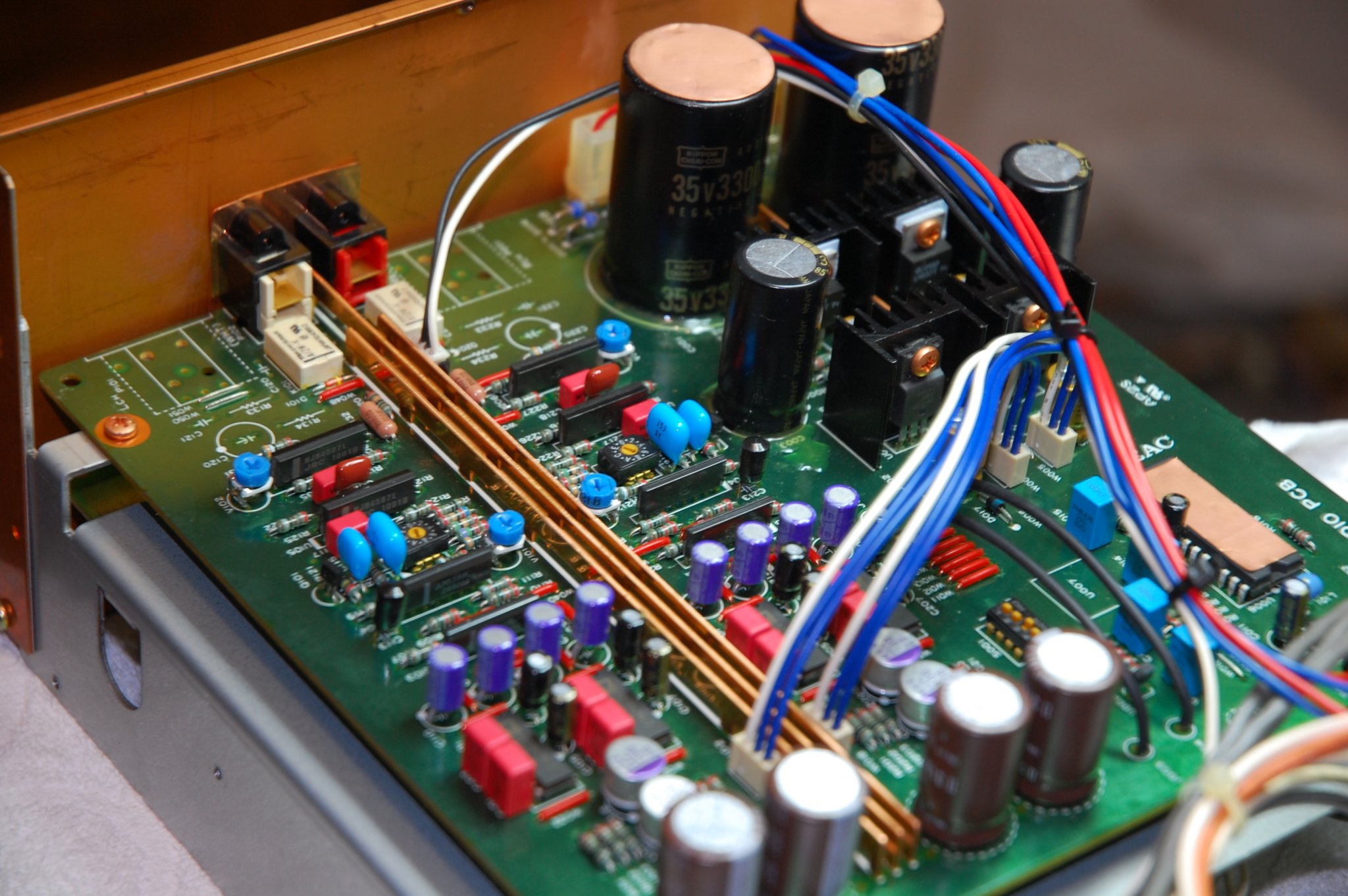

TEAC D-700:
My last 2R2 DAC purchase, with 4x AD1862N-Z. I've upgraded the diodes to BYV27-50, several capacitors are renewed and all the jumper wires are changed to Neotech UP- OCC copper wires.
I hope you will enjoy the pics.
Beautiful.
I've always wanted one!
It cost about 700 bucks in 1992. 😳
https://audio-database.com/TEAC-ESOTERIC/etc/d-700.html
Very orderly interior.
I would have expected only the transformer/ps a little more "robust", as far as we can say only looking it, but I'm so set in power supply.
Good job inside. 👍
