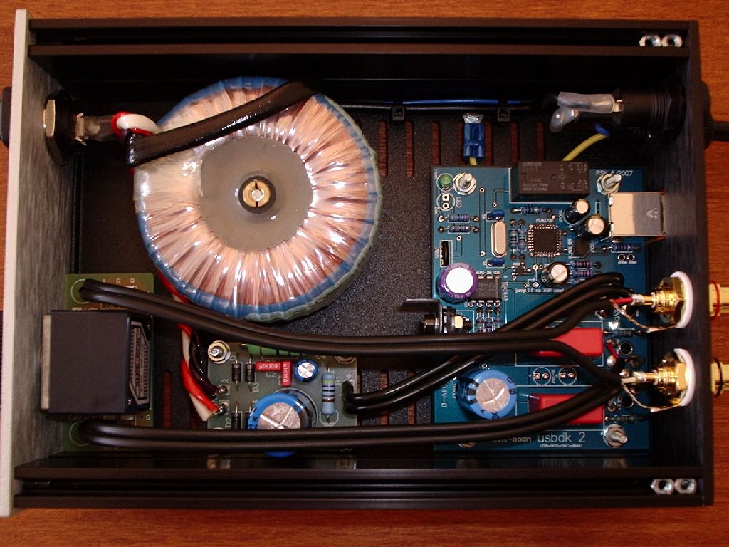

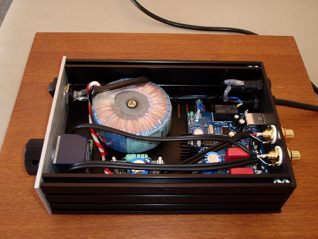

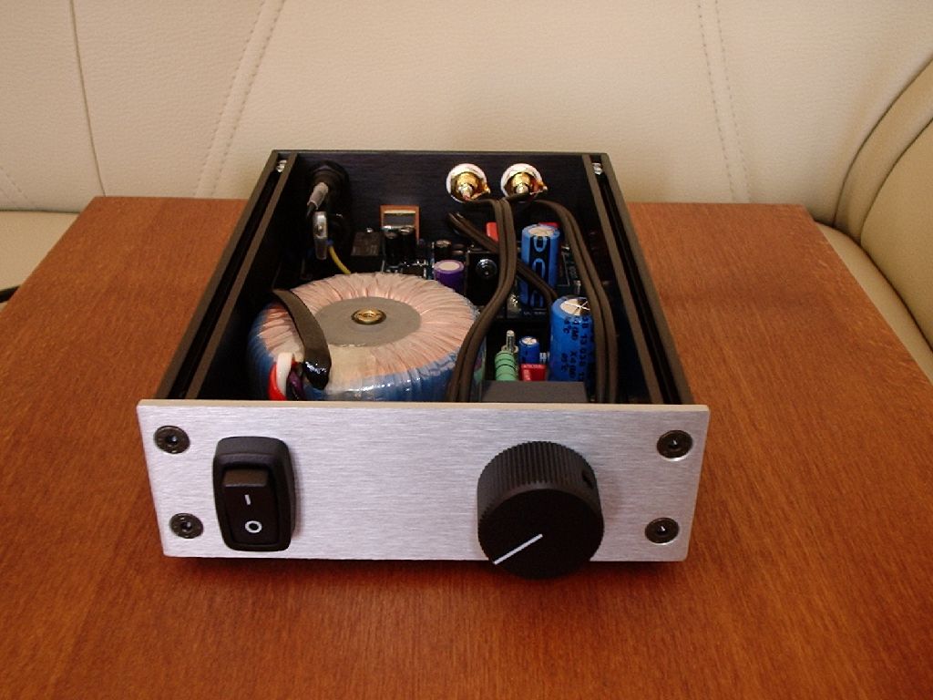

My Scott Nixon USBDKII, based on the TDA1543.
Simple but very good sounding unregulated power supply, integrated volume control (Alps 20k), Sedlbauer toroid transformer 30VA, Wima output caps and the very important Sanyo Oscon for TDA1543 decoupling ;-)
I really like the sound of this dac! It's dynamic and fast, lively, coherent and natural sounding with a remarkably controlled and tight bottom end. Very open and forward, but without being excessive in any area.
But I tested MANY different power supply designs and different output coupling caps before I threw all this into the case...
What about this very nice chassis and the panel knobs ?

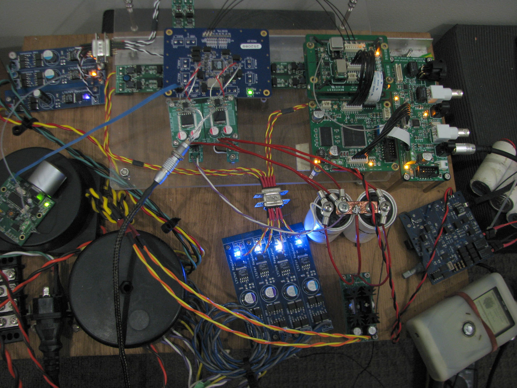

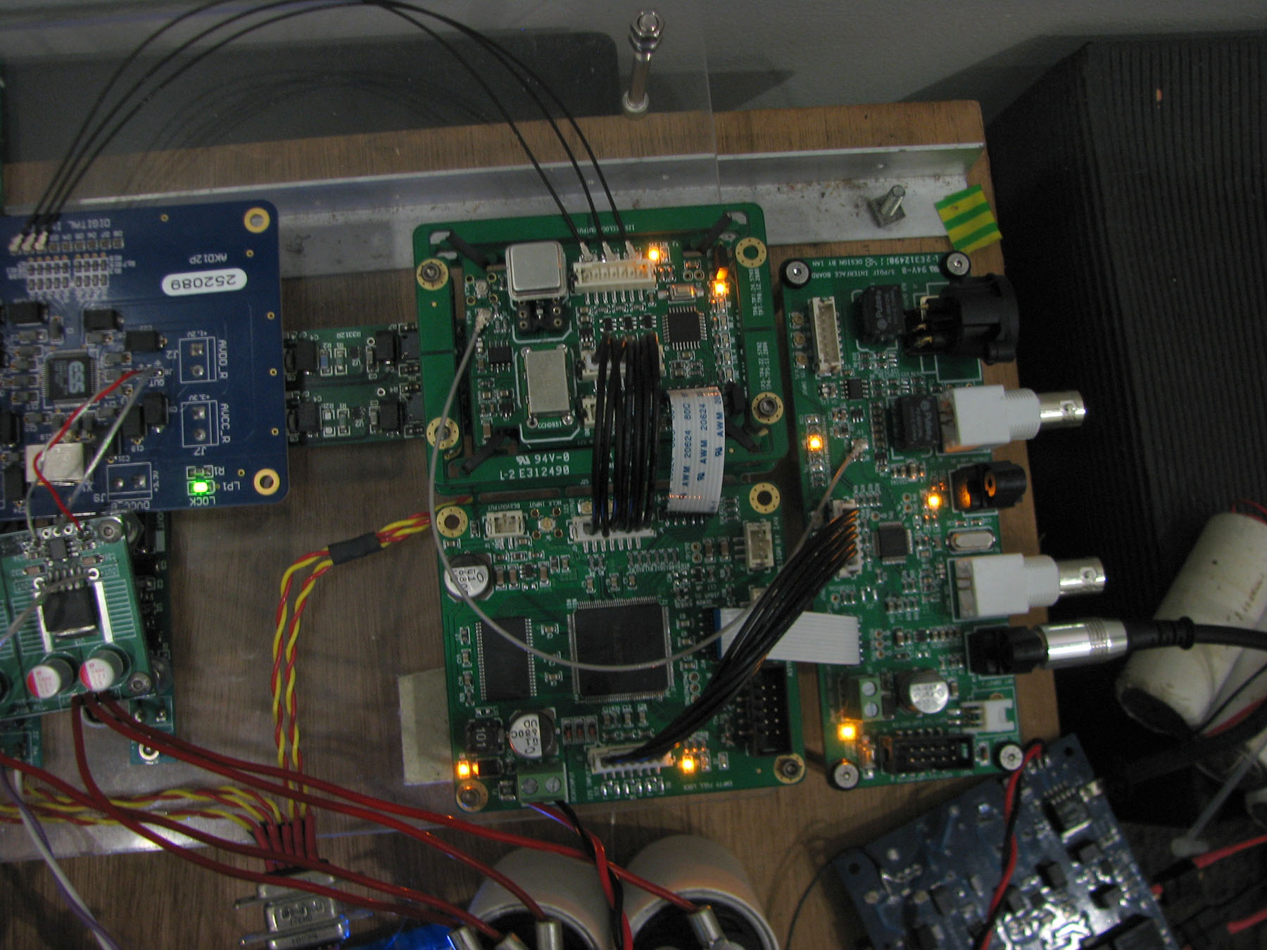

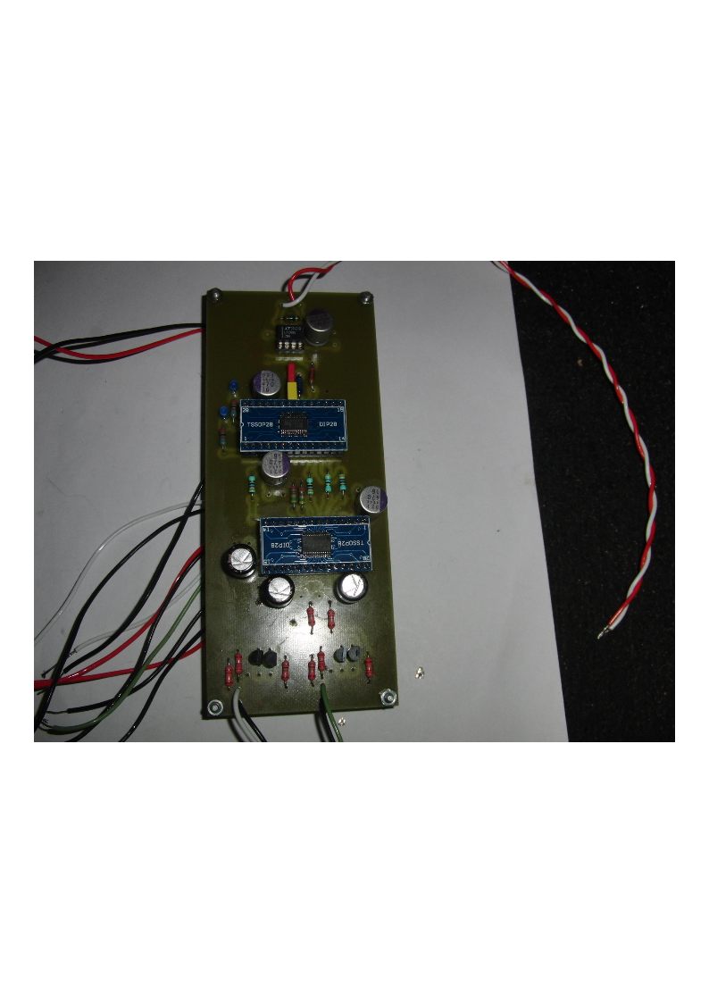

heres 2 of the 4 channels of my dac in testing phase. 4 channels used for digital XO
in this pic its directly connected to the BAL-BAL version of the wire headphone amp with the input resistors removed so acts as a buffered IV stage that can drive headphones directly; and boy does it!!

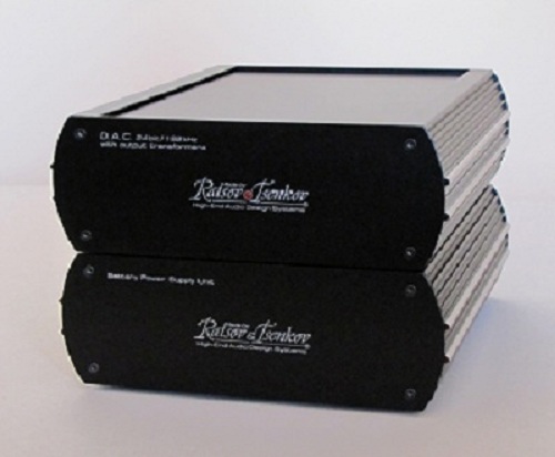

Hi this is my new project.DAC 24 bit/192khz WM8740 with output transformers
Sowter and separate battery power supply
which sowters are you using? how did you connect them to the dac?
