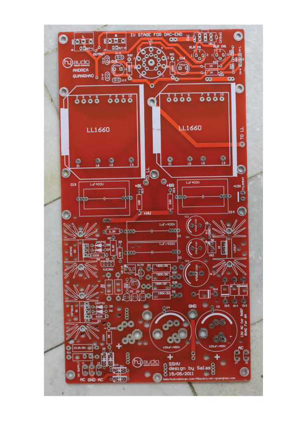

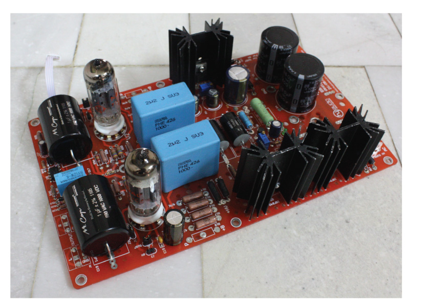

... C3g in triode mode and a Lundahl LL1660 as output transformer ?
It is possible see my Phono End
Hi-end phono preamplifier
a single C3g per channel with LL1660/10mA 4.5:4 or 4,5:2 will be ok but much more expensive
Interesting design. Is it possible to use C3M instead C3G as they have almost the same spesification except the HV?
BTW thx for the link Andrea......
C3g in triode is better. C3m is better as a pentode, as triode it is nothing special, less linear than a 6sn7.
The C3g has an internal resistance of 2,3kohm, which fits nicely to the Lundahl, and is very linear as triode with very little distortion.
@Andrea: You seem to run the C3g with very little current. I have best results with about 15mA/160-180V, with low current it sounds phlegmatic and too dark and with bloated bass, hence not linear. Maybe this works together with special speaker like lowther, but not with my horns.
