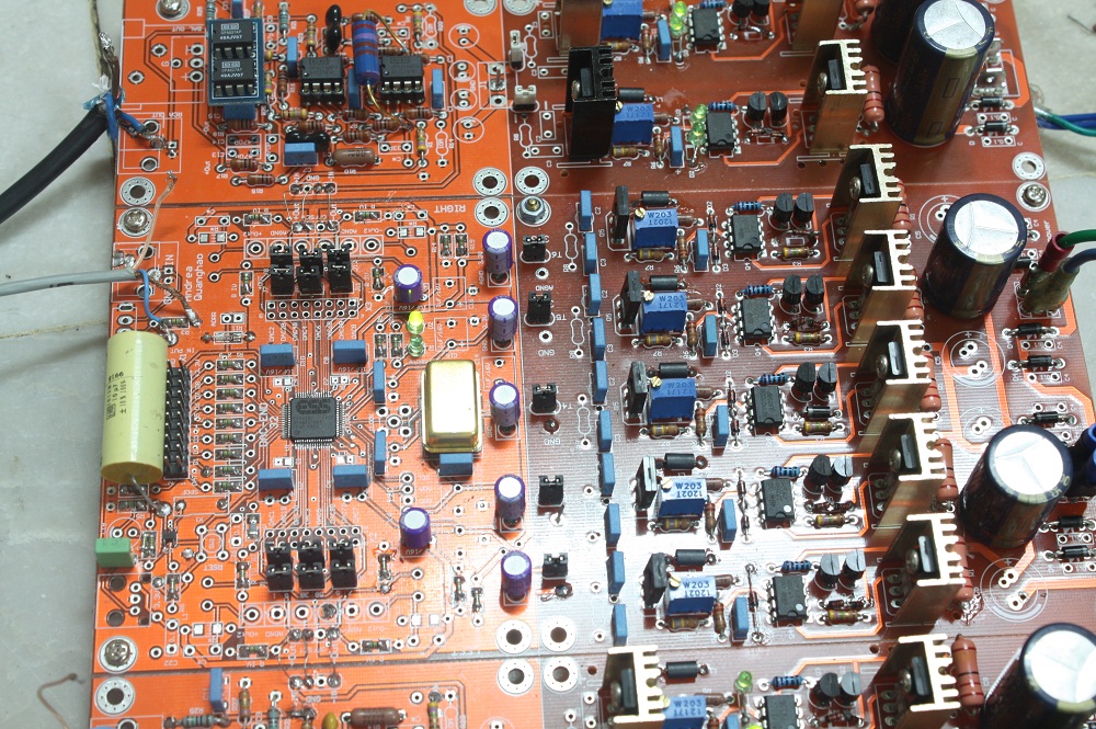

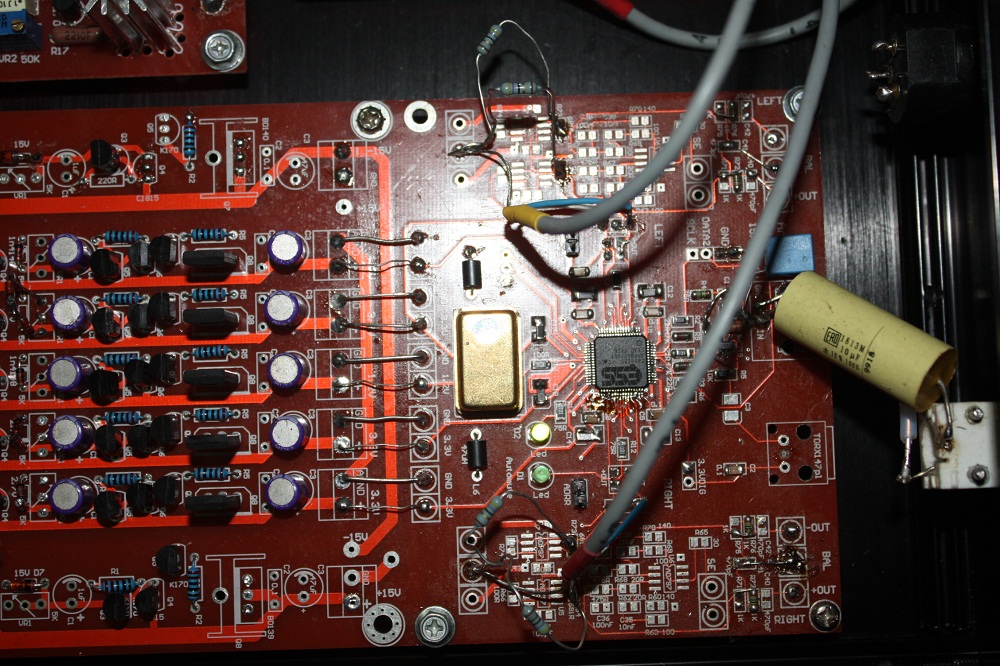

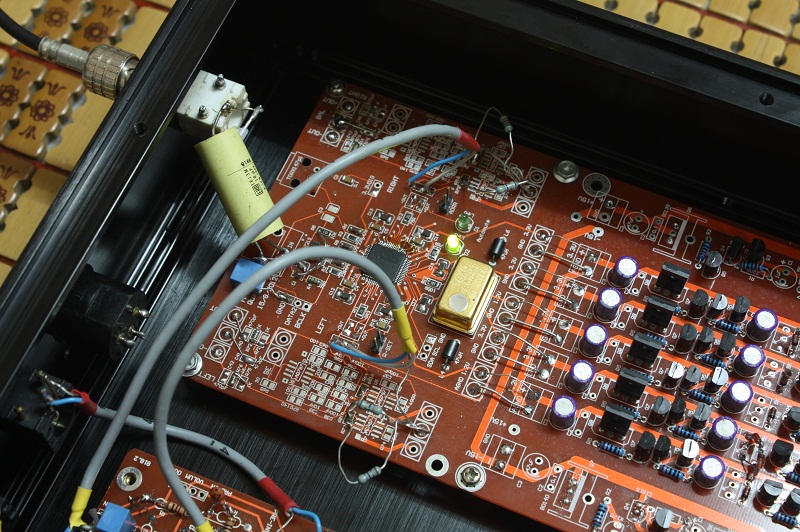

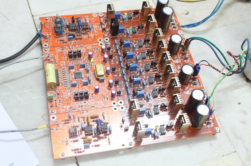

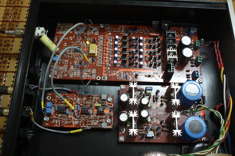

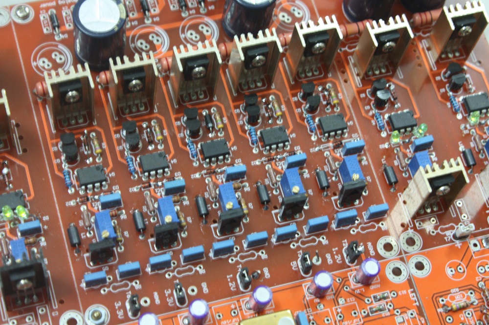

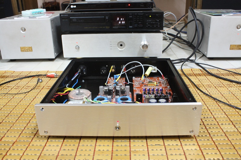

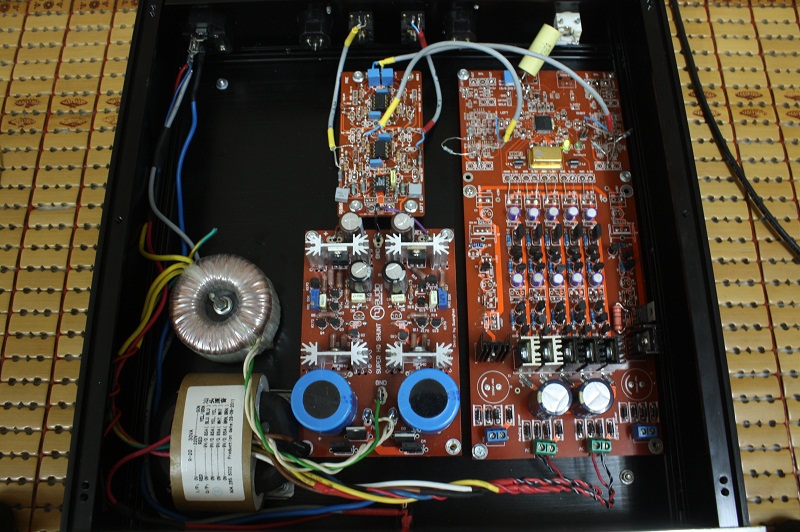

Andrea and Quanghao continue to study the DAC, with ES9018 chip, a DAC chip and new potential.
After nearly two years of support from chip manufacturers and work with Andrea, He and I had initial success with the 32-bit DAC, we call it the
DAC-End R.
The sound is Very detailed and balanced, high fidelity, very impressive to me!
These are the first images of the DAC-End R
Thanks you!

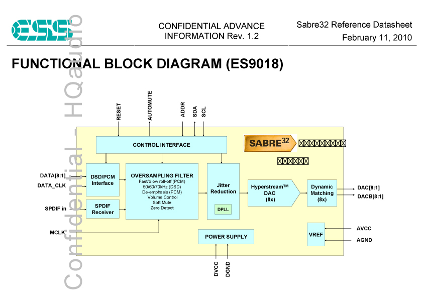

So the $64,000 question - does it sound better than the AD1865 or is this just to accommodate customers who want more bits?

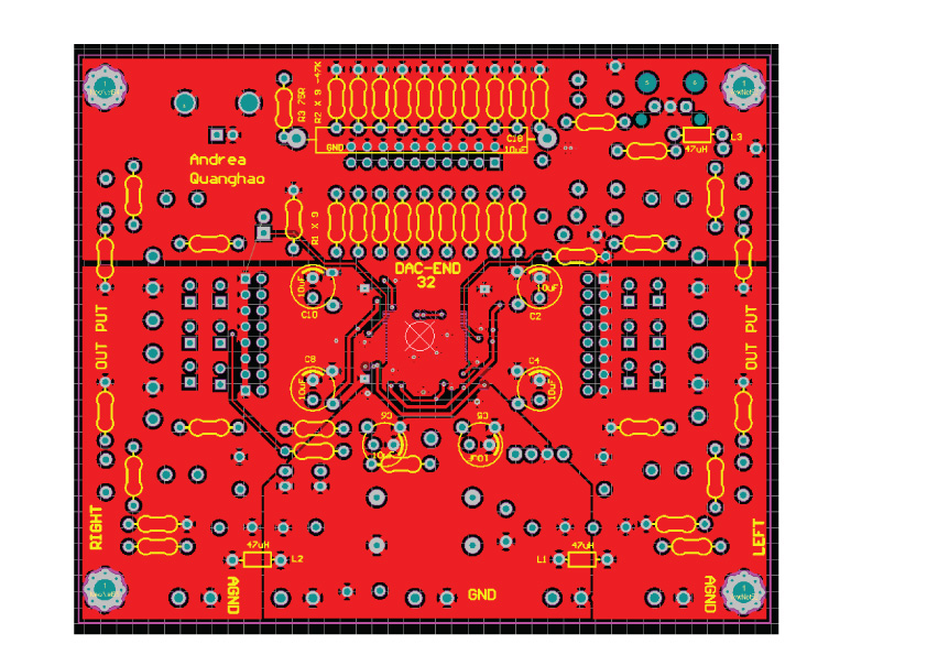

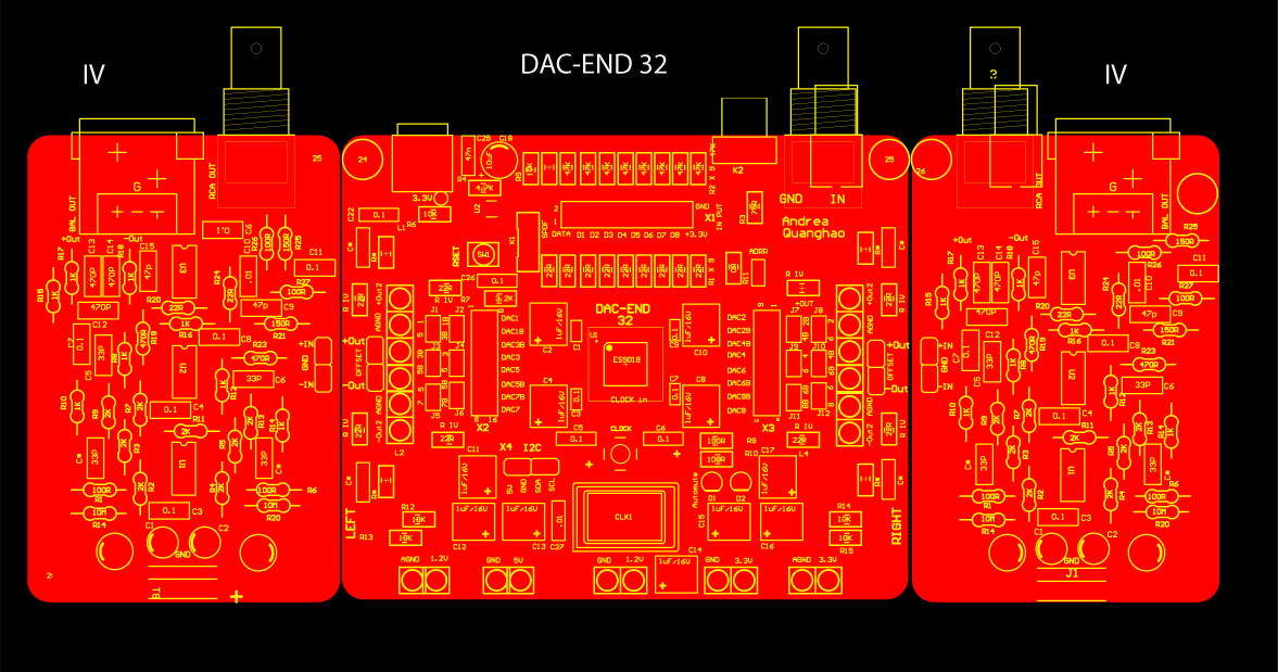

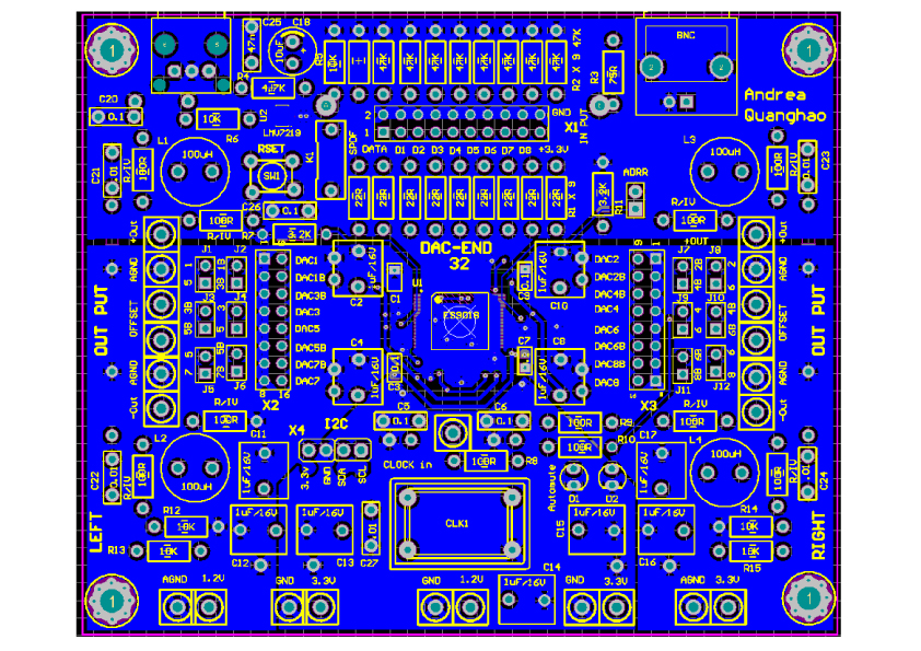

I really think ESS needs multilayer PCB
I think a good layout design does not need to use the multi-layer PCB.This is my layout!
thank you very much!
DAC layout is not a simple job, always need separate DGND and GND.Need to calculate properly, and connecting them together, and the energy supply for the function of the chip!
In terms of the multi-layer PCB is the best choice, but with the existing conditions, 2 layer PCB is easier!

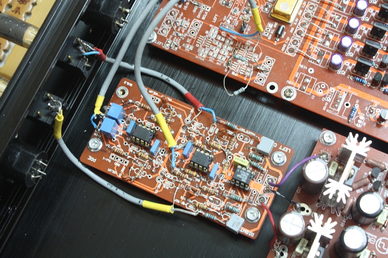

i like passive I/V,

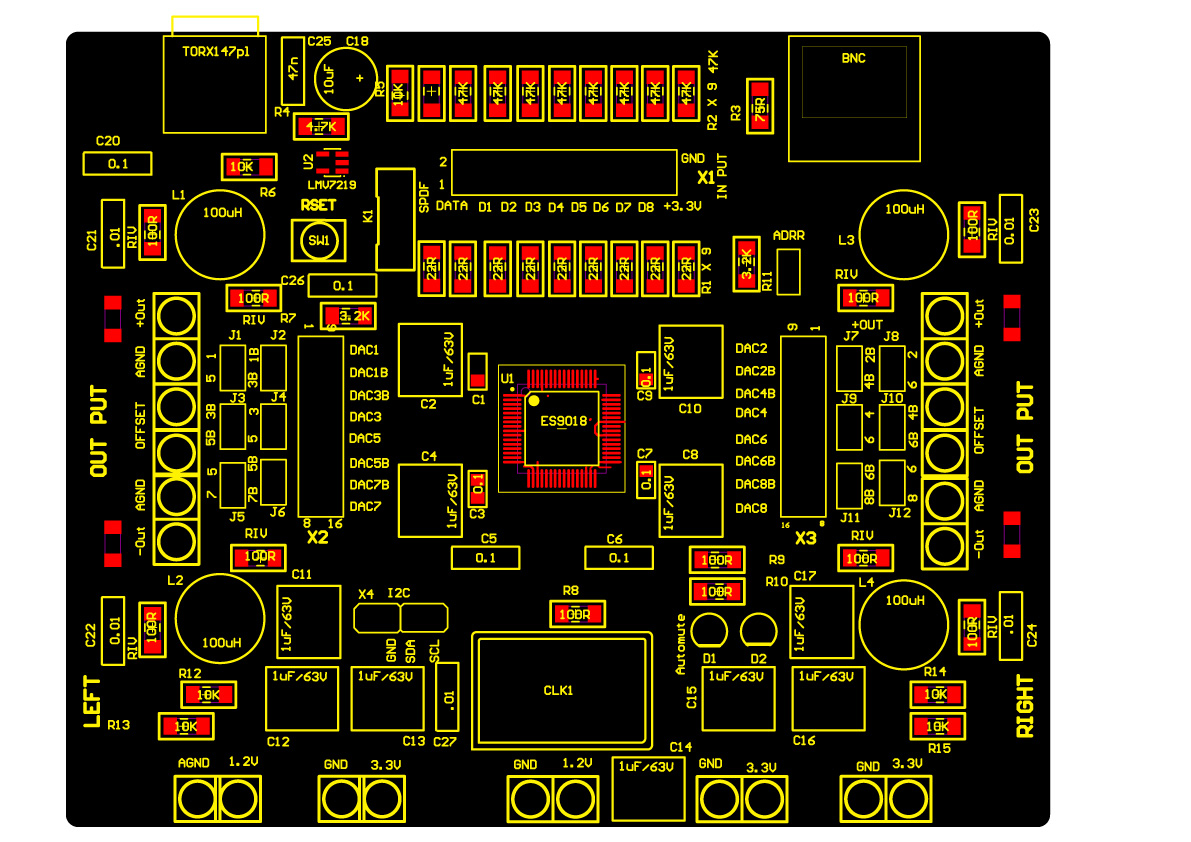

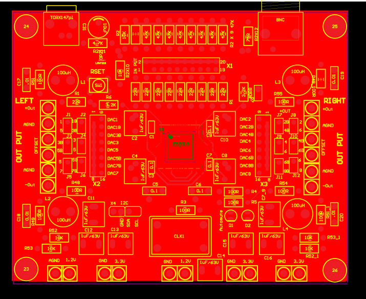

Here is the layout I just completed, I need to set the test PCB.
PCB including, DAC, IV, and the source,
You can use the IV tube in:
http://www.diyaudio.com/forums/digital-source/216980-universal-hi-end-hybrid-output-stage-dac-2.html
Will DAC-End R be offered as a kit or fully assembled and tested?
Andrea and me, need test with new design layout, and say you later, please waite me.
But i think kit assembled +tested, it is better for all. You only make iv stage for it.
