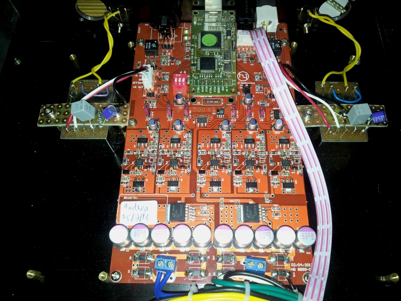

My actual configuration with LL1684.
Voltage mode and on output a parallel of these components:
1K 1/4w metal
10uF 6.3V Sanyo OS-CON
0.1uF MKP Vishay MKP1837
