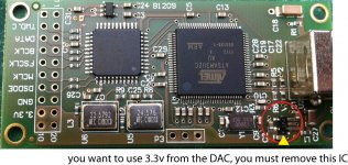

HI Quanghao, I have a second Amanero with the 3.3 reg removed. Problem still there.
Cheers Herbert
no no, in you DAC not can use 3.3v from DAC, because the USB not remove the IC supply get 3.3V from computer.
See image again
thanks
See image again
thanks
Hi Quanghao, I mean I have two amanero USB module. One with IC supply removed, one is not. and problem remain the same whether the IC supply is removed or not.
Anyway, I PM Domenico from Amanero about the problem and here is his suggestions:
"Hello, in Audirvana there is a delay option is it enabled?
If you are using a DAC with automute it's possible that 0.5s is the time the DAC needs to remove the automute. If you use a sabre dac chip there is the possibility to make the automute exit faster.
domenico"
So firmware update for the DAC to shorten the automute in 9018, etc?
Cheers Herbert
