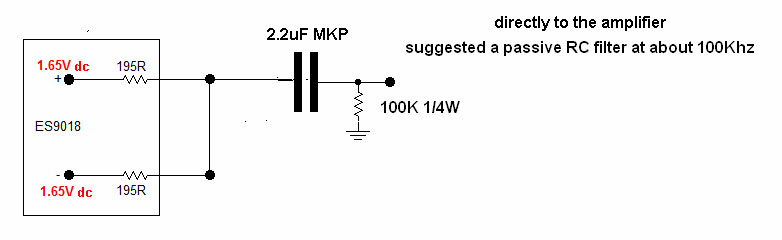

But I just saw this diagram in an earlier post by Andrea -
http://www.diyaudio.com/forums/quanghao-audio-design/228755-dac-end-r-es9018-full-assembled-board-63.html#post3509756
Wow, direct output with no I/V stage. Has anyone tried this? Sounds ordinary/OK/good/great?
And Andrea suggests a passive RC filter at 100kHz, can someone tell me what component values are required for this?
Does it depend on my amplifier's input impedance? It's 20k.

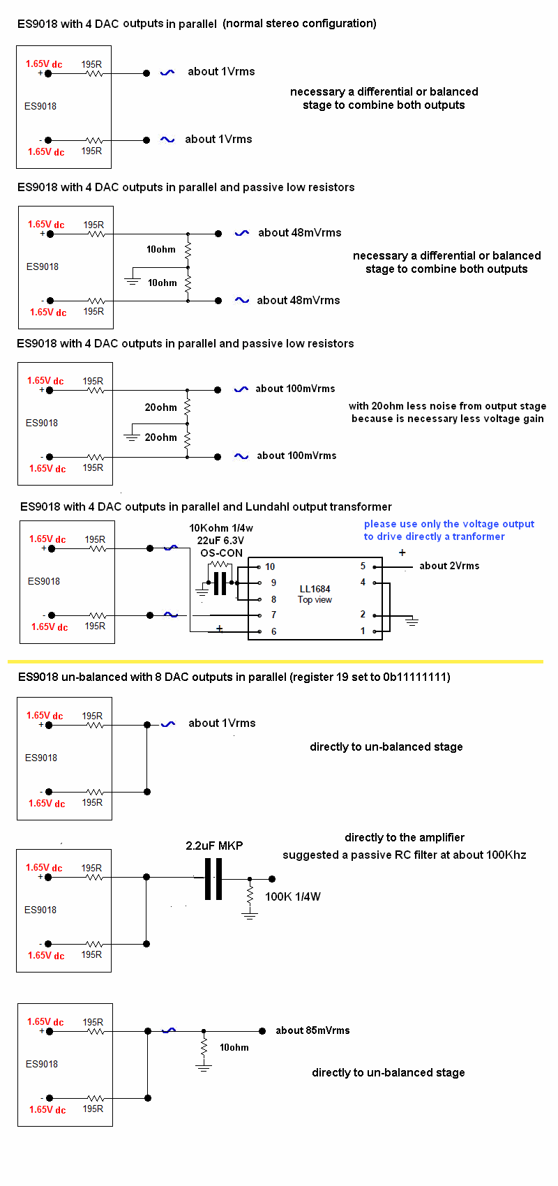

Hi linuxfan,
...Wow, direct output with no I/V stage. Has anyone tried this? Sounds ordinary/OK/good/great? And Andrea suggests a passive RC filter at 100kHz, can someone tell me what component values are required for this? Does it depend on my amplifier's input impedance? It's 20k.
Referring to your schematic and related to ground : (+1.65V -1.65V) = 0V ... but I don't know what does mean "ES9018 un-balanced with 8 DAC outputs in // (register 19 set to 0b11111111" on this schematic.
Usually, you need an op amp like that to get un-balanced output from balanced output.
Update : Concerning register 19 and according to this post, it seems to be possible to change the output phase of the ES9018.
Yes, Andrea added the option in software-control to invert the phase of the DAC- outputs, and use these in parallel with the DAC+ outputs. He refers to this as "unbalanced mode".
Total current is then double; approx 16mA per channel instead of 8mA per phase.
I want to know what capacitor (and resistor?) I would need for his suggested RC filter.

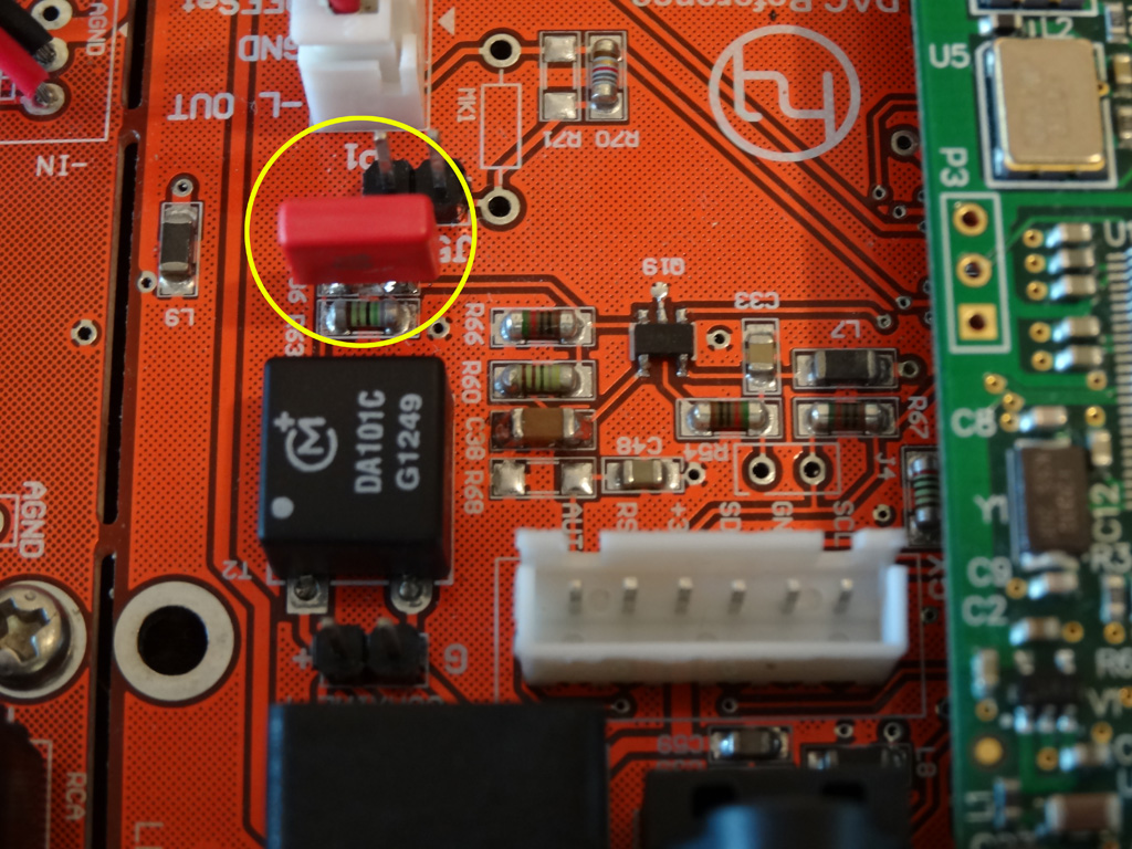

Hi Halook,
Here is close up of the spdif section of my board.
- On mine, R68 is installed but this part of the circuit does not concern the coaxial input.

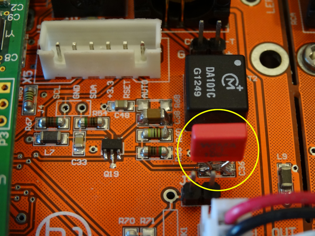

Hi Domi_78,
Have you fixed the SPDIF in to accept 48KHz or above?
I have soldered a 0.1uF onto C36 position but mine still does not work with 96KHz or higher.
Quanghao / Andrea,
Any suggestion to fix the SPDIF input to accept 96KHz or higher

Hi!
No, in this code, you can not use unbalance out, because, i change all when sent to all.
The sound or unbalance , i test it not good for the sound. Please keep balance out put, wit my Iv or other IV, if you need and like!

Hi Domi_78,
Quanghao / Andrea,
There is a trace shorting out C36, you need to cut the trace otherwise the cap doesn't do anything.

I am using this configuration. No filter. Direct out to Symasym. I have changed the output configuration of the DAC to unbalanced out as documented by audiodesign, shorted Out + and -. I can't compare it to other iv stages yet. All I can say is I am very happy with this configuration so far.
