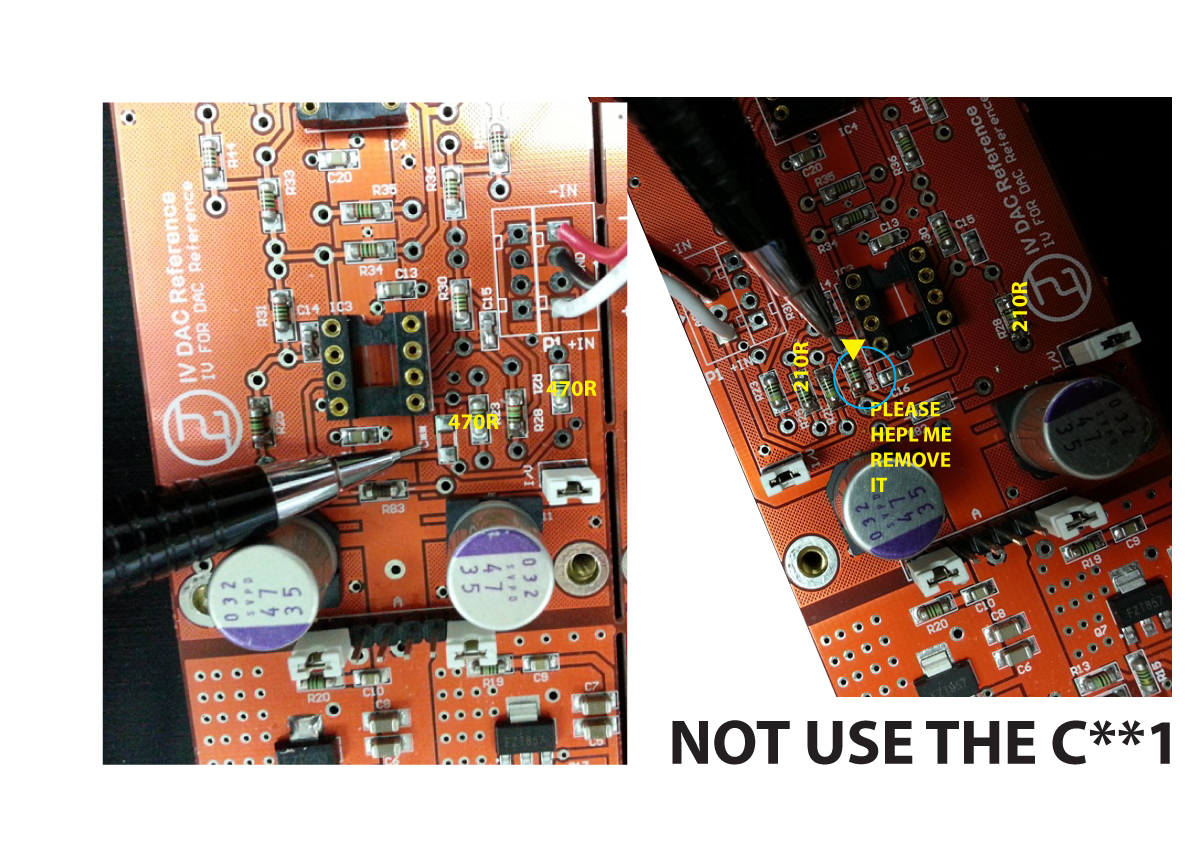

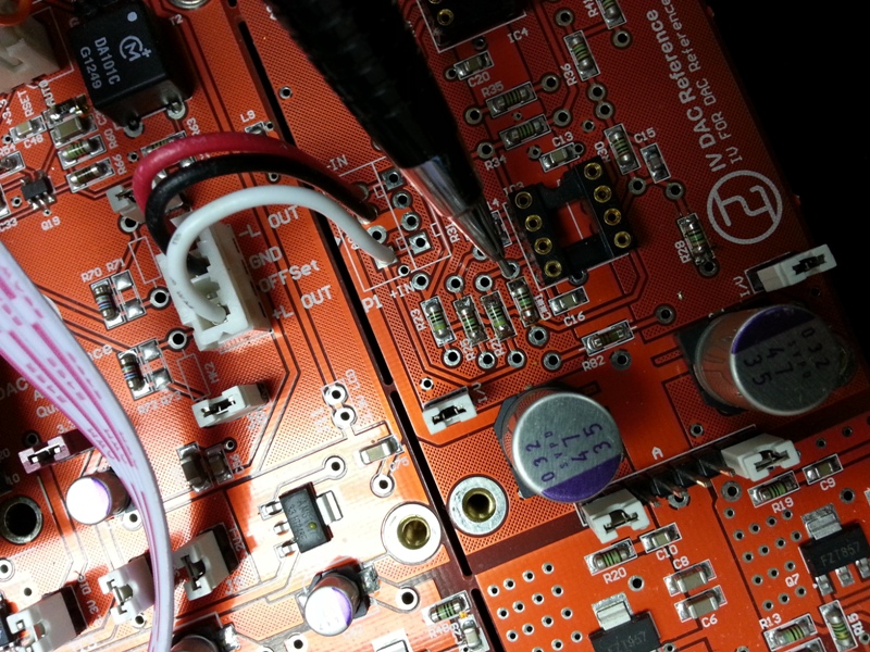

Have checked all jumper and they are good. Taken all opamps out to check all resistors in the output section and on the right hand side.... R21 and R23 are 470ohm. On the left side, R21 and R23 are 283 ohm. On the left hand side, there is one extra resistor at the C?? position just next to R21 and is 176ohm. Should both sides be the same? Should i take out that extra resistor? Cheers Herbert

Hi bertchai! I fault this place, please help me fix it! take a look at this picture! Thank you much
I presume this is a joke ... 🙄

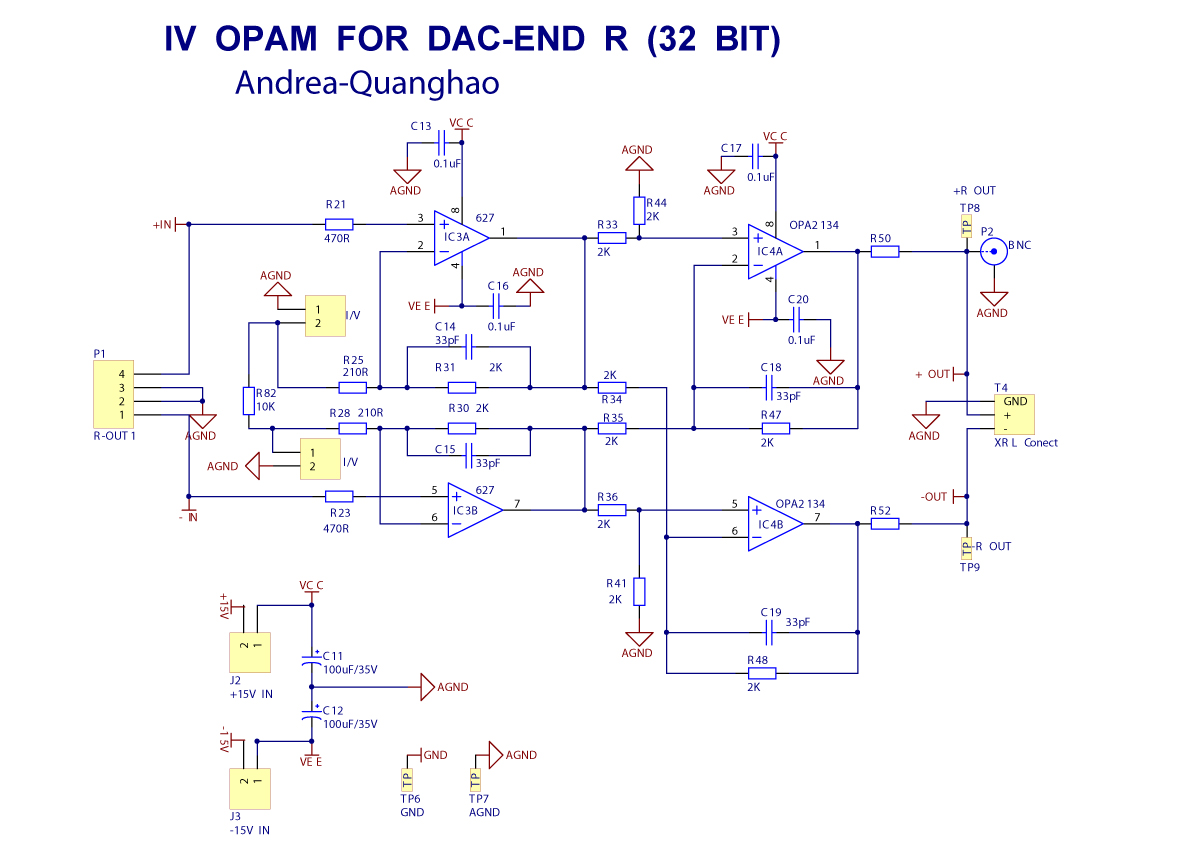

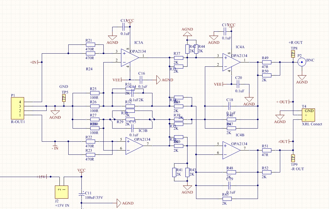

- What does mean all the dual resistors ? (R21/R24, R33/R37, R49/R50, ...)
I presum this is a joke ... 🙄
Oh, I'm very very sorry, I'm wrong!
it is!
thanks
- Don't worry Quanghao and thank you very much.Oh, I'm very very sorry, I'm wrong! thanks
Yes, it is the parallel resistivity beneath the PCB, you can change the sound quality, by installing another parallel resistors!
try it see stars, I will send you the new IV for you to do that. You will be surprised!
