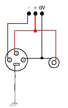

Hi Quanghao & Andrea,
I have been asking to you the schematic of the I/V output stage for several times and you did never answered me on that point.
So, following the traces on the PCB, I tried to recognize how are connected the output connectors XLR and RCA. I think it looks like the joined schematic and I consider this schematic is a little bit simplistic... This means that it is impossible to use at the same time the XLR connector to sub amp and RCA connector to main amp because we will encounter issues in impedance balance.
More, I notice that + and - are not "summed" on RCA output.
- Do you confirm my point of view ?
Thank you very much.
I don't have the complete schematic at this time but as I told before you can use both outputs.
The XLR and RCA are in parallel so for the "impedance balance" the RCA load should be 10 times higher than XLR load.
The op-amp output impedance is very low so you will not ear differences also if there is a un-balanced impedance on XLR.
Hi Andrea,
So, according to this schematic, if I need two unbalanced non parallel outputs, can I consider that :
- The output "+" remains connected to the RCA connector.
- The output "-" is connected through the XLR to a second RCA connector.
The consequence being that these two unbalanced RCA output are opposite in phase.
audiodesign said:I don't have the complete schematic at this time but as I told before you can use both outputs.

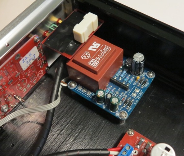

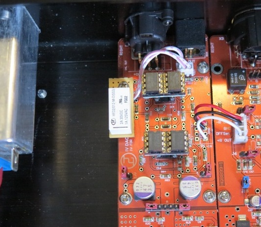

To prevent loud pops in the loudspeakers, my DAC is now fitted with a mute on XLR and RCA outputs :
- A reused and modified protection circuit for loudspeakers controls one relay per channel that connects the outputs to ground during power up or during power down the DAC.
