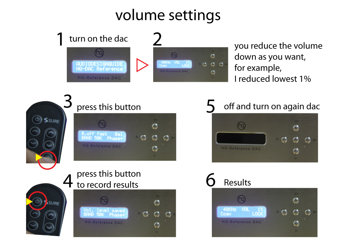

It is not easy! Every time I set the volume output level to 100% and save it according to your guide, it reverts to 40%!
please see it!
thanks

I don't know if you/Andrea did it on purpose or a bug, but setting and saving the output level to 100% is not possible at all😡. Setting and saving it to 99% or lower is OK though😱
Cannot save the volume level at 100% ?
This week and the next I am in holiday (Naxos island) so I can change the firmware when I came back.
Tell me if there is the necessity of other modifications.

1) Cannot save the volume level at 100%
2) Ask to save the input selection (other than USB).
3) Do not mute on high efficiency loudspeakers when level at 1%.

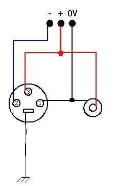

Hi Quanghao & Andrea,
I have been asking to you the schematic of the I/V output stage for several times and you did never answered me on that point.
So, following the traces on the PCB, I tried to recognize how are connected the output connectors XLR and RCA. I think it looks like the joined schematic and I consider this schematic is a little bit simplistic... This means that it is impossible to use at the same time the XLR connector to sub amp and RCA connector to main amp because we will encounter issues in impedance balance.
More, I notice that + and - are not "summed" on RCA output.
- Do you confirm my point of view ?
Thank you very much.
