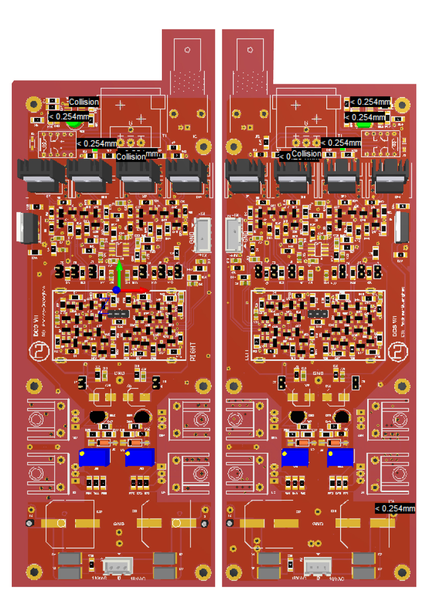

Here the PCB layout of the new output stage (We say : DCS V/Istage ), the main specifications:
- no feedback
- very low distortion because it work as current amplifier
- Vbe nonlinearity compensated using diamond buffer on output stage
- zero dc offset using dc servo loop
- variable voltage gain only changing a single resistor (I/V)
- high output current to drive any low impedance headphone in pure class A
- high output voltage to drive any high impedance headphone
- very low output impedance to drive any cable
- both un-balanced and balanced output
- differential configuration to reduce common mode DAC errors

Hi Quanhao and Andrea,
What would be needed to use new discrete feedback stage in the "old" version of the DAC? Can I just replace the op-amps?
