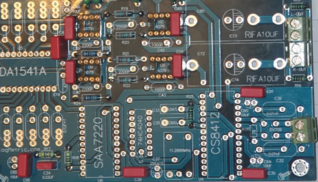

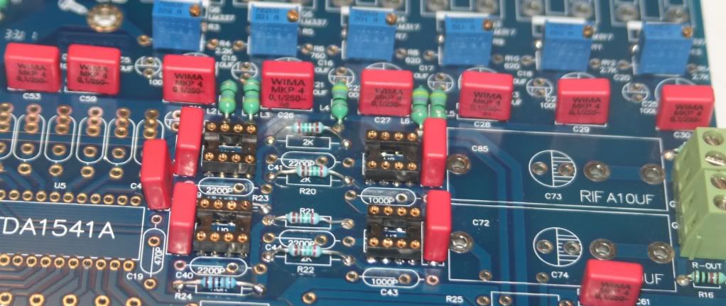

The 3300pF cap(C35) is marked omitted in my BOM, should I jumper or just leave holes as is?
Found ERO MKP's axial for the 2200pF and also found MKP's axial 2% for the 1000pF.
And last of the small ones, 10nF MKP axial

Hmm, I actually have some nice russian mil.spec silver micas 1000pF.
Would these be even better?

Hi Mayday - there is a resistor (R25) and a capacitor (C33) connecting pin 19 of the CS chip to ground, the missing cap C35 bypasses those so don't wire link it! It's probably optional, you could leave it out for now and then try it later.
It looks like that pin is the master clock output of the CS so, as you're reclocking, it's not required - those components ground it 'gracefully', I'm guessing the missing cap provides some additional filtering.
Careful though - I could be completely wrong! (I'm referring to the user guide posted earlier so confirm that we're talking about the same components!) Cheers.

Thanks Josha.
Looked at a pic after that post and saw that they simply left it out.
Since I went with 1Kohm for R25, according to manual I'll need to go with CS8412 and 47nF for C33.
Found a nice MKP 47nF for C33 🙂

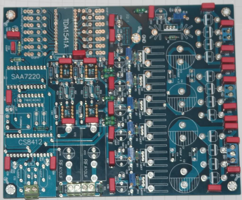

Planning a regulated PS for the SB Classic that will provide digital signal for this DAC.
So far I've decided to use a TPR but with LM350T instead of 317T(if possible).
6x2200uF before reg, BYV27-200 diodes.
1x6Vac(2,67A) transformer.

Hi Mayday, On the input receiver chip use the values exactly as shown on the datasheet for the part your using. I didn't populate the capacitor you mentioned off pin 19. The resistor/capacitor value is a little critical and you don't need the extra cap shown in the Analogmetric build sheets. Just Google the CS8412 or CS8414 datasheet and use that value exactly. The CS8412 and CS8414 use different values. Hope that helps.... Dave😛
Since I used the 1Kohm resistor, I'll use 47nF for the capacitor and use CS8412.
I'll leave C35 unpopulated.
This also matches the datasheet for CS8412.

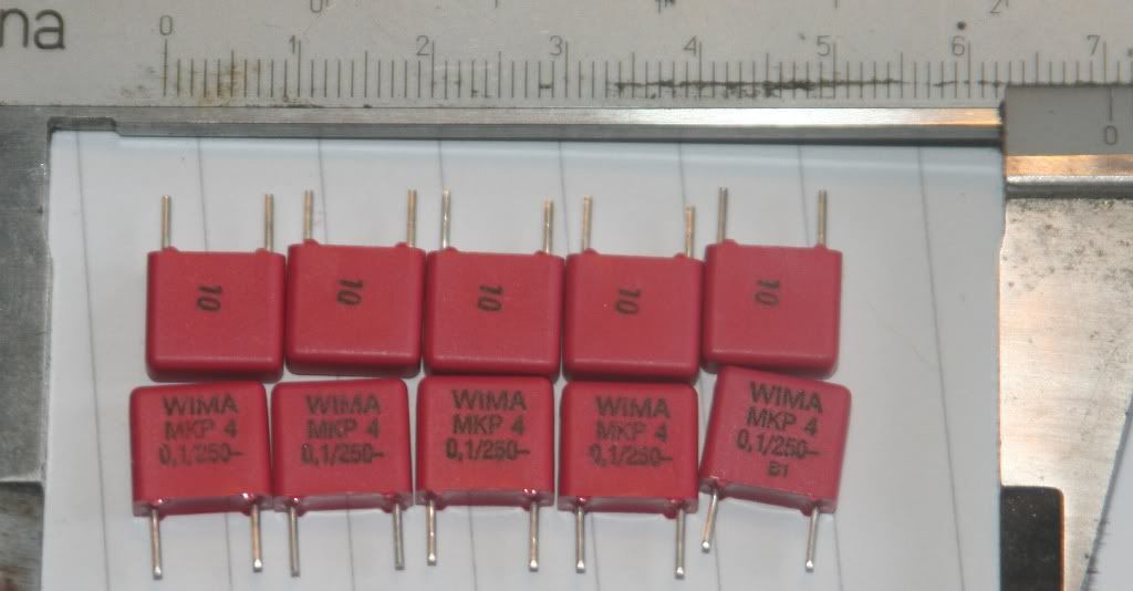

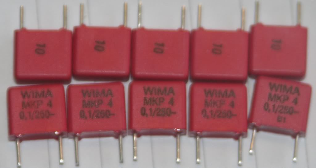

My Wima 100nF/250V MKP4's (30pcs) are sitting at the post office now 🙂
I'll have to wait until tonight to collect them though.
I think they are the best I can use that'll fit, although barely in some places...
Dimensions:
Width: 4,5mm
Hight: 9,5mm
Length: 10,3mm
RM/pitch: 7,5mm

DAC
Hi Mayday, Looks like it is coming along very nice. Yesterday I modded my line stage (new Opamps). Today I installed the 120 pF capacitor at the DEM pins 16 and 17. Well... I must say this is not a subtle change. I used 120 pF 2% PPS SMT Panasonic. A complete change for the better. Thanks UV101 and Mayday. 😱
