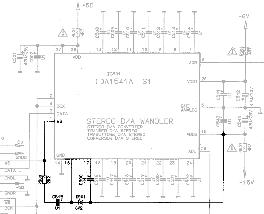

I am very happy with the Grundig circuit. My path started with the usual Philips speced 680pF cap across 16 17. I replaced with 200 pF silver mica. Much improved. Then did the Grundig circuit with Riken resistor and an inductor in line with the reference voltage from pin 15. At the time I felt it was a big step forward. Then used 8uf organic polymer smt caps in the Grundig c550,515 positions. I think this was an improvement. There was a lot of time between mods, so not a really scientific test. I am quite happy with the sound, so not heavily motivated to experiment further.
Grundig DEM
I am still unclear about the capacitor values for C550 and C515. One post it looked like .1 uF another 1 uF and your at 8 uF.
Do you know what Grundig used? I appreciate any comments and thanks for sharing. 😉
