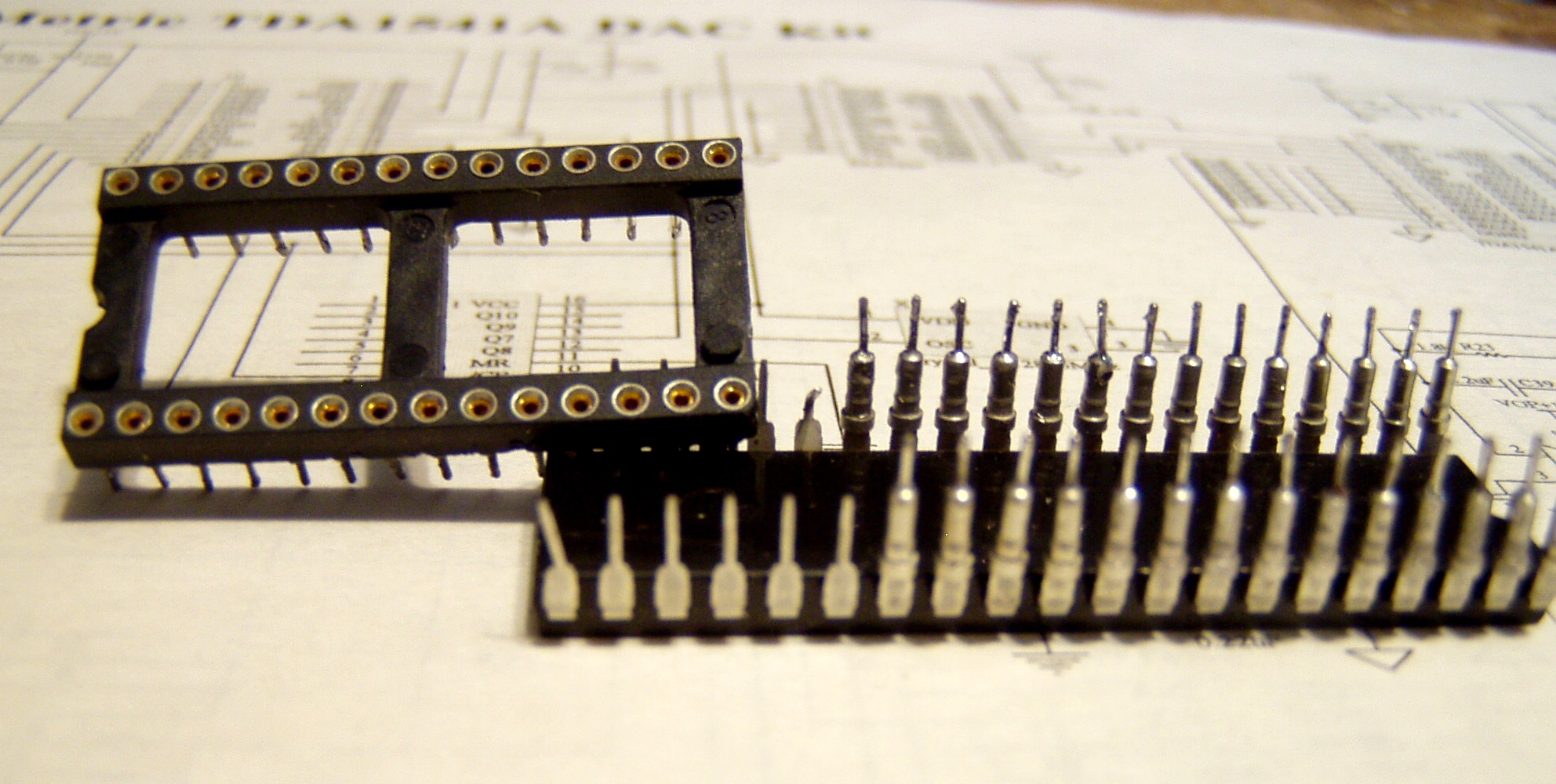

Hi Dave,
The DIP socket for the cs8414 is bad. Continuity failed from the top of the socket to the pin bottom soldered to the board.
ctef, that's a nice looking board. Can you tell me where I could find the little pin cups to make a nice strong socket like the one shown in your picture?
Dwight
Dwight

Hi ctef,
I just had to remove a dip socket made with the gold plated pins because of continuity issues. Unfortunately because of greedy corporations, manufacturing has been exported and we have to buy most products like this from China. The problem with that is quality control. Some products work well, others do not. If you have a source that produces reliably good products, try to buy from them.

Hi ctef and msmart2b, I remember reading that John (ECDesigns) removed those from a CPU socket for a computer. I have an old socket and it is on my to do list. 😉 John is one cool dude and one of the most productive here on the forums. Nice that he shares. 🙂This board is from -ecdesigns- picture. I'm also impressed of it.

Here you are naked pins from old socket. From thous old huge public computer-games from 90's.
It is easy to strip them with sharp nippers.
But I'm going to wait and thous "gold plated" from China, to check the quality.
As You can see, this pins are also yellow inside. Don't know brass or really gold plated😕
