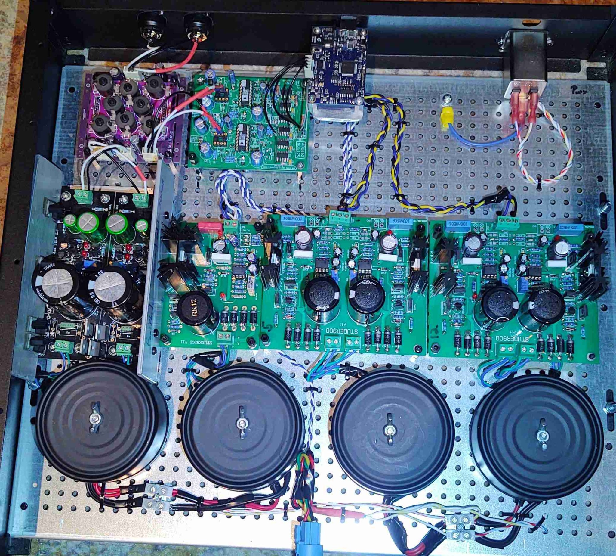

I'm reporting back on my personal findings with my Miro AD1862 DACs.
- I built two copies of Miros DAC with identical PSUs (studer 900 clones).
- The first copy (Miro A) used a waveIO usb to I2S input with its own separate PSU and shift registers, I tried a few opamps that I had on hand but found that I prefered a Sparkos descrete opamp by far over the ones that I tried. This copy sounds very good.
- The second copy (MiroB) used identical PSUs and used a JLSounds usb to I2S input with separate PSUs. This copy bypassed the shift registers and used the JLSounds to send 20 bit input directly to the DAC. I also tried and liked Sparkos opamps with this build.
- I thought that MiroB sounded a bit better than MiroA. MiroA seemed more diffuse, less forward in comparison. MiroB more forward, but better dynamics seemed more intense. One could stop here and get very nice sound.
- I just completed adding Abraxilitos Dark IV to Miro B. I used a Salas ultra BIB shunt psu for the IV. This gave a big upgrade in sound over the other configurations. Improved soundstage, better dynamics, more clarity and detail, more impactful and powerful bass. The sense of realism is improved and easily heard over the other builds. This build easily becomes my reference DAC, really excellent sound. See the attached pic of the MiroB build.
- I still working to complete my CEN IV (for me a tough build) to try it out, When I'm done I'll install it in MiroA when I'm done and report my findings here.

That's right, it sounds better without shift registers, but you're doomed to only a JLS board and a USB input. If you want something else, say SPDIF and TOSLINK, Amanero, WaveIO and the like, you have to use shift registers. So I will probably end up with two DACs, one with a lot of inputs and an AK 4118 receiver board (AD1862) and the other with only USB and PCM63. That second one will also get a tube output stage. So the ultimate approach for PCM63 and compromise for AD1862.

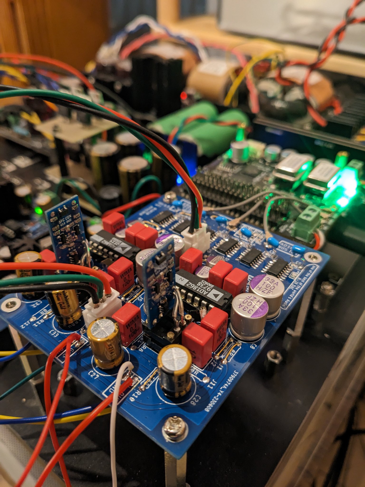

Hi PJN, I also have Abraxilito's Dark IV with +-15v.
Now I am playing with opamp.
Are there anything to take out from DAC PCB?
I am thinking to take opamp 2 for + 3 for gnd to Dark IV.

You also need to remove Riv(r8,r9) and Civ if you have them installed. I out to IV is from pin 2 on opamps , and from pin 3Hi PJN, I also have Abraxilito's Dark IV with +-15v.
