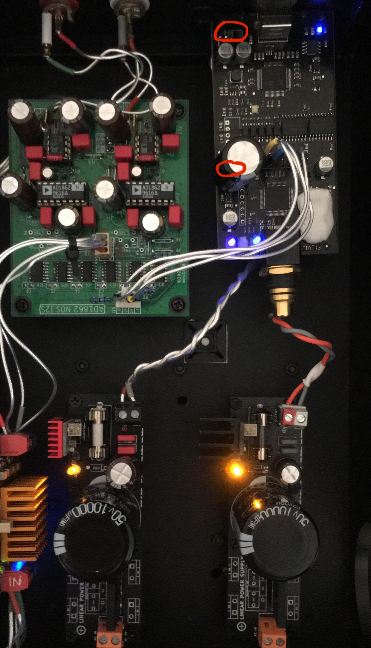

Second round of modding: Singxer F-1 power supply.

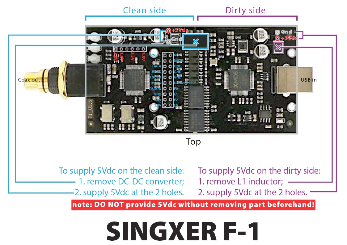

I have heard a lot about the notorious 5V inside the USB cable interfering the data lines. I want to try all LPS for F-1 for both dirty side and clean side.
I did the 5V on the clean side first. Simply removed the boxy DC-DC converter and then gave it a low noise Lt3045 reg @ 5V.
The improvement is obvious! I am pleased and listened to it for two days.
Then for the dirty side 5V input, I removed the big inductor beside the USB port to cut off the USB 5V.
Then supplied it with 5V from Lt3045 reg.
This time the improvement is enormous!
Surprised that I never thought the dirty side was important to have a nice clean power.
The bass is back! I don’t need passive bass boost anymore!
Details, details and details for bass mid and treble.
It is unbelievable.
I also replaced the SMD cap with a low esr 10,000uF cap on the clean side.
I am happy with this little modding.

Here is a diagram showing the Singxer F1 solution.
I updated in a relevant thread "Powering Singxer F1".

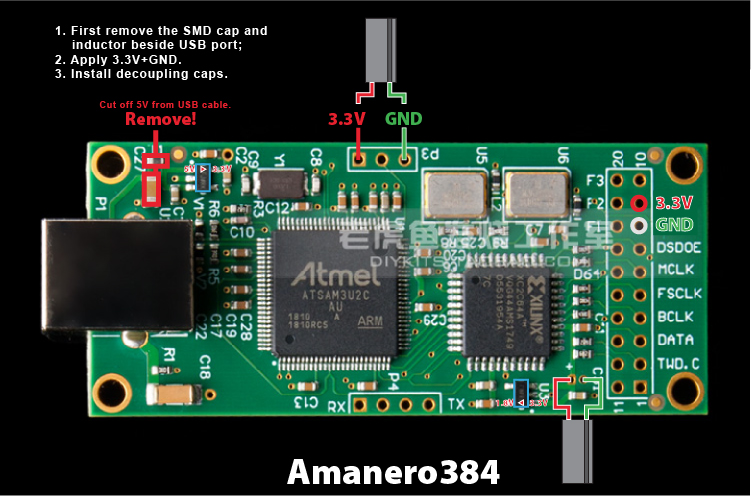

I just pulled out the Amanero384 board from my Dam1021 Dac and did the similar modding.
The outcome is again surprising good! There was a layer of "noise" before; now it is gone. I also attached a diagram indicating the modding for Amanero384.
By comparison, both are excellent USB-I2s interface boards with SQ being a bit different. I guess the clocks are different and no isolation for Amanero384.
