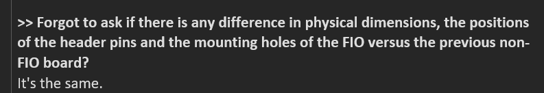

This is what I gathered from Lyuben of JLSOUNDS before I ordered the DAC board from JLCPCB. I will have to confirm it when my board arrives.
