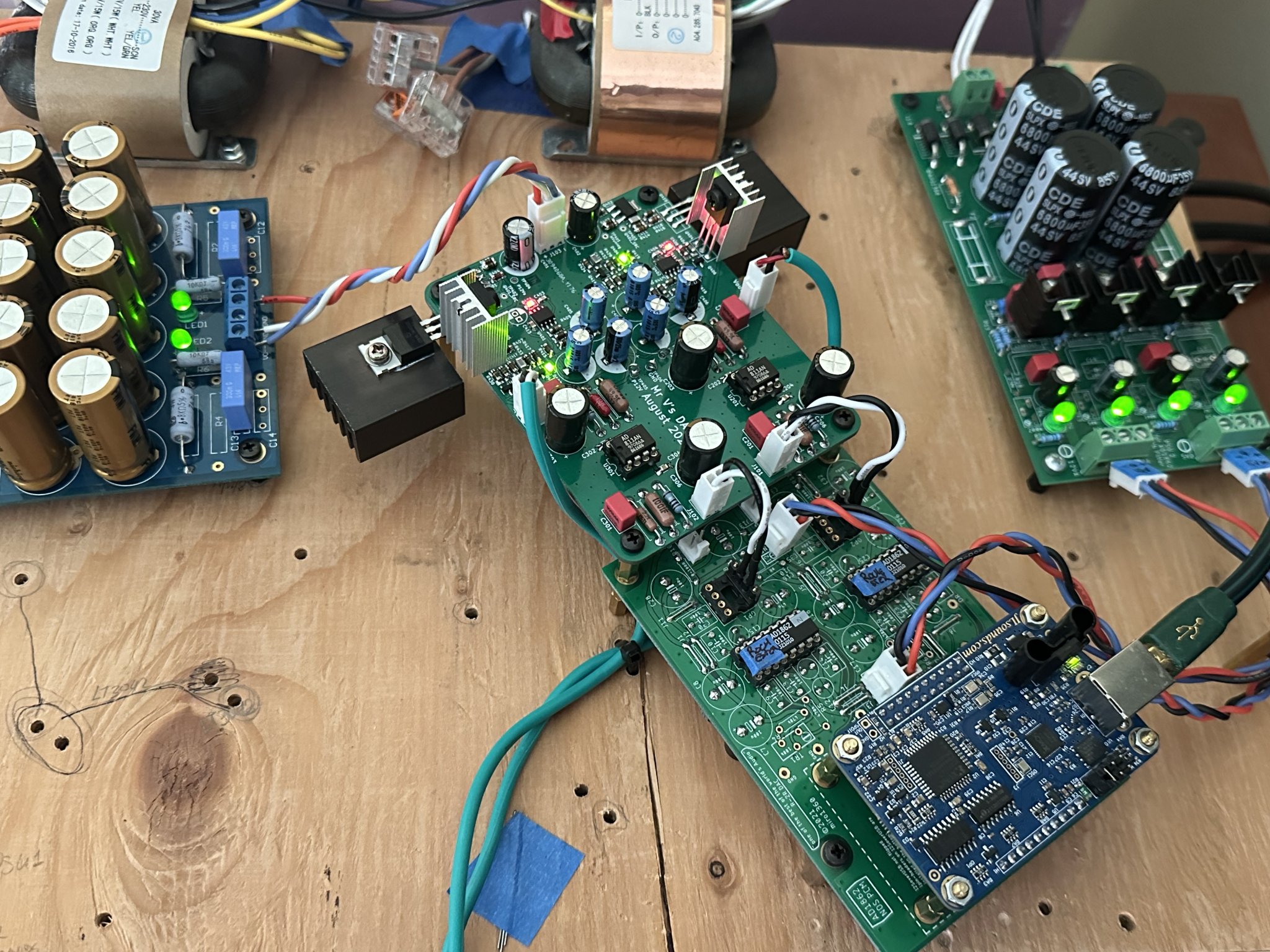

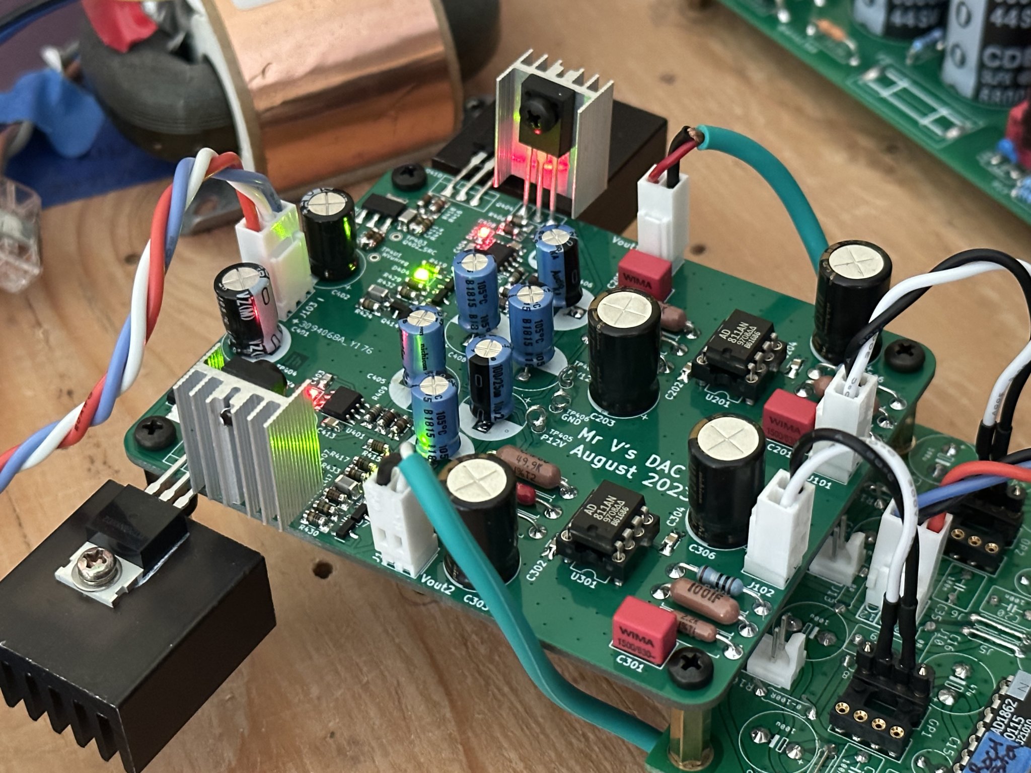

Well, I tried my best to stay content with my current MiroDac setup and resist tweaking……
But, the recent chats about using the AD811 opamp as IV kept picking away at me. So, with lots of help from my friend for the pcb layout this IV board is ready for some listening. The circuit is inspired by Grunf’s adaptation of Walt Jung’s shunt regulator/AD811 IV work he shared here and on other threads. (Thank you Grunf!)
After some listened time and more tweaking I’ll share the gerbers via PM to those that are interested😉
