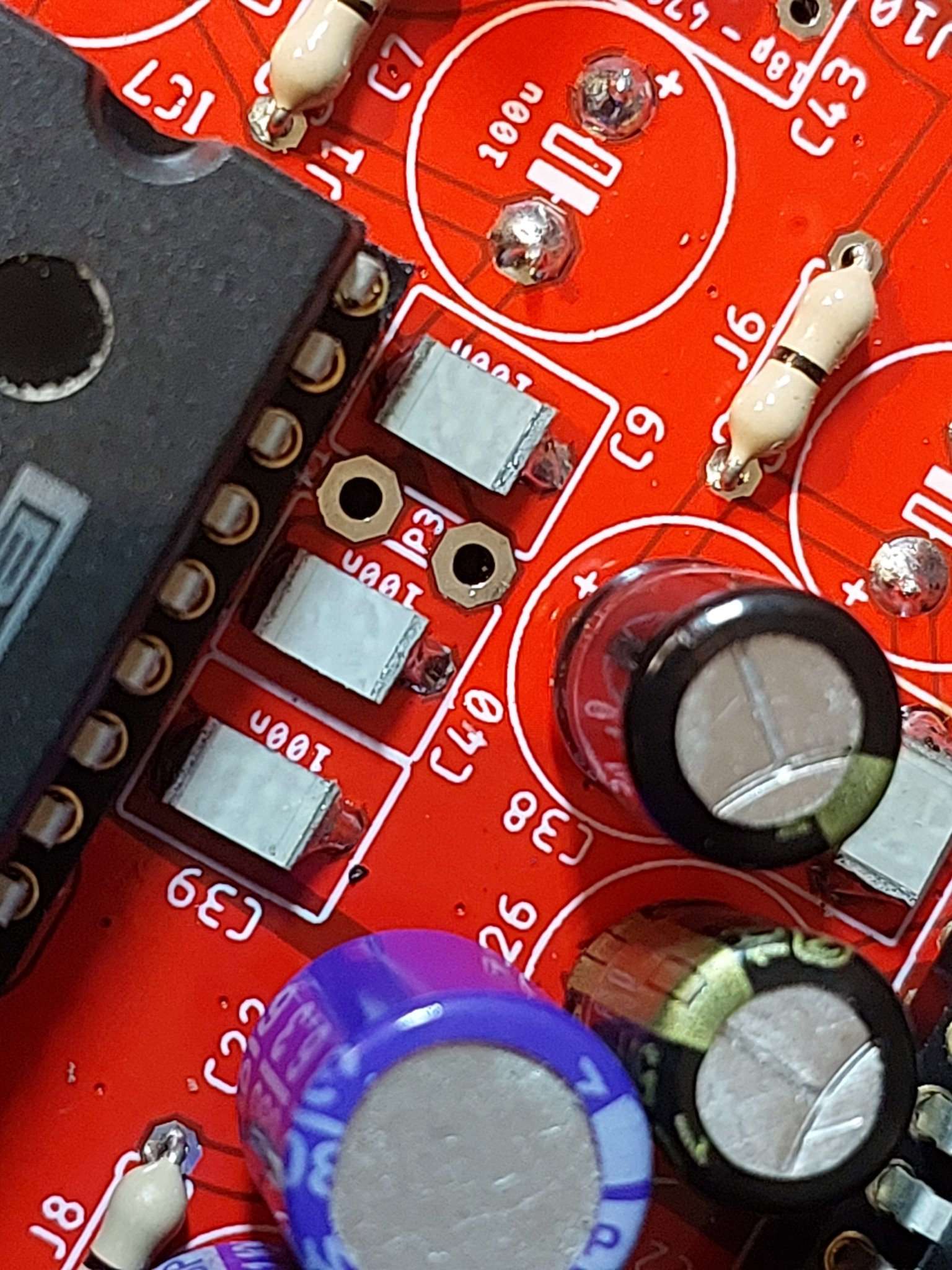

Yesterday I was soldered the diode and voltage is 4,2V. The cooler is hot only at the center (where transistor is installed). I didn't buy another cooler yet.
Maybe I'll do the same things with my another dac - add 5V on Jlsound but there is only one PSU-1 (no place for another one).
One more thing - I was told to add more np0 for feeding dac (opamps and chip). Is that necessary? Opamps 4-8(7) feeding leg and GND.

Acrylic from Rubicon is a little better than Panasonic, but a little bit more expensive.
But I can't guess where to use it in DACs.
These film capacitors are very useful where microfarad (>0.1-0.2uF up to few uF) range required for low (20-30v) voltages and small sizes. For smaller values NPO ceramic (up to 0.1-0.2uF) is better in the signal patrh and X5/X7 at the power.

My vote is for rubicon MU 👍🏻 But they are expensive at mouser and digi.
But, np0 are amazing little buggers too. 0603 for decouple, yes please 😁
