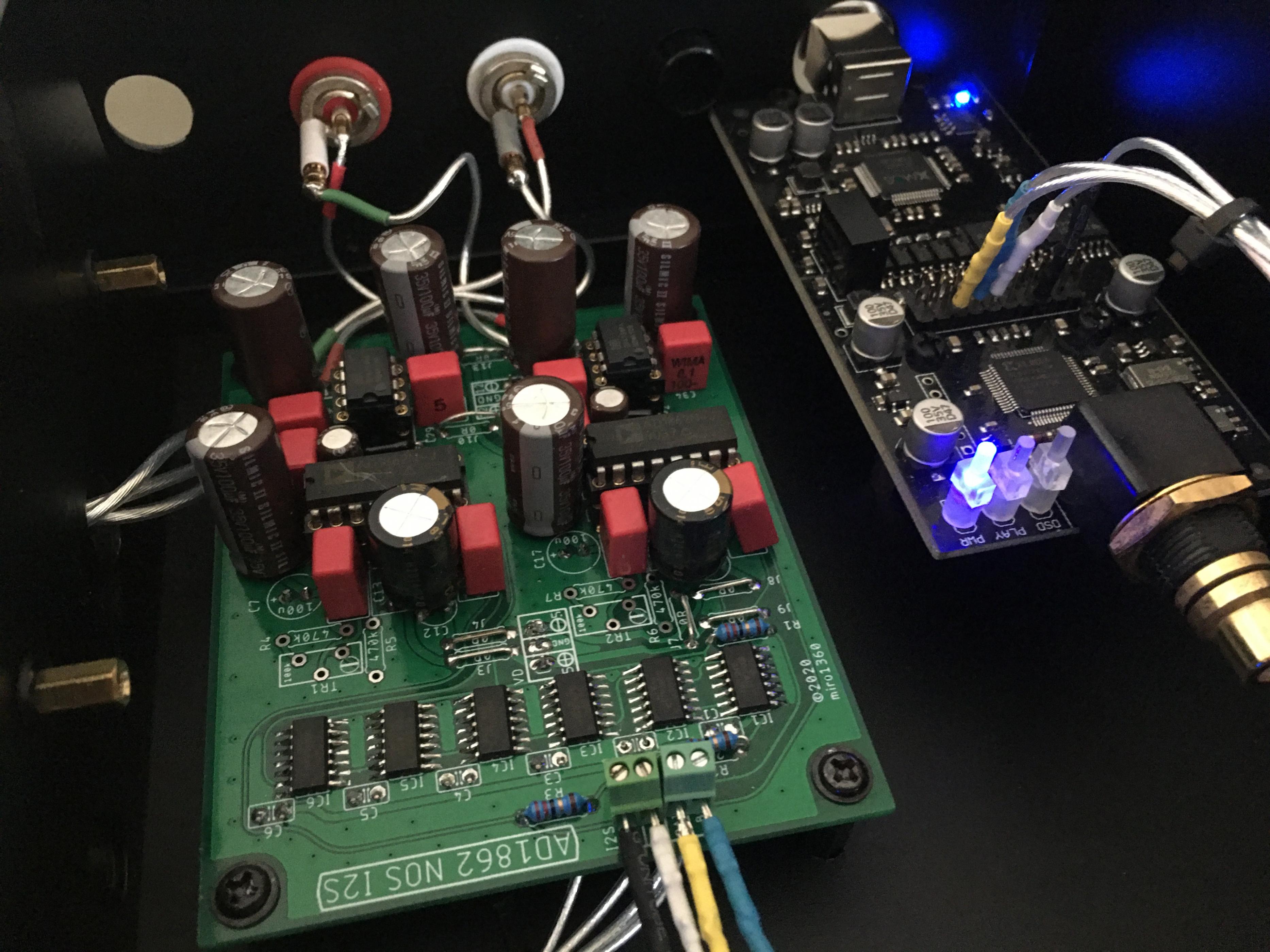

I am done!
Chip: AD1862 N-J.
Opamp: Muses03
Caps: Elna/Nichicon/wima
LPS: LT3045 for +/-5V; UCC GR opamp based regulator for +/-12V.
The first impression:
It sounds very natural.
It shows ample details and wider soundstage.
Very enjoyable.
Weakness:
The bass is a bit shy.
The output Gain seems a bit low; my volume control is usually set at 11 o’clock for my listening comfortably. Now it has to go to 1pm position.
Is it normal? Can/should it be remedied? Just a minor thing.
The Singxer F1 has Crystek clocks of 22 & 24 MHz. I guess that’s the reason it cannot playback my 24/384 hires files-extremely distorted.
Finally I upsampled everything to only 24/192. No big deal.
Opamp:
I have OPA134, LME49710 and Muses03 in my little opamp storage box.
All are single channel, so handy and save me money.
Opa134 and LME49710 both are a bit soft with weaker bass. I can Even hear some distortion in some music!? I am not sure but don’t like the feel.
Muses03 gives me the much better punchy bass, better dynamic and very musical.
The PCB is very tight for the oversize caps. Hahaha. I survived it.
I tried muses03 in my Whammy headphone amp but did not like it. I preferred Muses01. Now muses03 have a good home!
Overall I am very surprised this vintage dac still sounds excellent.
Thanks Miro and other members.
My other DACs: (all are wonderful dacs with different sound signature)

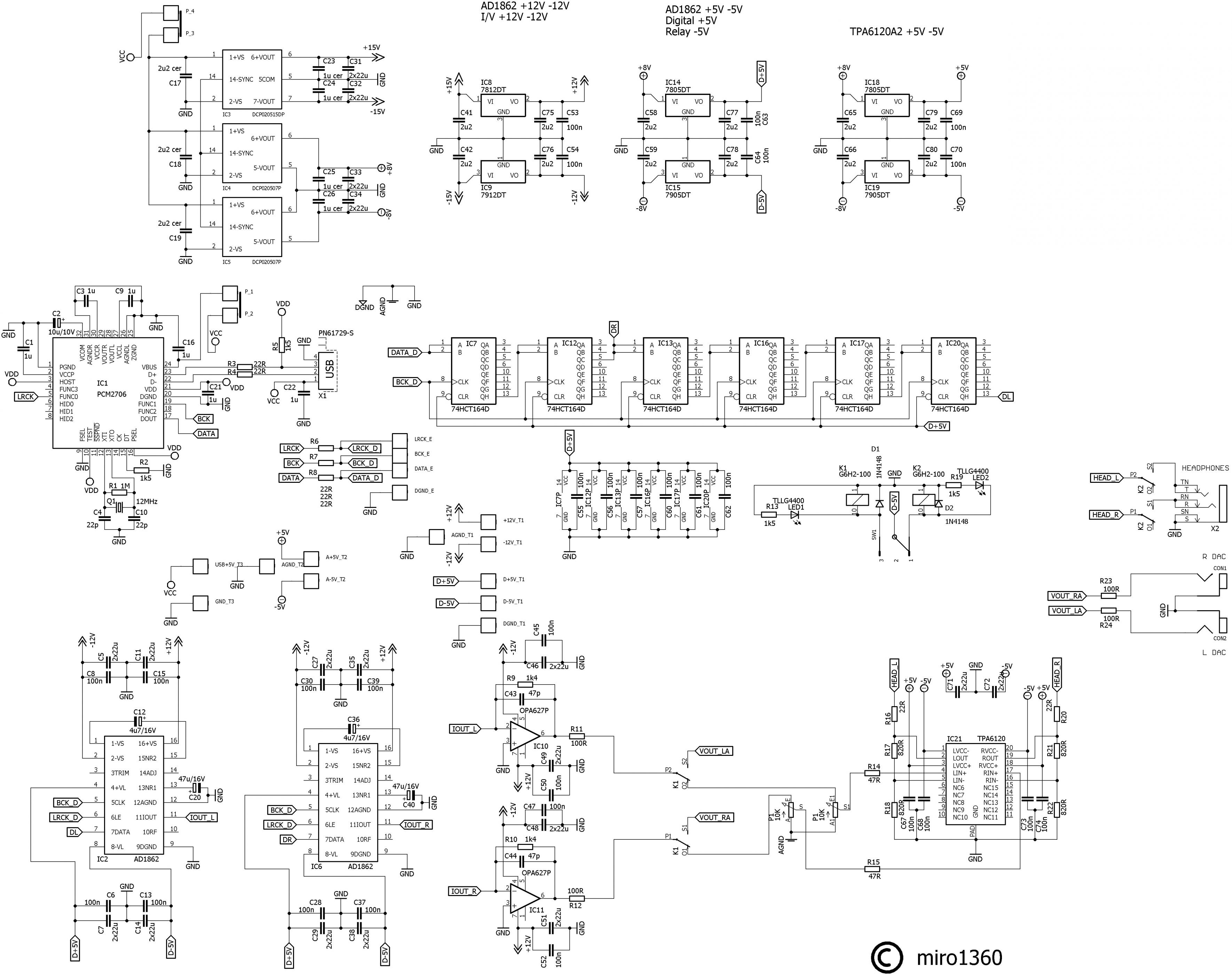

... I've had a lot of headaches trying to get PCM2706 to work reliably on my interface design. Eventually I gave up as a chip would work fine one day but not enumerate the next - I can only assume that the chips I was sold were sub-standard (aka fakes). Jitter measurements on fake chips aren't very useful. I've since changed over to CM102S which is a much simpler chip and only has S/PDIF output but if you're interested in jitter measurements for that I'll give it go. ...
Thanks abraxalito for your effort. My schematic for PCM2706 is 100% working:
PCM2706
CM102S is nice, cheap and simple. You can measure it. I am curious if it is less than 500ps

Awesome, how do you compare with Soekris 1021?
increase the value of R8, R9 ... it is related to the output voltage, try 2k something (2k4, or 2k7)
Do you think that this discrete opamp could be a good option for I/v?
DIY JE-990 DOA
Could It fit in this design?
Compared with a Burson v5, is it worth it?
DIY JE-990 DOA
It is simple and proven design, it will work
for adjustment to +-12V it will be enough to reduce some values in resistors (https://mnats.net/files/DIY.JE-990.DOA.V1A.pdf)
comparison is even questionable, because only a real test will confirm
for a good comparison it is ideal to have 2 DACs and switch between, or alternatively one DAC and each channel with different I/V and in the player slide the balance left-right
I haven't used Dam1021 for awhile. I will do the comparison later.
Thanks!
wonderful! I will definitely do it.
I forgot to turn off the system last night.
It sounds so much better this morning. Amazing!
