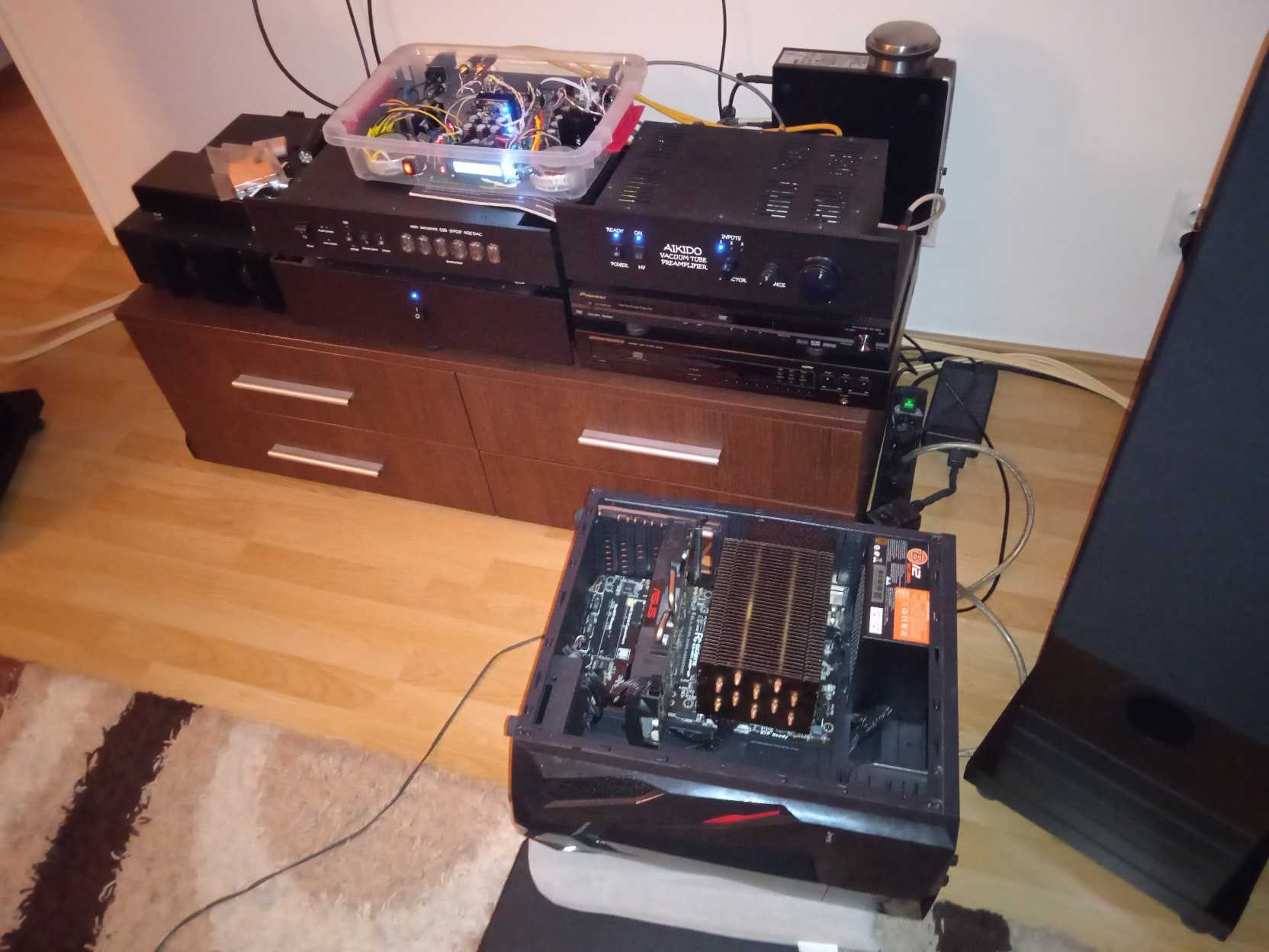

Yep. But it's still funny how the Mobo with the Muses02 works the same as the Miro PCM63P with the Burson V6CIt was like that, a few weeks ago. I don't know how ALC works, but you already upgraded your PCM63, so it's not the same.
https://www.gigabyte.com/Motherboard/GA-H81Amp-UP-rev-10#ov
That was strange, completely different PCs, different DAC chips, different principle of D/A conversion, there OPA Muses 02, here Burson V6 Classic and it sounds the same 98.7%. 😵

Yes it is possible, but digital ICs should not be installed (IC1-IC13) ... or at least IC11 and IC12 should not be installedNever mind, I figured it out. Leave all jumpers open for I2S output into the shift registers of Miro's board. It works.
Miro, is it possible to drive the TDA chip directly from JLSounds?
Thanks!
For connection read the jlsounds manual, or like this:
B1 = open
B2 = open
B3 = close
B4 = close
B5 = open
J2 = close
J3 = open
J4 = close
H1.3 connected to H1.1 with 4k7 resistor
pin 9 = DR
pin 11 = CLK
pin 13 = DL
pin 15 = LE
pin 12 = GND
(DR, CLK, DL, LE are marked on the pcb - near IC11 and IC12)
Powering the jlsound, either read manual or use default:
H1.1 to H3.17; and H1.2 (GND) to H3.19(GND)
They are certainly not fakes, and if they work, you will let us know, I guess. 🙄 ... 🤣I just cannot resist it and took the risks. Hope they are working chips🤣
Thanks Miro! I got it working okay. I have the newest FIO board and it’s config is slightly different from the older ones.Yes it is possible, but digital ICs should not be installed (IC1-IC13) ... or at least IC11 and IC12 should not be installed

I do see the markings on the pcb. I guess I could try bypassing the shift registers but have other things to solve first, like a totally isolated and separate supply for the JLS board.
Thanks!!!
Separate galvanically isolated power supply for the XMOS part of the JLS card. The second part of the JLS card should have a a separate power supply and a connection to the DAC GND. These power supplies must have two separate secondaries.
So, you are saying use two supplies: one for usb portion and one for clocks, correct? And tie the clocks ground to dac gnd? Wouldn’t that be through the i2s lines? Each one has a gnd connection and they are all tied together on the TDA board.
My plan is to build at least one supply first for the clock portion.
That's right, one power supply for the USB part and one for the oscillators. There is a galvanic separation between them, if you have only one power supply for both parts, you do not have a galvanically separated PC from the DAC. The oscillator part is grounded through the I2S connection on the DAC board. There is no need to make another GND connection because it is a ground loop.
That power supply for the USB part, if you want to keep the galvanic isolation, must have a separate secondary on the transformer. That part is grounded to the chassis via a 100nF capacitor, it is preferable to have AC GND for high frequencies, but it is not mandatory.
Only one power supply for the oscillators is possible, and the USB part is powered from the PC. But it is best to have both separate power supplies, because the quality of the power supply from the PC is not great, there is usually a lot of noise.
JLSounds board now working with two independent regs, one for usb and other for the clocks. Sounds much better. Earlier I found it to be bass heavy and somewhat harsh, which was surprising considering it is driving the TDA1541. It appears it is sensitive to the USB supply as much as the clocks supply.
The regs I am using are simple LED mosfet followers, where an LED string on the gate is used to set the voltage out.
JLS has voltage regulators on it, but it is audible when you replace the PC power supply with a better one. We used the LT1963 and LM1117T with equal success. I mean everything is heard no matter what you change. 🤣
Or remove. I removed 22R resistors. You can hear the difference.🤣I mean everything is heard no matter what you change. 🤣

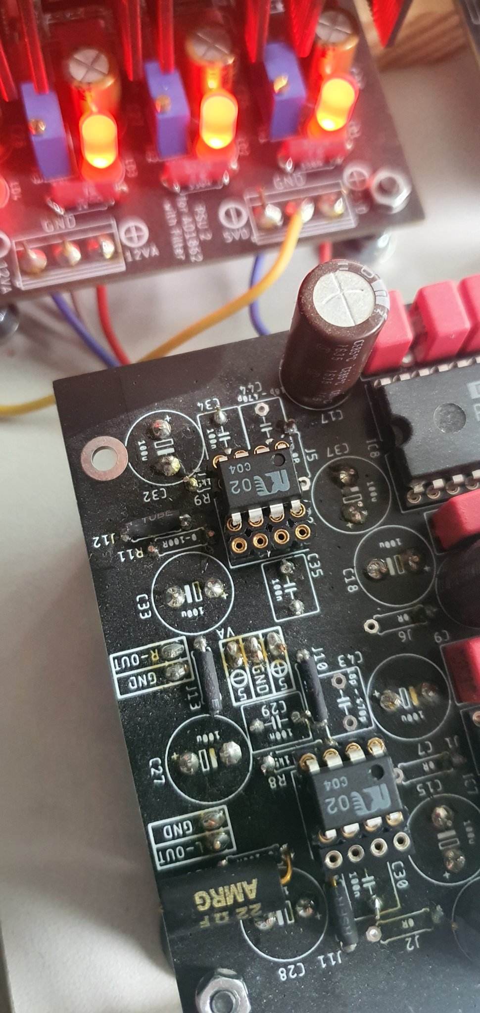

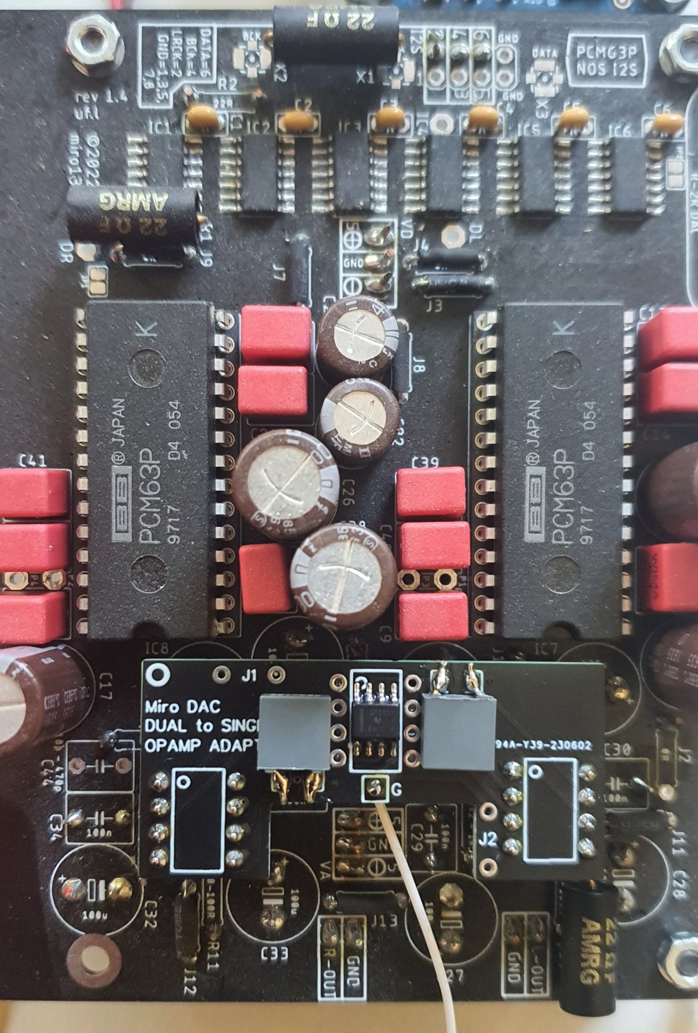

Adapters came 🙂 I've put my favourite mass produced op, opa1656, to test it out. All is good, works well 🙂 I've put film instead of smd, simply cuz i didn't check my stash, there are none left in values required 😅
I've also designed adapter for dual to mono if someone prefers to use double on single socket. I've tested it by making p2p version. Works well as well. Mikorist has some on the way in pcb form, so we wait for that.
