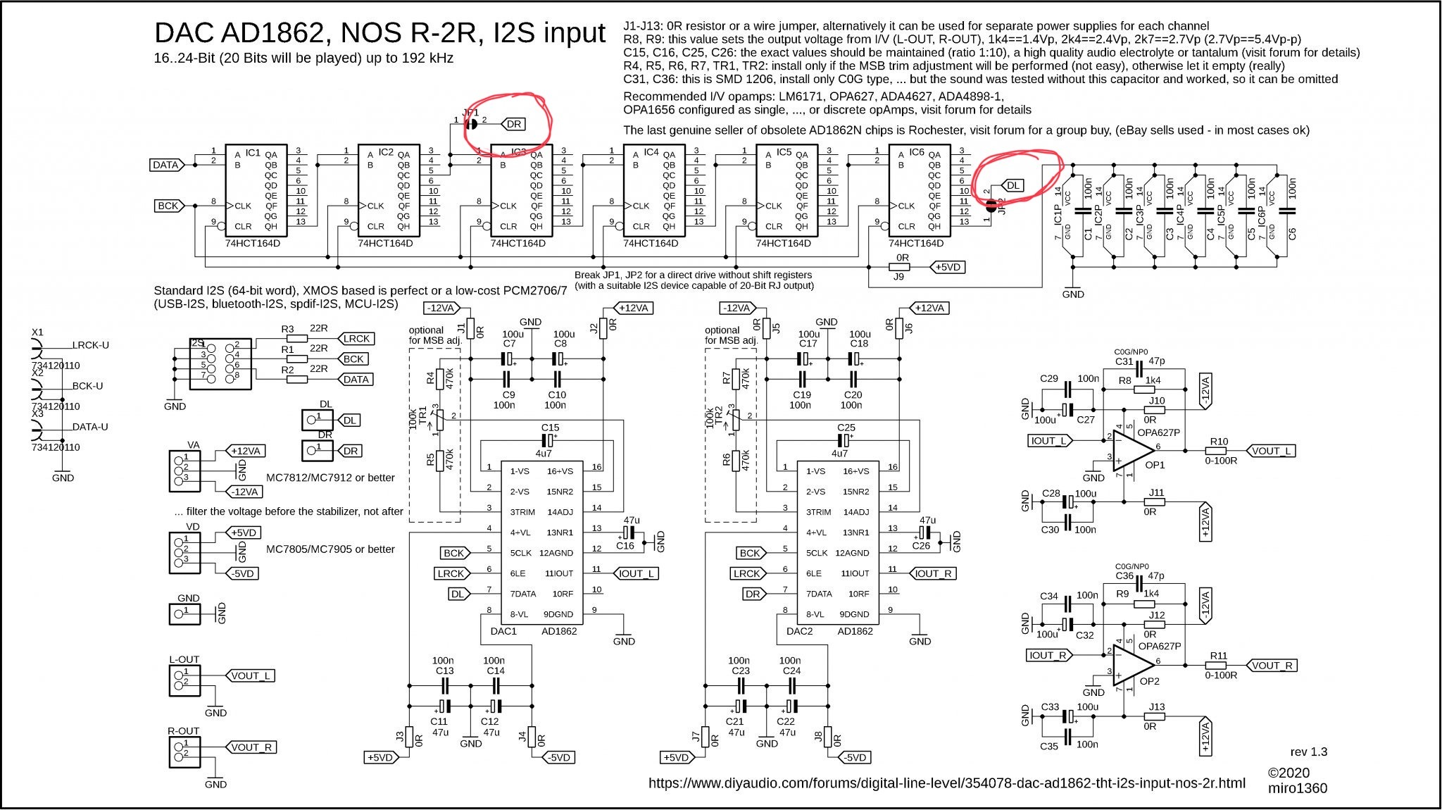

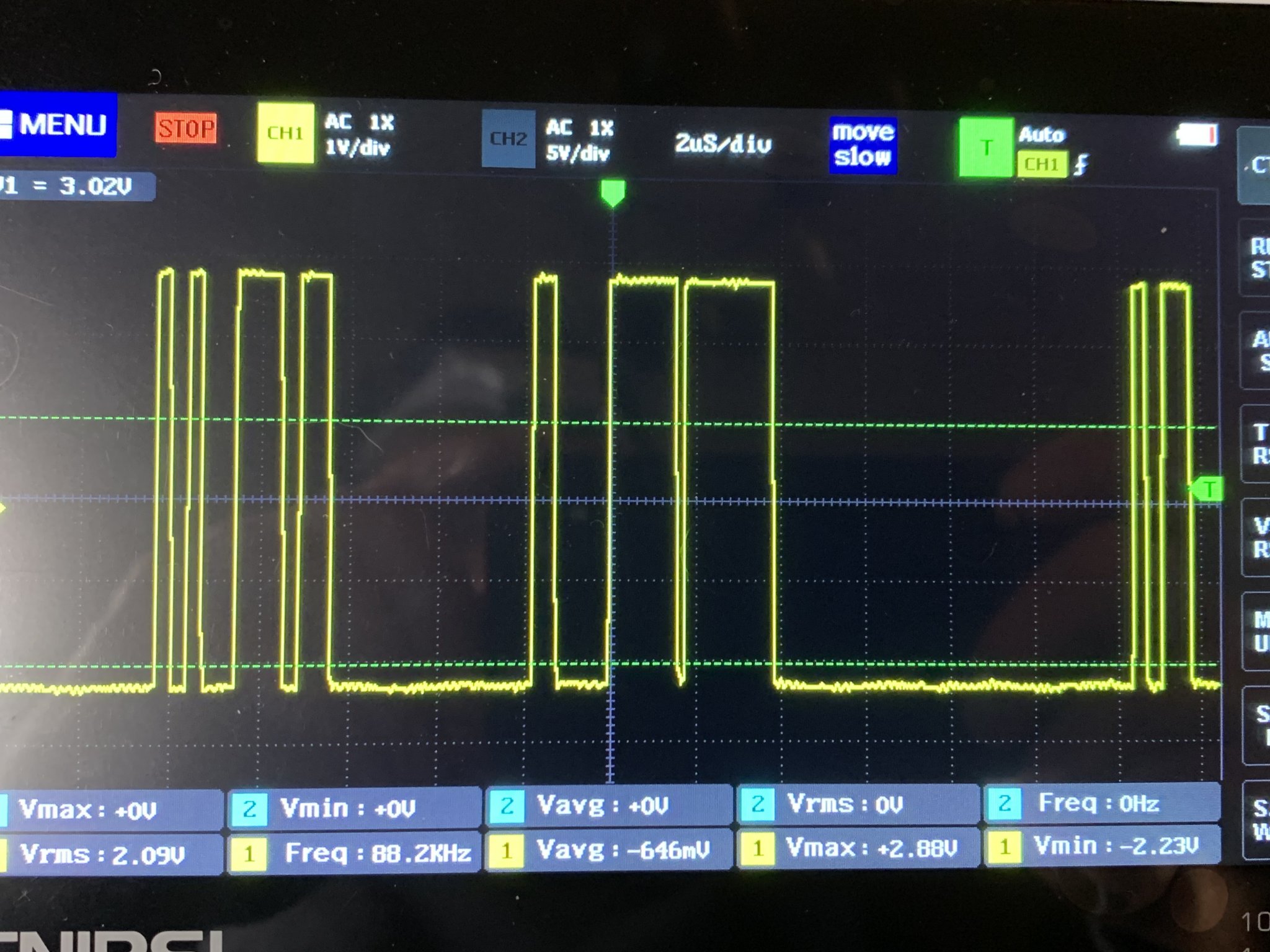

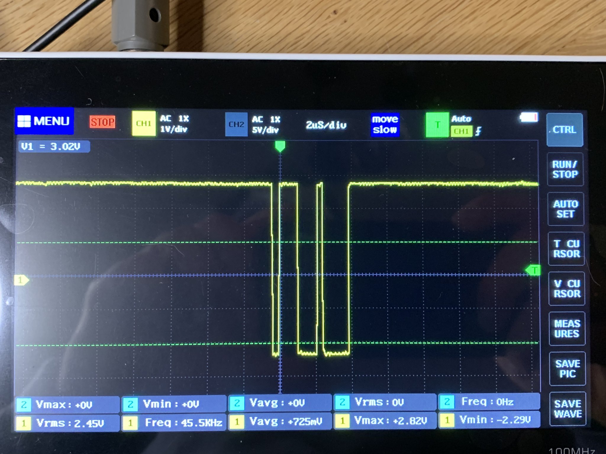

Hi guys,
I was able to successfully obtain the i2s signal from JLSounds v3 on the AD1862 board and observe it on my scope at dl and dr points after passing it through shifts.
After reinstalling the DAC and OAMP chips, I played a 1kHz signal, but unfortunately, the graph on my scope appeared to be quite chaotic.
Instead of hearing the music, I noticed a distortion that sounded quite digital with sharp peaks. It's difficult for me to explain the distortion any better, but it's worth noting that when I stop the music source, the distortion also stops except for those sharp peaks.
I'm curious to know if anyone else in this thread has encountered similar symptoms. I wasn't able to find anything related to this issue other than THD-related discussions. Any insights or suggestions would be greatly appreciated.
Thank you!

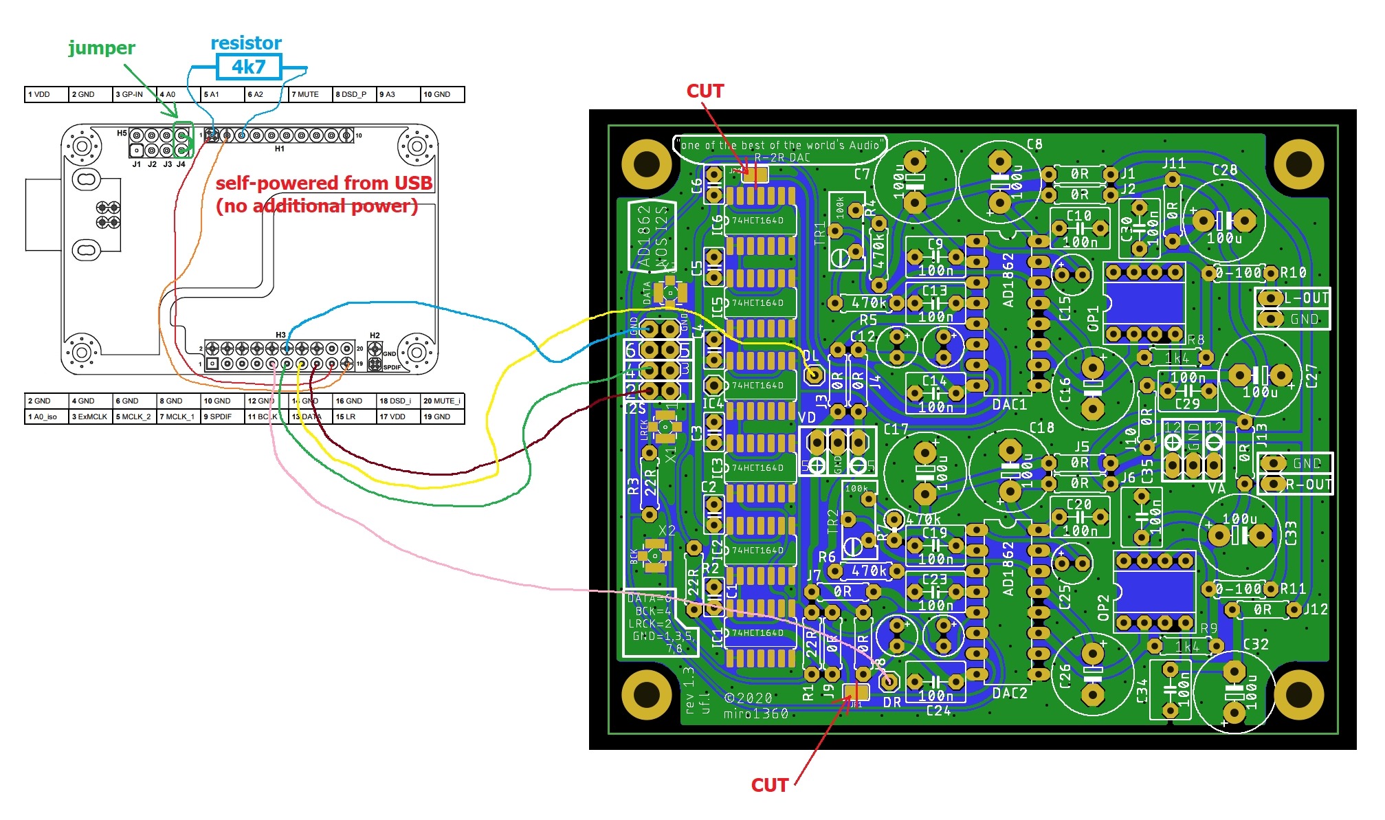

@Vavilen It can be anything. People have often trouble with the SMD shift registers.
Since you have jlsounds v3, you can bypass these registers: cut the JP1 and JP2 and use pins DR and DL for connecting jlsounds directly.
Here is the connection diagram (jumper J4 is used and resistor 4k7, usb self-powered configuration)

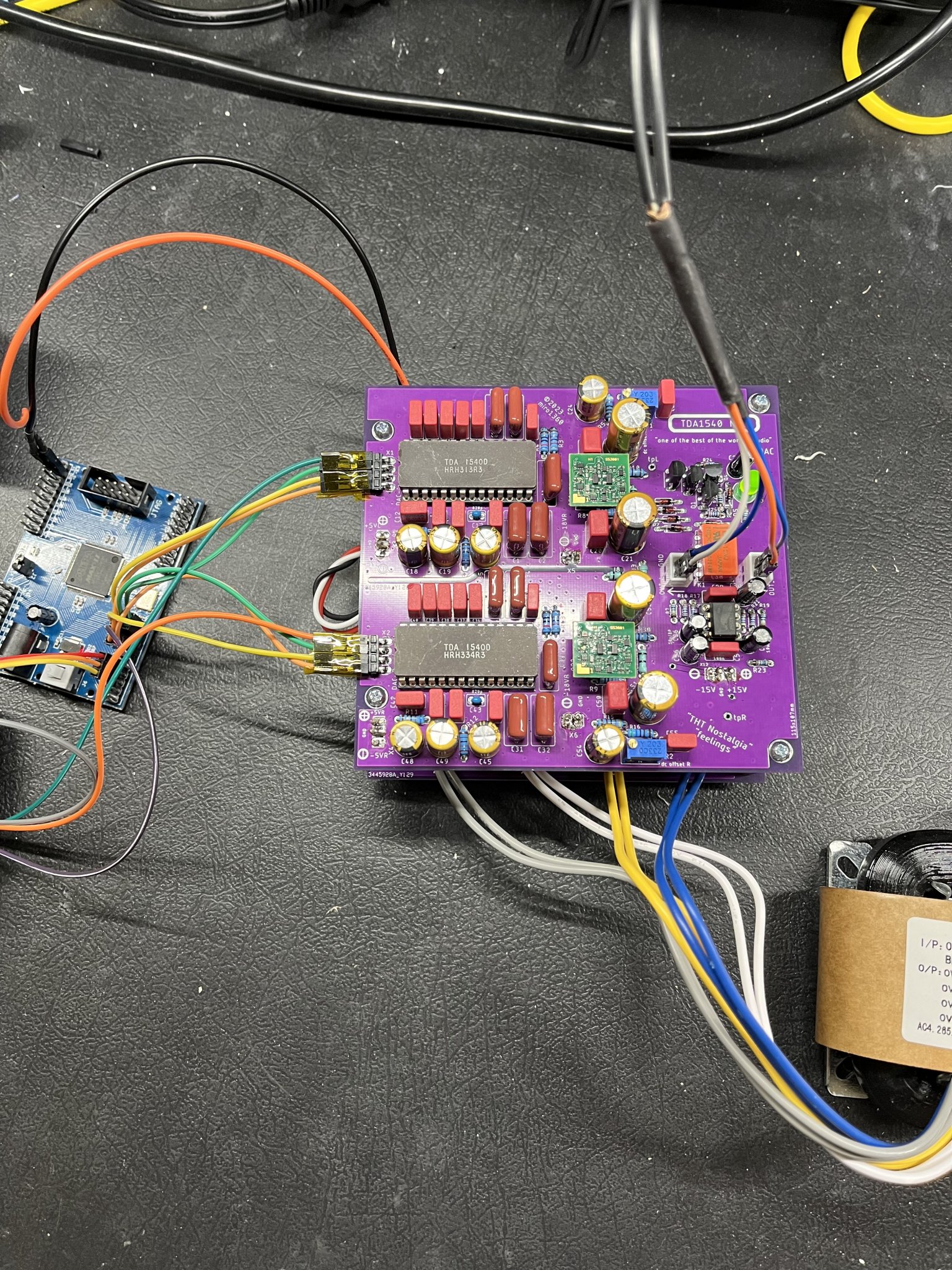

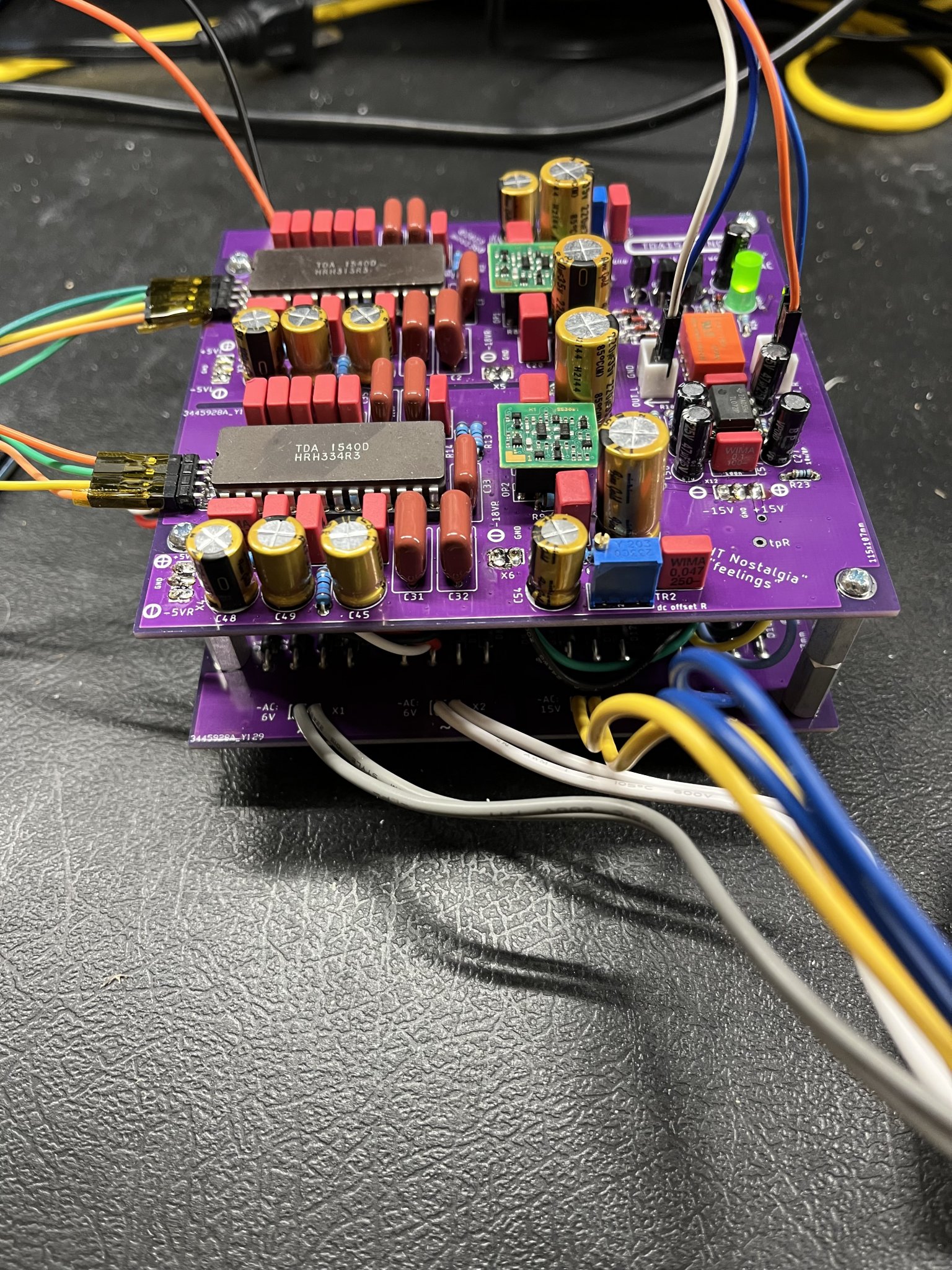

I finished my build of @miro1360 TDA1540 DAC yesterday and can confirm that she sings beautifully! As with all Miro DACs the build was straightforward and the instructions on downloading needed software and programming the CPLD board worked first time - no issues. I ended up stacking and permanently wiring the PSU and DAC together as this will be my workshop DAC. My initial power on test was with LM6171 opamps, I later swapped them out for the Sparkos.
One thing I noticed is that if the CPLD board is not properly grounded it will introduce a lot of white noise alongside the audio, so if you encounter that, make sure everything is grounded together really well. For those that might feel a little intimidated by the CPLD approach, don't be! As long as you follow Miro's well written documentation you'll be fine.
Below are some pictures of the build hooked up to my test system showing the CPLD board feeding the DAC and another showing the DAC and PSU stacked.

@psmith001 beautiful boards! I am still waiting for the delivery of my parts. I have done programming of the cpld board and yes, with Miro's tutorial, things are easy.👍
@psmith001 Nice build and thanks for your experience and confirmation of the working state

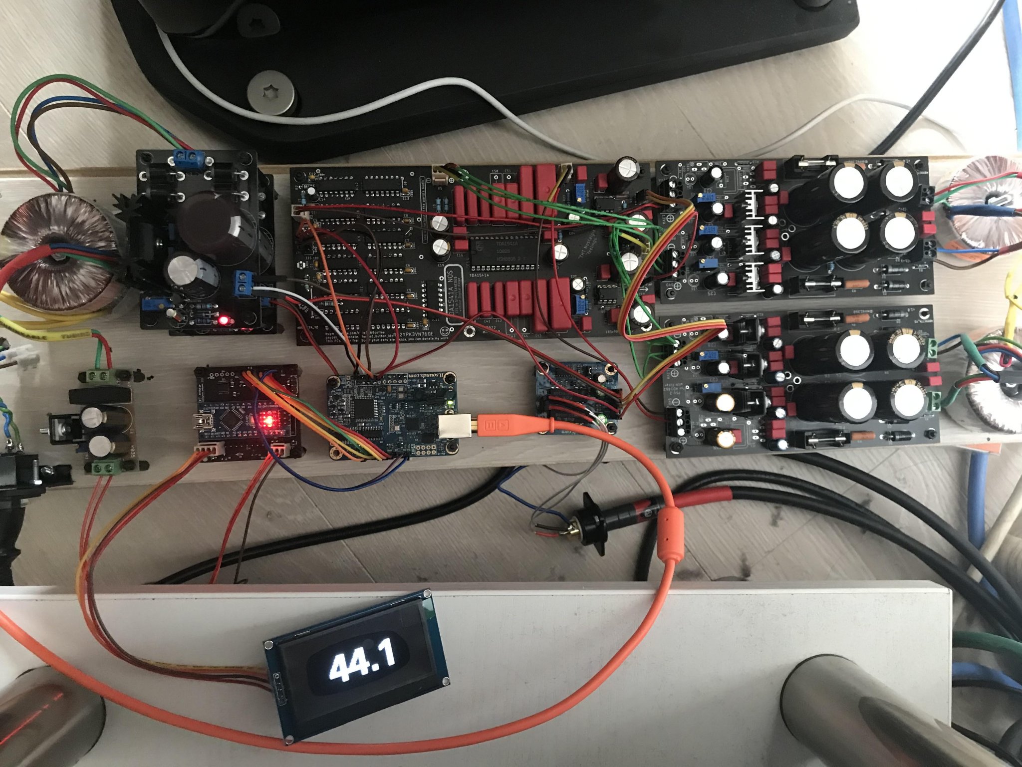

Congratulations.Here is my TDA1541 DAC.
I see JLS I2S over USB, but also some display and display driver board. Can you tell me more about the display and the driver board?
- Digital Line Level
- DAC AD1862: Almost THT, I2S input, NOS, R-2R
