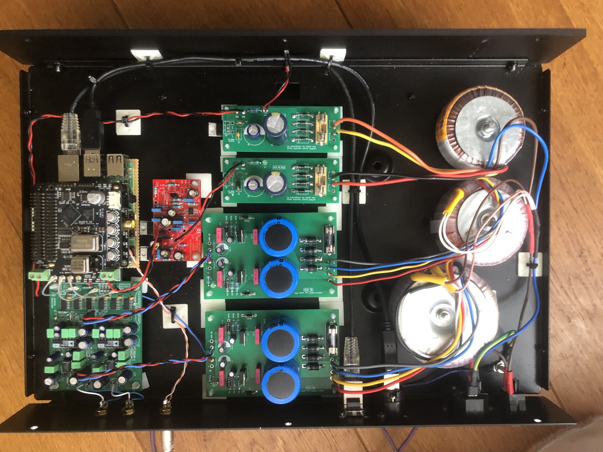

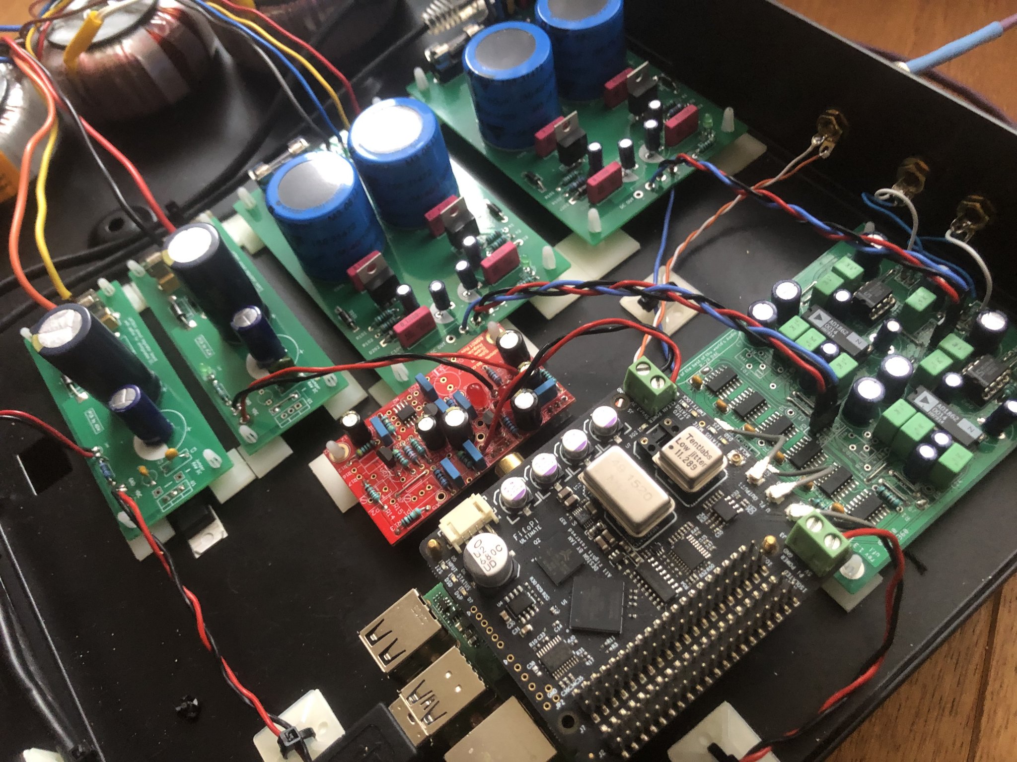

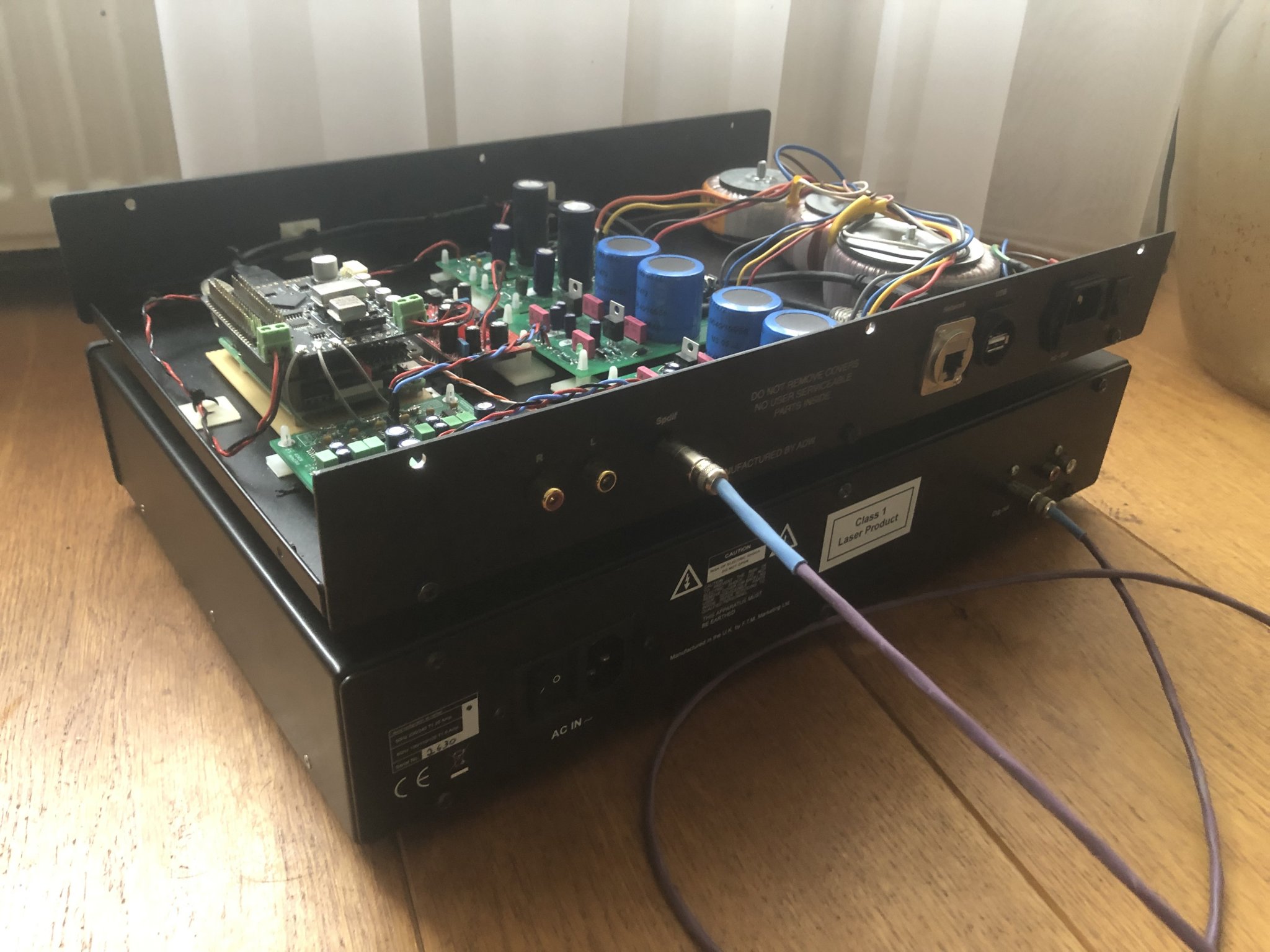

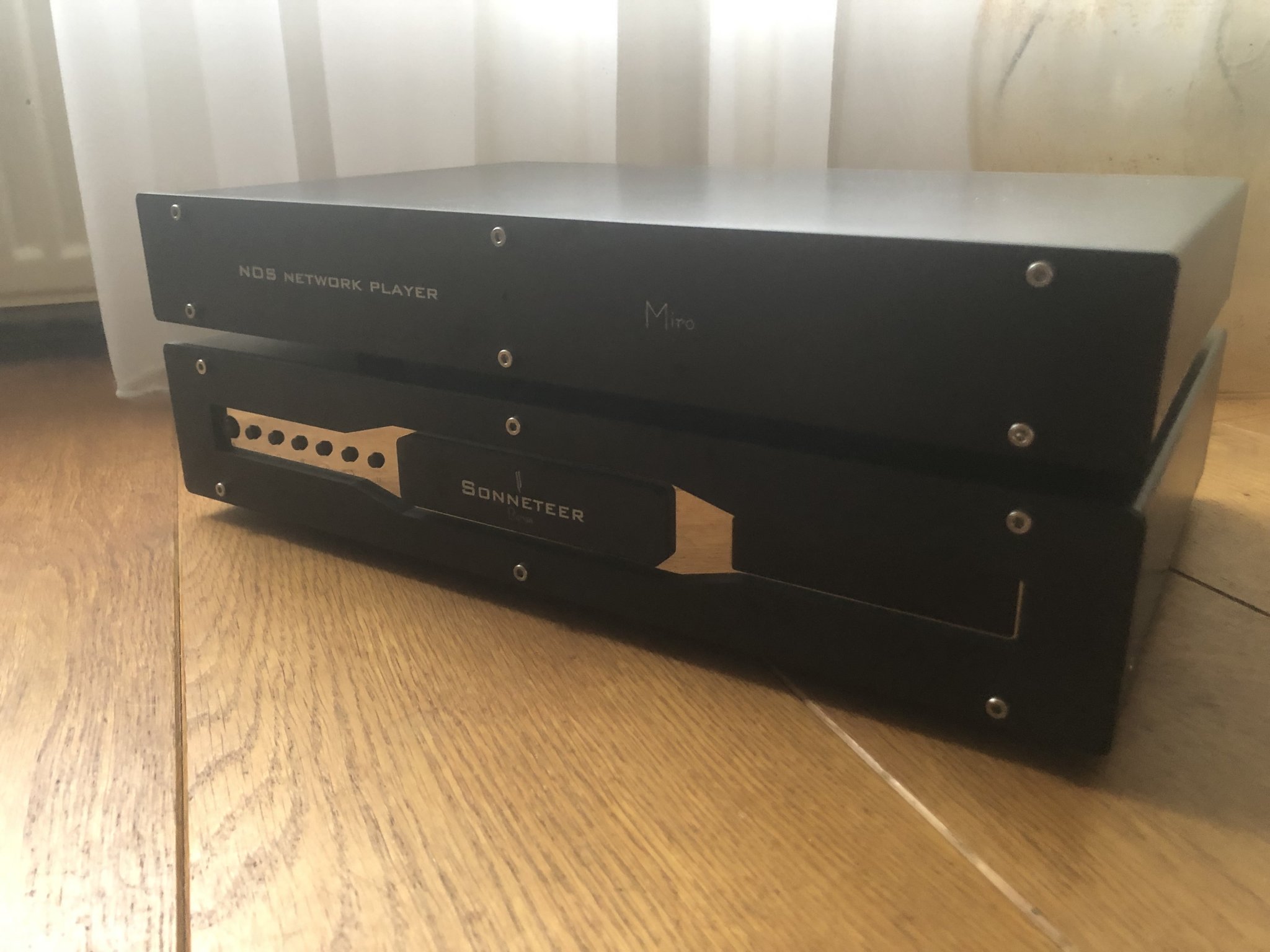

Another AD1862 build. I don't use "hifi" parts but just high quality brands/components i had lying around. I have a Sonneteer Byron CD player whitch i wanted to use as a transport. I used an old molested Sonneteer phono chassis and anodized the faceplate again, new laser fonts, new rearplate and fresh powdercoating.

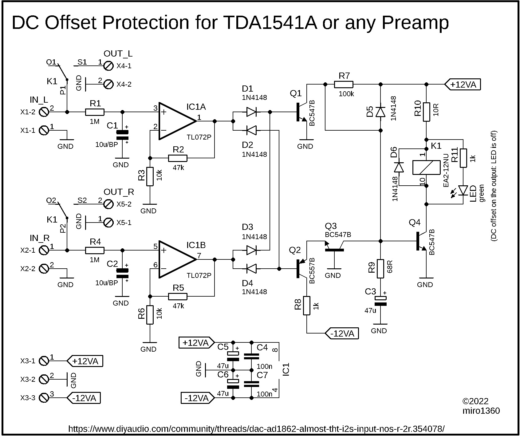

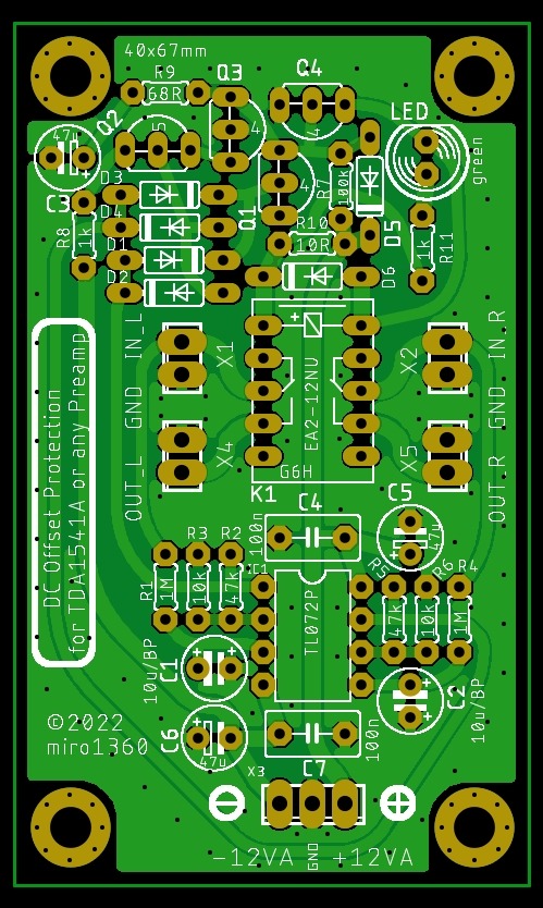

Protection against DC offset voltage on DAC or Preamp output
It is definitely not needed for DACs like AD1862, AD1865, maybe PCM63? Because they have zero DC offset even if the signal source is not turned on.
TDA1541A is another animal and when the signal source is turned off, then a DC offset appears on the output. It has some internal biasing and most manufacturers used audio capacitor in the signal line to prevent this DC offset on the output. I am not a fan of coupling capacitor because it colors the sound 😏 I assume you won't use it either, so the correct power-on sequence for the TDA1541A is: first turn-on the source and then turn on DAC TDA1541A).
If the input signal were to be disconnected for some reason, an DC offset would appear at the output due to the missing output capacitor. So it would be good to consider one of two options: Either install a high quality audio capacitor on TDA1541A DAC output, or use this DC protection on the output like I did.
This DC protection is small, cheap and very simple. When the protection is kicked in, the LED indication is off (the relay is disconnected).
IN_L + GND and IN_R + GND connect with DAC outputs.
OUT_L + GND and OUT_R + GND are now the protected outputs.
Power up it from +-12VA directly from DAC. If you power-up it with higher voltage (max. +-15V) then change R10 to 330R.
Reset time is set by R9+C3 = how long will be the protection off after DC voltage disappearance. If a faster reset is needed then lower the capacitor value.
Reaction time is set by R1+C1 and R4+C2 = how fast it reacts on DC offset presence. If a faster reaction is needed then lower the capacitor value.

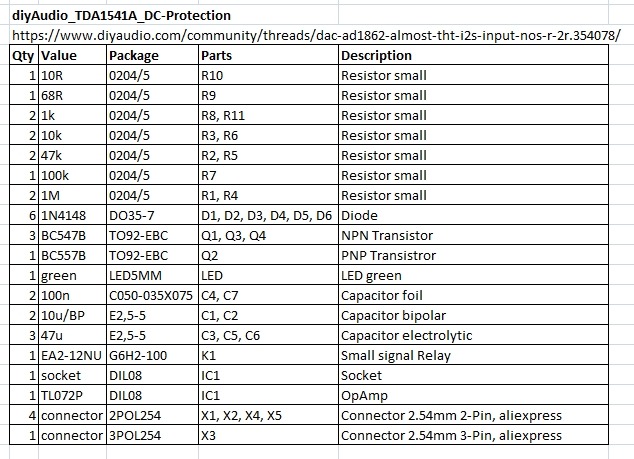

BOM example:
https://www.mouser.com/ProjectManager/ProjectDetail.aspx?AccessID=b9874b7786
(the small relay is again not stocked, use this alternative: 551-EA2-12NJ)
