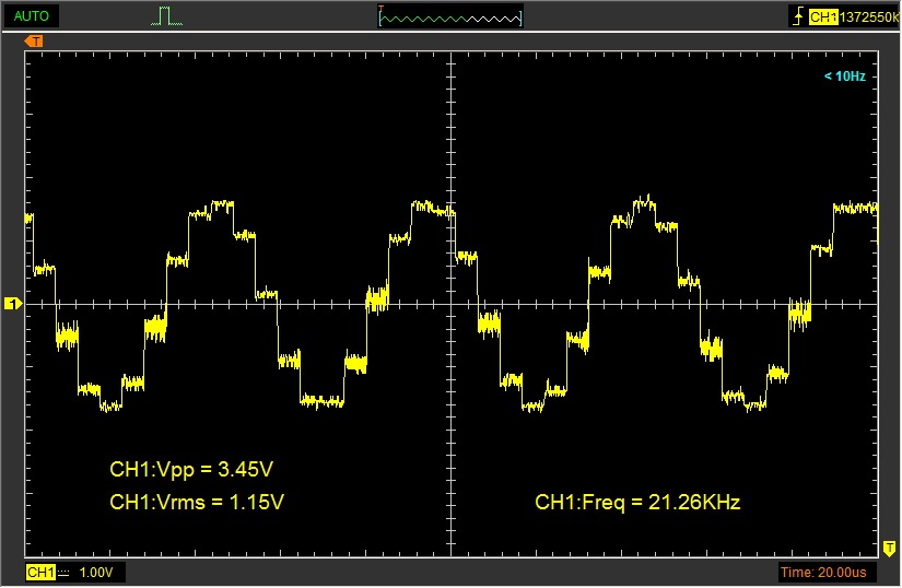

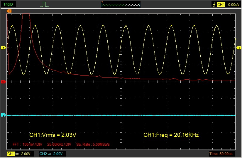

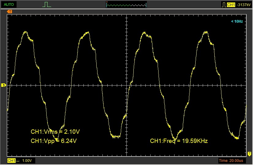

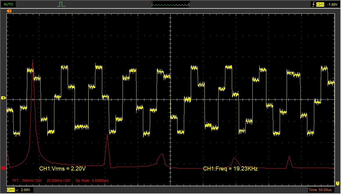

I have an online generator and a USB oscilloscope 4x250MHz at my disposal for measuring DACs via USB connection. Generally, I cannot conclude based on these measurements how something will sound. I can see the frequency range but only up to 20kHz due to the limit of the online generator, then how it reproduces the various signal forms, whether the output signal is in phase and how much noise there is. I can, but quite modestly, measure THD as far as the FFT on the oscilloscope allows. Mostly, listening is crucial.
I can measure other devices (amplifiers, preamplifiers, transformers) using the 20MHz generator in the HANTEK 6254BD oscilloscope. And that's it, enough for a modest amateur measurement. It's small and compact enough so it doesn't clutter up my house.
USB connection, online generator, signal is sine 20kHz (24bit 96kHz),
First picture is Topping D10S, second is Pavouk AD1865.
Which one do you think sounds better?

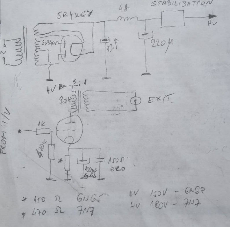

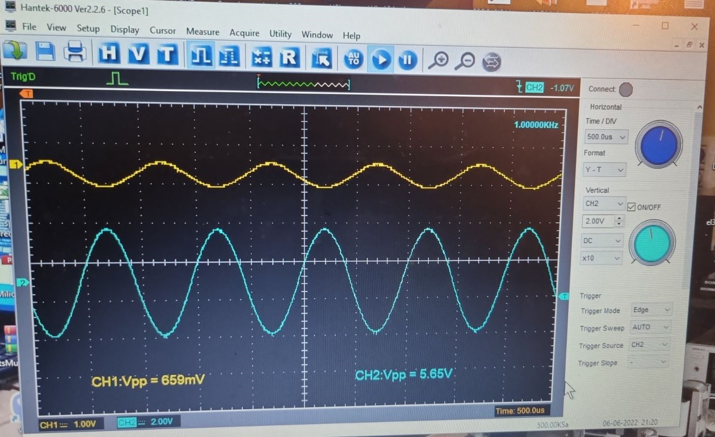

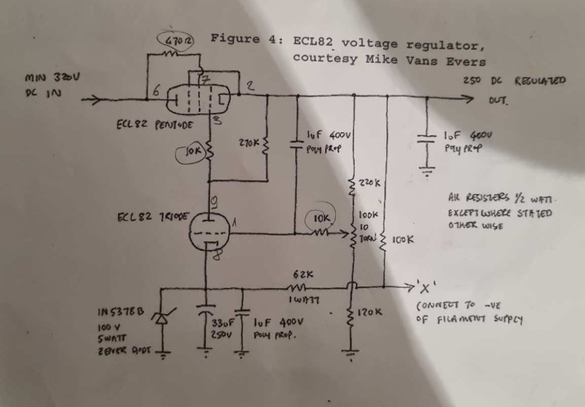

I just dont see the point of putting pictures only. Without some schematic and very simple measurements - against full-mouth "sound explanations"
Here is schematics and voltage gain of tube stage.
