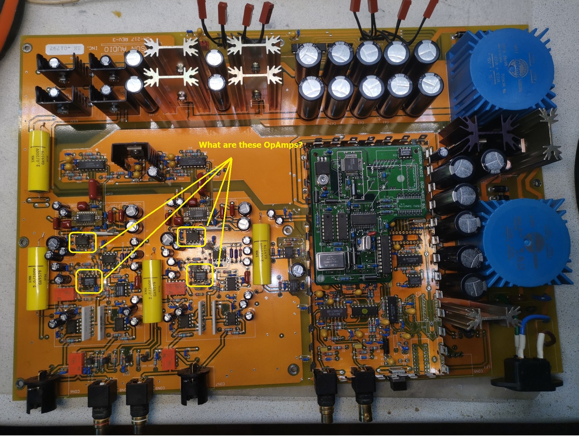

Dodson 214 mk2-d uses PCM1704 as DAC. Can you check and tell us what are the OpAmps in this device? Especially the one OpAmp next to the PCM1704 chip.
Sorry Miro, no. I was already returned the device to his owner. He asked me do not open the device. I was visiting at last year and we together listening Wadia 15 and this 217mk2. 217 was definitely better. Acoustic - B&W 802.@sworder84 Definitely play with different OpAmps. For more colored sound try OPA134

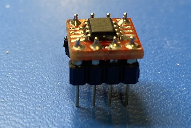

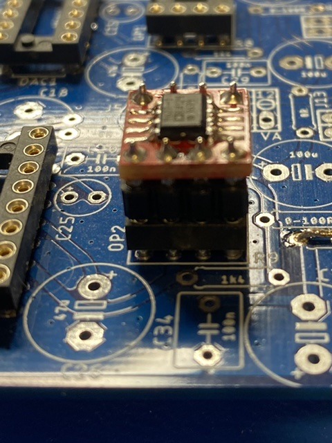

Finally got around to replacing the lm6171 opamps. I soldered up some 797 brz and am just now listening. The scratching issue is gone. I will continue listening and update with an impression. Initially the sound stage is improved and very much like the lm 6171. It seems odd that the 6171’s were creating this issue. I’m a bit disappointed with those as I’ve not really had a chance to evaluate them.
Well thanks for your help, it is very much appreciated
Yes it’s possible. When ordered a dip package lm6171 was not available. So I used soic with an adapter which does put the opamp almost 1/2” above the pcb. I couldn’t find anything that was closer. I saw a post that talked specifically about that but turned out was not an issue. But I’m not sure that configuration and mine were exactly the same.
At this point the 797 opamps haven’t shown similar issues. I do have an order for some lm6171 in dip package along with the correct socket. I will try them but overall distance from pcb doesn’t look like it will be that much different
We’ll see.
We’ll see.
Well it seems the scratch has returned. So perhaps the soic package is not ideal. That’s not to say it couldn’t be something else entirely. I will continue searching.Yes it’s possible. When ordered a dip package lm6171 was not available. So I used soic with an adapter which does put the opamp almost 1/2” above the pcb. I couldn’t find anything that was closer. I saw a post that talked specifically about that but turned out was not an issue. But I’m not sure that configuration and mine were exactly the same.
We’ll see.

Some ideas meanwhile the dip8 arrival :
Check the JLsounds I2S set up at its the bottom as per what has been explained in the thread.
The traffo seems far enough but try to put a tin above to reassure you about coupled field.
Does the streamer does not upsample all your material, check if the same clicks occur at different sampling speeds : 44khz to 388khz.
Check also with magnyfing glass around the registers and their caps if it is clean. Idem around the jlsounds and the dac pcb...
Certainly the oaps but who knows, it costs nothing to check.

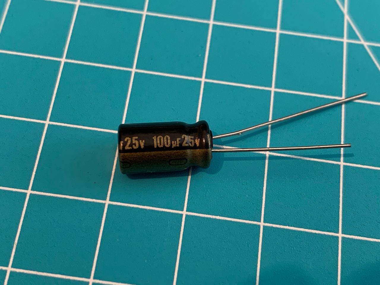

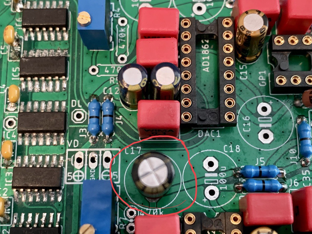

Hi guys!
I bought the Nichicon (UKW1E101MED, Aluminium Electrolytic Capacitors - Radial Leaded 25volts 100uF 20%) caps for C17, C18, ...
It seems that the caps have to be bigger (see my DAC plate pic).
Did I buy the wrong caps? Or can I use it?
Thanks!
Thanks!
C17 and 18 have -12V/+12V on them and your caps are rated 25V. You can use caps that rated beyond the operating voltage but not below.Hi guys!
