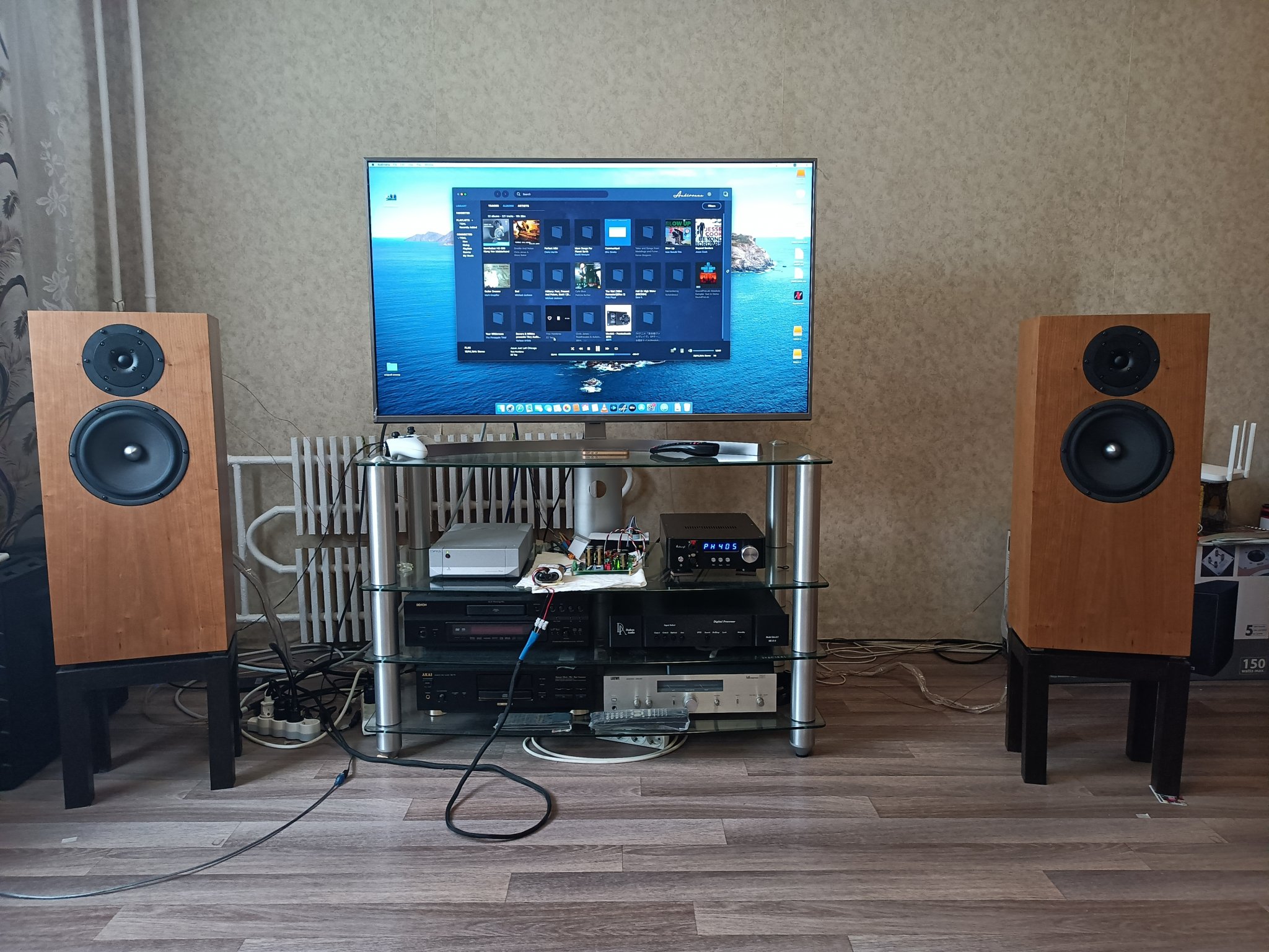

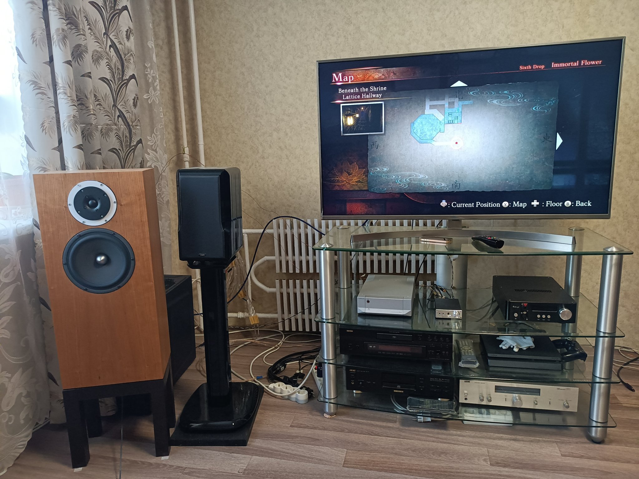

I have a different sources:
Amp - AudioGD NFB-1 + Cyrus Smartpower Plus, Loewe 6391
Different cables - Viablue (interconnect), Fudjikura (power), cooper wire in varnish - acoustic cable
Acoustics - Heco Victa prime 302, Chario Lynx, Diy on Excel's
Diy acoustic have case from Audio note AN-E (with original partitions and made by birch plywood). I want a beryllium twitter in future. Crossover made with Jantzen Air Core wire coil and Mundorf Supreme caps. E0045 also with Mundorf E-cap.
Everything is quite modest
Sometimes I take different devices for listening
- Akai CD 79
- Denon 3910 DVD
- Fx audio DAC X6 (mod)
- PC on Mac with Audirvana

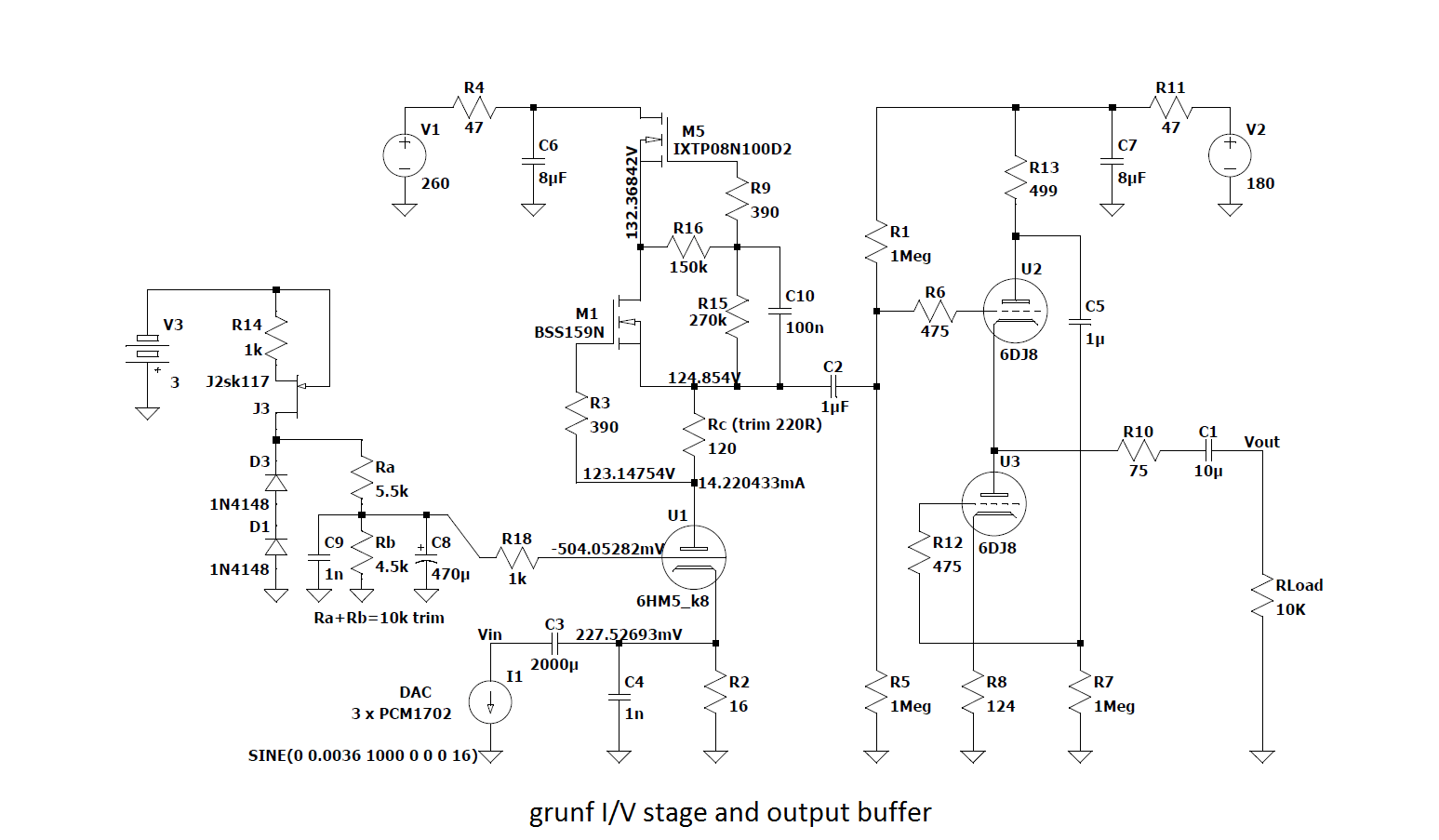

Hi grunf,
I couldn't find the attachment.
Can you attach it ?
Thank you....
LT1028?
