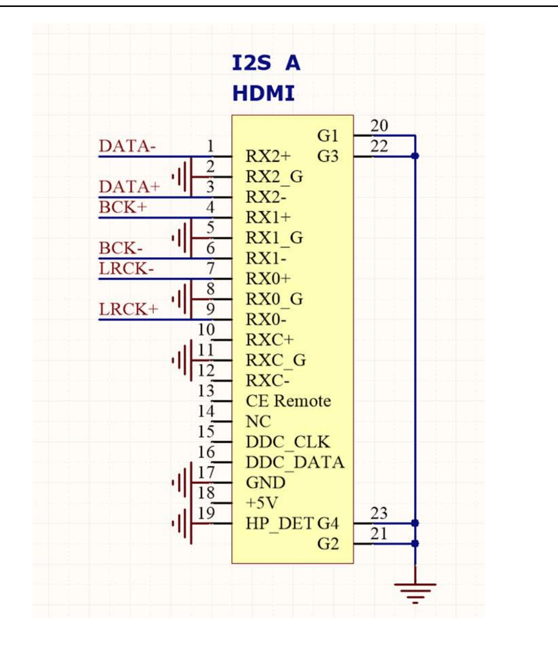

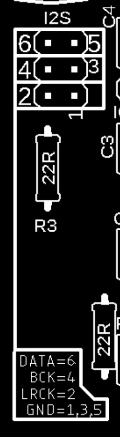

Hi everyone – I've finished up my 1862 board (rev 1.3) and PSU (v2). Super excited, as its my first endeavor into DAC/Digital DIY. Everything powers up and is looking great, but I'm not getting any sound. A few voltage checks at the dac and opamp suggest power is being supplied as intended. My main suspicion is the i2S source. I'm using a Denafrips Hermes and taking i2S (HDMI) from it to the Miro Dac (HDMI). I've attached a screenshot showing the pinout Denafrips includes in their documentation. Based on that, here's how I have it wired up:
DENAFRIPS --> Miro 1.3
3 --> 6 (DATA)
2 --> 5 (G)
4 --> 4 (BCK)
5 --> 3 (G)
9 --> 2 (LRCK)
8 --> 1 (G)
Does this wiring scheme seem correct at face value? Are there any other variables I need to consider when using the Hermes DDC? I'm happy to upload build photo tmrw to see if there's any flaw in the construction, but in my mind the signal configuration is the flashing red light.
Here's the link to Hermes documentation: https://www.denafrips.com/_files/ugd/4b933e_21e3eb20da334988acb98b834004efd3.pdf
Any help is appreciated! Don't assume any serious knowledge on my part when it comes to I2S and digital connectivity 🙂

@codyt The wiring seems correct.
I did not find the information in Hermes documentation, about the I2S frame size (how many BCK counts are in one LRCK cycle)? 🤔 ... for my DAC it should be 64 (2 channels per 32 bits in one sample),
rare converters have 48 (2 channels per 24 bits in one sample) .... in that case you would have to adjust the DAC a bit 🙂
Do you have a digital scope or something to see the output from denafrips?
  • Thank You
Reactions: codyt
Hey Miro – thanks for taking a look! I woke up bright and early, determined to get it figured it out. I removed the HDMI connection entirely, as I'd noticed the Hermes also provided a RJ45 I2S connection. I just completed the wiring for that and its making music!! I've got about 60 seconds of listening completed, but it sounds awesome so far!

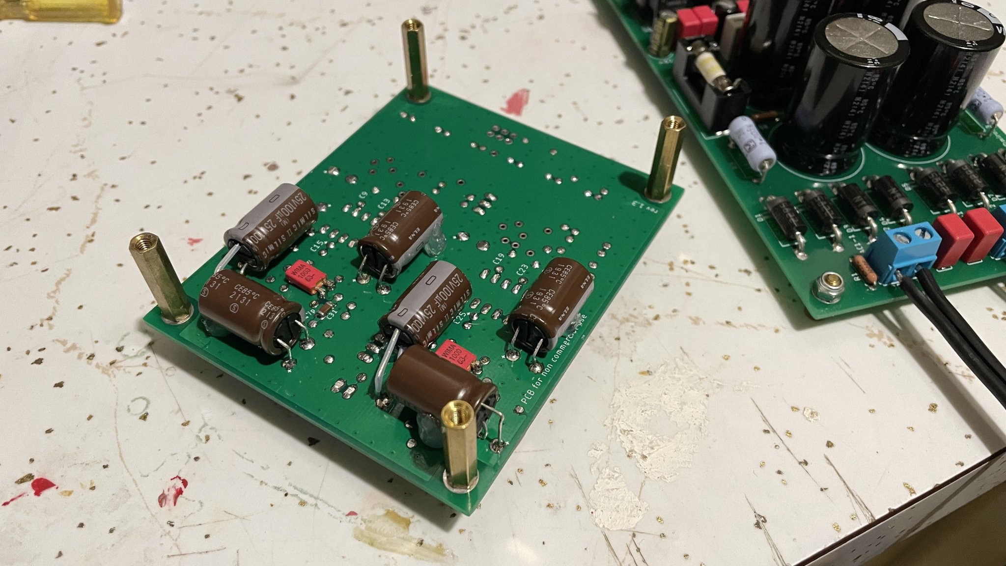

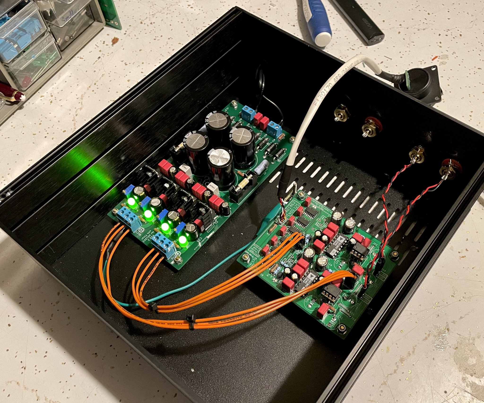

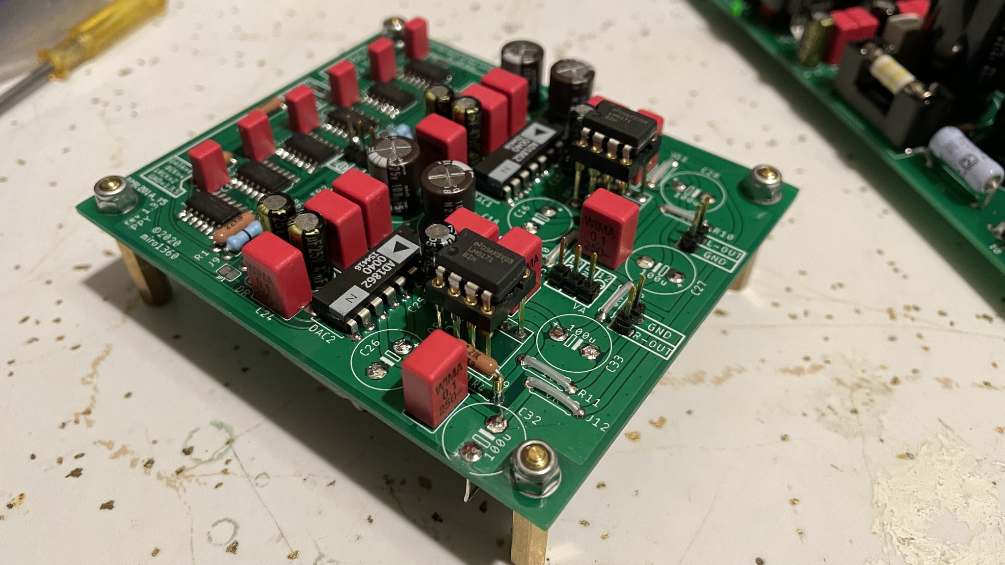

Thanks! It went together perfectly, aside from the hdmi hiccup. I haven’t finalized a chassis or layout yet, but here are a few pics in the meantime. I took your advice on undermount caps. Using TL071 right now, and have LM6171 to swap in later. Plus some discrete IV adventures in my future 🙂
PS. Big, big thanks to Keetesyflush for the free boards!

Imo, your LM oap socket is too far from the pcb...not good for such very fast video oap. C31 in the bottom, class 2 smd cap...are they really needed ???
Try to turn the pcb in the cabinet to make the i2s input wires as short as pkssible from the source.
All the rest is very clean, kuddos for a first build 🙂
Reactions: cozycactus
Thanks! I had a similar thought about the opamp standoff. My goal was to get the sockets high enough so I could experiment with discrete options (and didn't want to put everything on the bottom side). To be completely honest, I'm kind of using this as the 'experimentation' build. When I settle on final I/V, I2S input, chassis, etc, I'll most likely either build another board or redo portions of this and build a dedicated chassis. Regarding C31, I just followed the schematic I had. If I can do without, or if there are other wise cap, R, etc modifications, I'm definitely wiling to give them a try!
