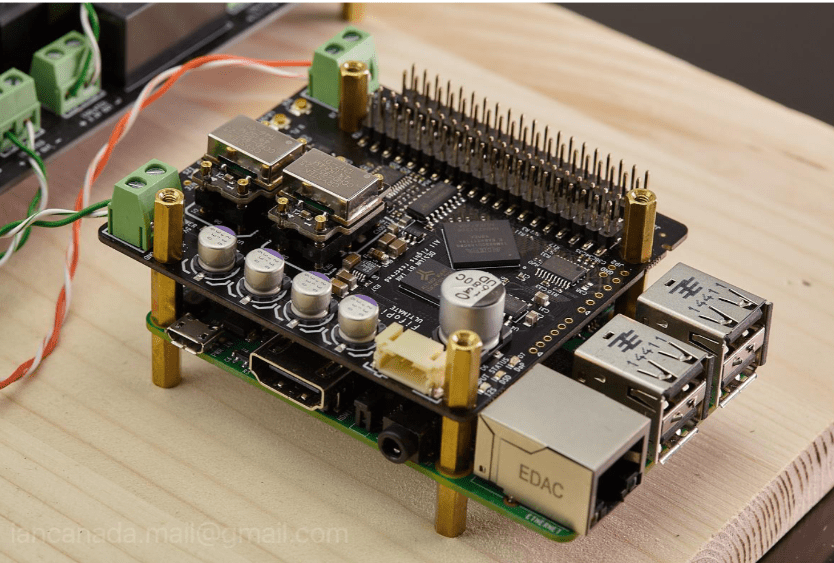

Anyway, look at wjat did Miro on that board to add your 3 uf-l sockets in the same order than the fifopi to avoid the cables cross itselves. Keep the register and avoid the i2stoPcm board... Use short uf l cables...2" is fine if you find it.

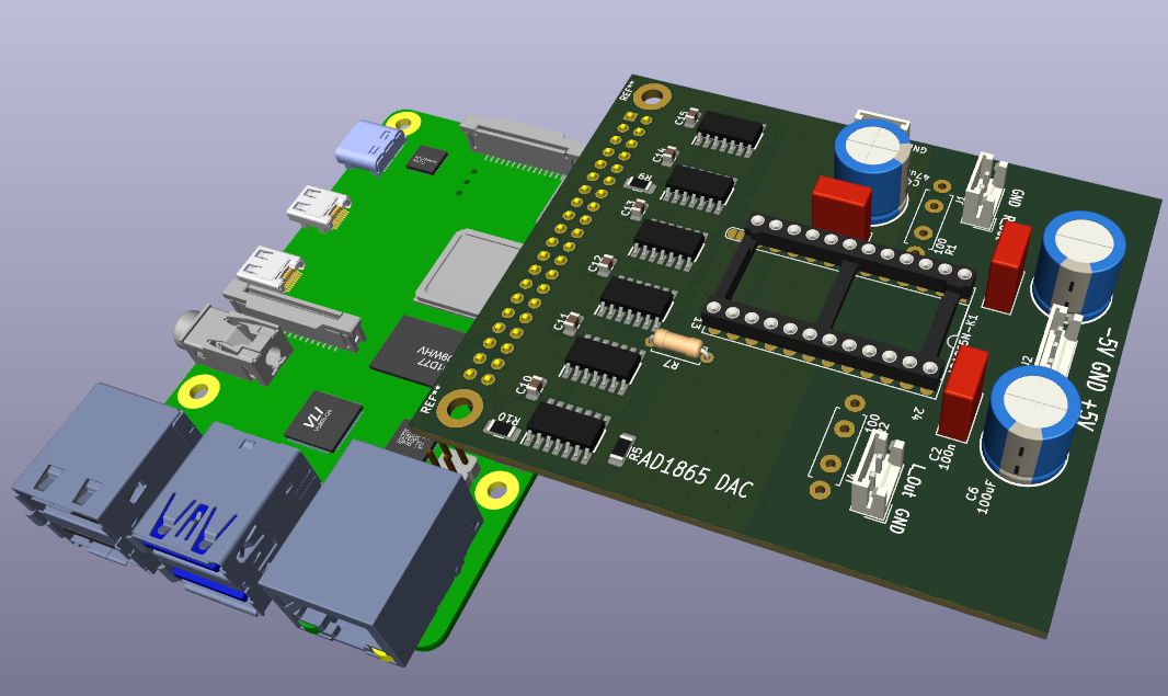

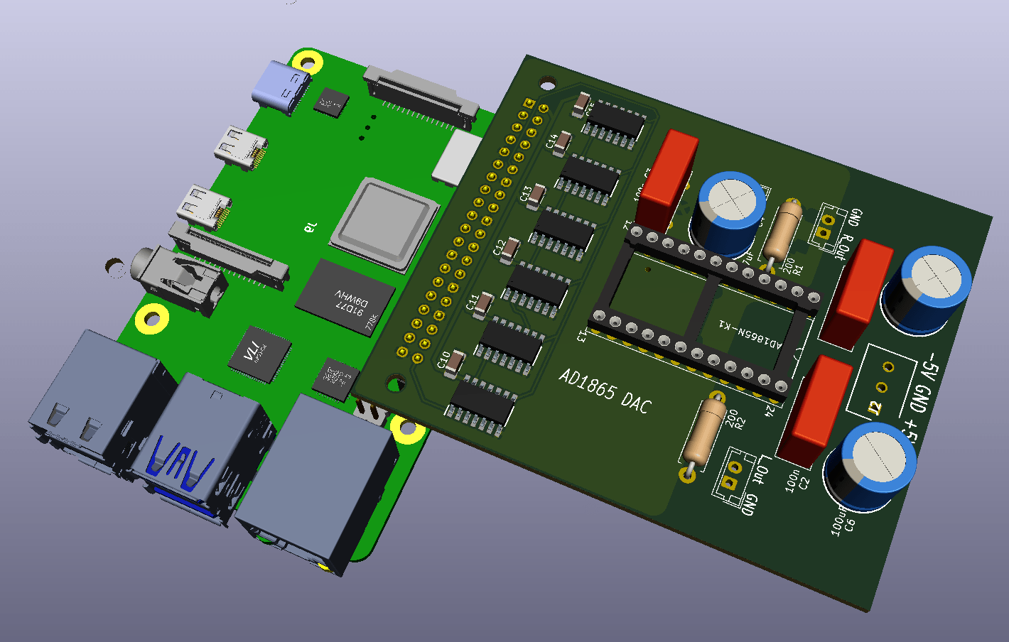

The attached picture was not too good. I used the RPi CAD model just for the pin reference.
In the reality, top of the Rpi would be the FiFoPi board, and my DAC connecting directly to the FiFoPi's isolated 40pin connector.
I don't want to use u-fl connector and cables. This is the base of my concept.

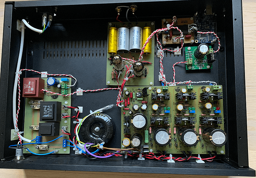

And why want I use AD1865? Because I already have this DAC, and sounds very good with passive I/V and tube ouput stage. This is the current configuration:

I never tried with the header, theorically it is the same than the uf-l or even better cause shorter. However I had always a doubt due to the material of the pins, plastic isolator, impedance respect...though few mm it should do not arm...but I don't know as I never tried the fifopi header, just its uf-l outputs.
Looks good, what tube do you use ? What reg for B+ please ?
I like the Jenzen and Jantzen DC caps... What are the main caps on the regs ? Looks like, Nichicon UKZ or Panasonic FM...even Black Gates Std ? But as I see another Nichicon I bet the black are KZ...
That is a really clean job you made...resistors also chosen with care. You will certainly surprised by the difference on the two digital front ends...

I'm using 6N23P-EV tubes. On the photo the output stage is an unbypassed SRPP, meantime I made another output stage, bypassed SRPP, and the Output capacitors are now V-cap ODAM.
Currently the B+ supply is a simple TL783 reg. something similar:
https://cdn.imagearchive.com/groupdiy/data/attachments/13/13618-09209bee75c0fa3174ef97d4b1fa75fa.jpgBut few month ago one of my fried recommended Ale Moglia's Mu-Follower panels (I built a phono stage with these Mu-Follower panels, and I have positive experience with it): https://www.bartola.co.uk/valves/2019/02/03/hybrid-mu-follower-aka-gyrator-rev08-pcb-update/
Main caps on the B+ supply are Nichicon KX 330uF. If you want to start now, go with the Mu-Follower panels. I also want to replace the old supply in the next few week.

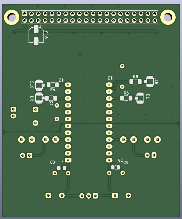

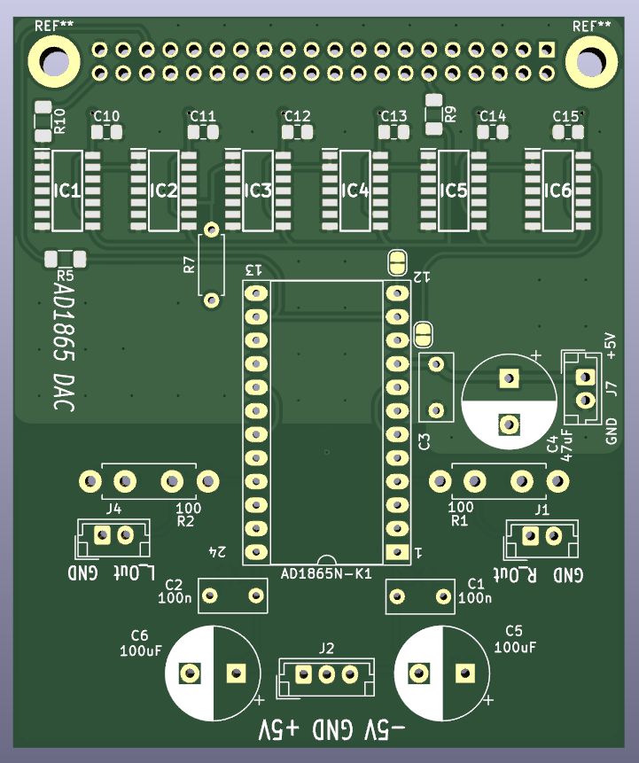

The pcb of the passive I/V AD1865 for RPi.
This version working with RPi, and there are 4pcs U.FL connector external PCM signal. Registers powered from the FiFoPi clean power, AD1865 digital part powered from separate connector.
If it looks ok, I'll populate Gerbers, and I'll create a another version U.FL connector for I2S signal instead of the 40 pin connector.
