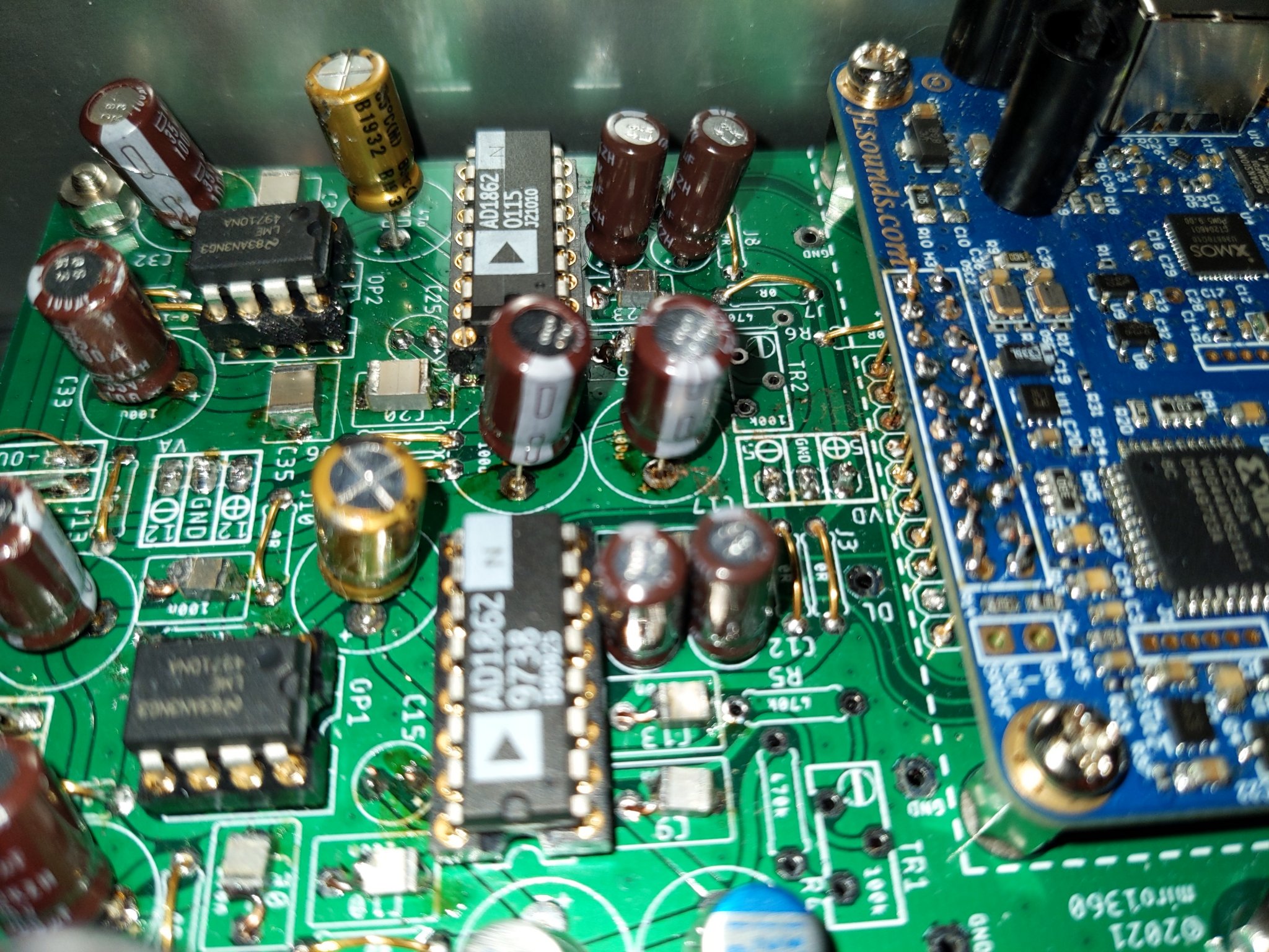

yes very lately after we talk. I made first the error because the marking with the two first bjt despite you advertised me, lthen eft it few months after some problems, then completed it later. Sounds more than good, different from my reference but hard to compare as my ref diy dac has a complex digital front end and clock and had 3 years of work, on passive parts and multiples supplies ! Stock, although yours sounded better than my stock ref tda1541A S1. I see you also use R-core traffos as I did and it is one of the little trick that sounds good with this dac chip... I surmise yours onthe photo are old Selectronic with the screen wirered to the main ?
Thanks again for the two boards you sent me back then. If you want to try Miro's for the curiosity I can send you some boards I have left.
here people
Right. I don't mean to hijack this thread in anyway, I'm just curious.
Did I send you the previous version with the non-smd output stage? I think I remember that there was an error there on the boards, which marked the transistors in the wrong direction.
I think maybe the AD1862 is inherently better than the TDA1541, so it's an unfair comparison. It would be interesting to test the AD1862 with a different discreet I/V stage.
I would love to test miro's boards for comparison. If you have a couple boards left you can pm me about it.
I don't remeber how I wired the trafos. I am guessing that I left the screens floating. My memory isn't very good these days.

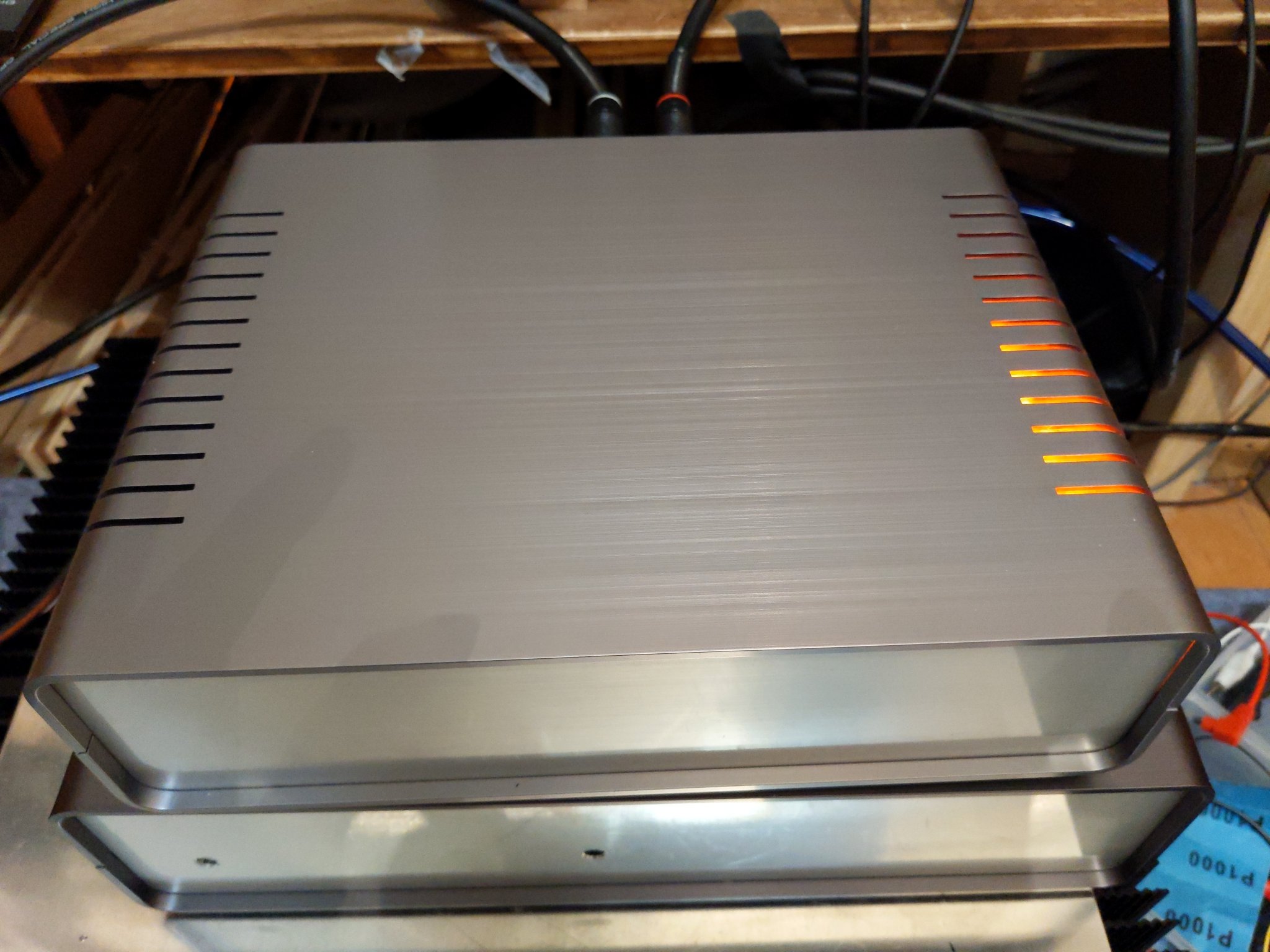

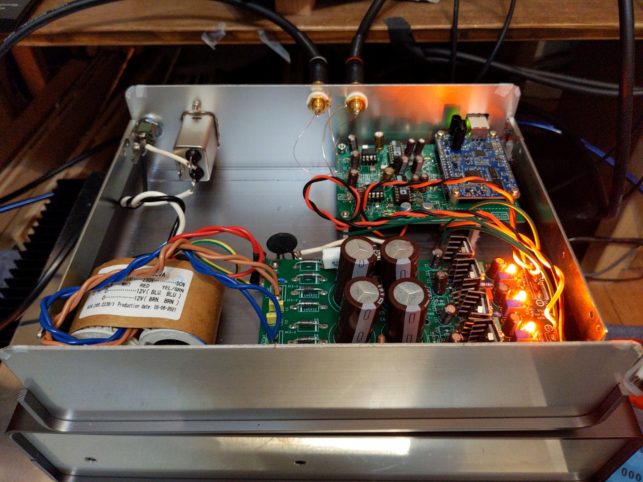

Finally I could finish the DAC.
I appreciate to Miro,Meanie,Garcia and ppl here.
I use to use Topping D70 using XLR connect.
Now I concentrate on music and more enjoy the siund more than before.
