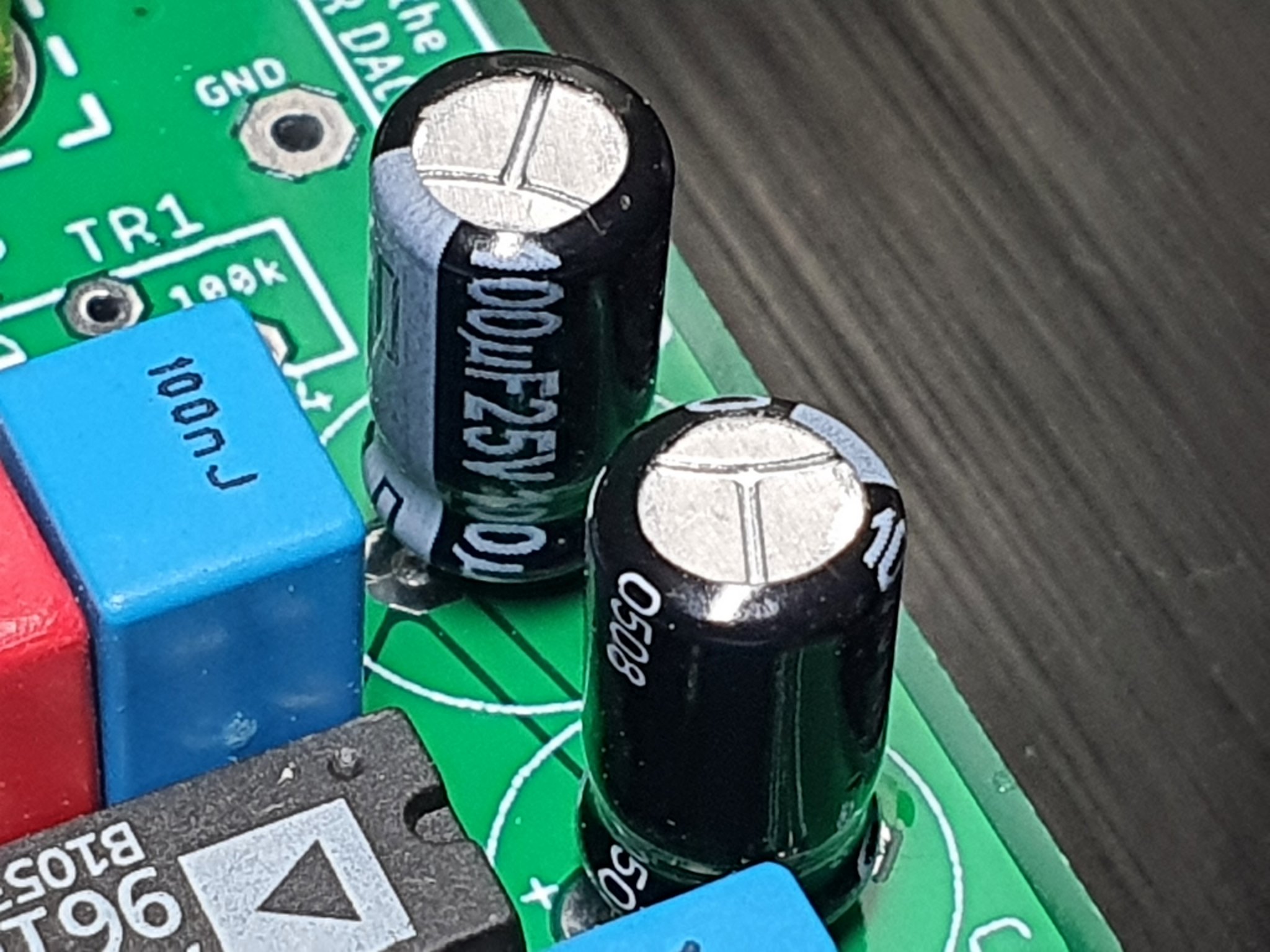

Thank you @meanie for the confirmation.I recently scoped my Psu2 with the " not flipped" pcb, with all the 100uF decoupling caps fitted.
I did not see any oscillations on both the 5 & 12 v dual rails.
What capacitors did you use (exact name/type)? 🙂

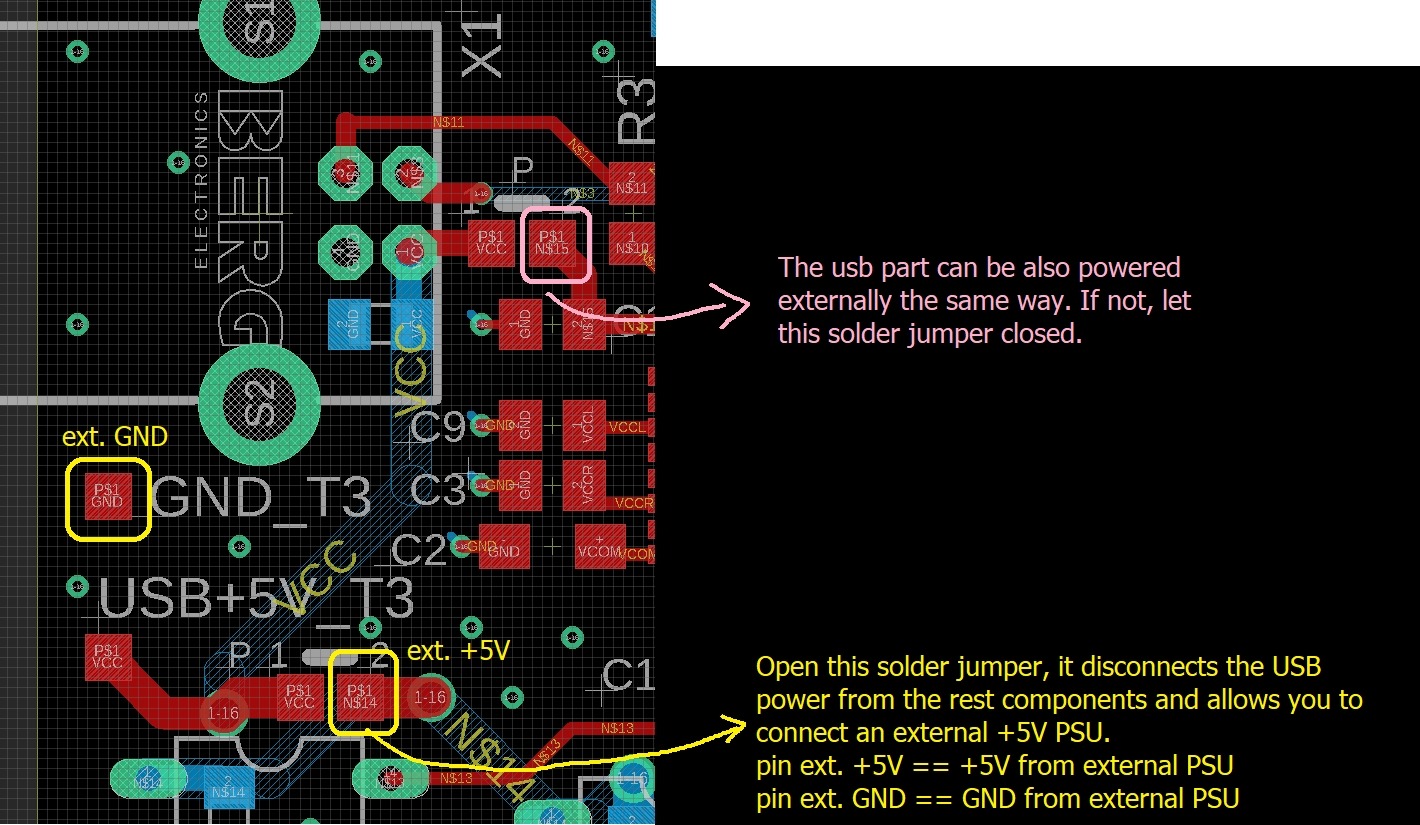

Good evening Miro, I would like to apply an external 5v socket for the EASY DAC. I have a socket with a built in switch, that pass through the usb power, if no plug is in the socket.
I would be happy if you showed me the locations for ground and 5V in from the external PSU.
Thank you 🙂
Thank you 🙂
To be a bit more precise, I would like to power the PCM chip by USB, for example a phone, and all other things by external 5v. Is this possible?
Ok Miro, it does work 🙂. Unfortunately not as intended, since I found out, that the switched sockets switch the ground and not the pos. voltage. ??? No idea why. So I need an extra switch or I keep it for permanent external PSU.
Btw, my phone can deliver the needed 400 mA - for a short while. I was surprised by that.

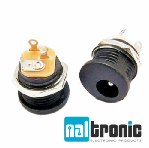

Hi Miro, this is the socket I mean. It has got a three pole arrangement. When no plug is attached, two of the three pins are internally connected. In case of an attached powerplug, this connection is opened and just one of the two is connected to the plug. My plan was to connect the USB power to the DAC part via the 2 connected pins, when no external psu is used and have it automatically disconnected in case of external power. Unfortunately this is onyl true for the barrel (outer) contact, not for the inner pin. As usually the middle pin is used for +V and the barrel connector (outer) for grnd. So if I wanted to use it as intended, I had to change the polarity of the plug.
Usually I listen via PC to this dac, and in this case the 400mA over USB is not a dealbraker, yet sometimes I take the DAC with me, when I am listening to music from the phone and then the 400 mA empty my phone too quick for my taste. That is why I bought a powerbank in order to power the DAC part.
@ernesternest I see the socket. You can create Y USB cable by connecting 2 USB cables together (one will carry both (data and power) and the second only power from the powerbank) 🤔
