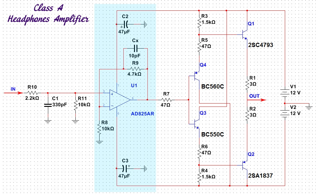

Maybe to do opAMPs on output - LT1469 in i-v and LT1122 in filter (and made on output small class A amplifier as optional)? 🙂

The biggest advantage (after drive capability) for a discrete output stage is the ability to keep the switching noise away from the opamp's power rails through judicious filtering. I suggest LC or RC on the opamp's power or alternatively shunt regs.
Thanks for recommendation, but I don't like lt1363/64 and lme49990 (and 49860), the sound is very good, but a little not mine. 🙂
Starting to draw AD1853+LT1469+LT1122. 🙂

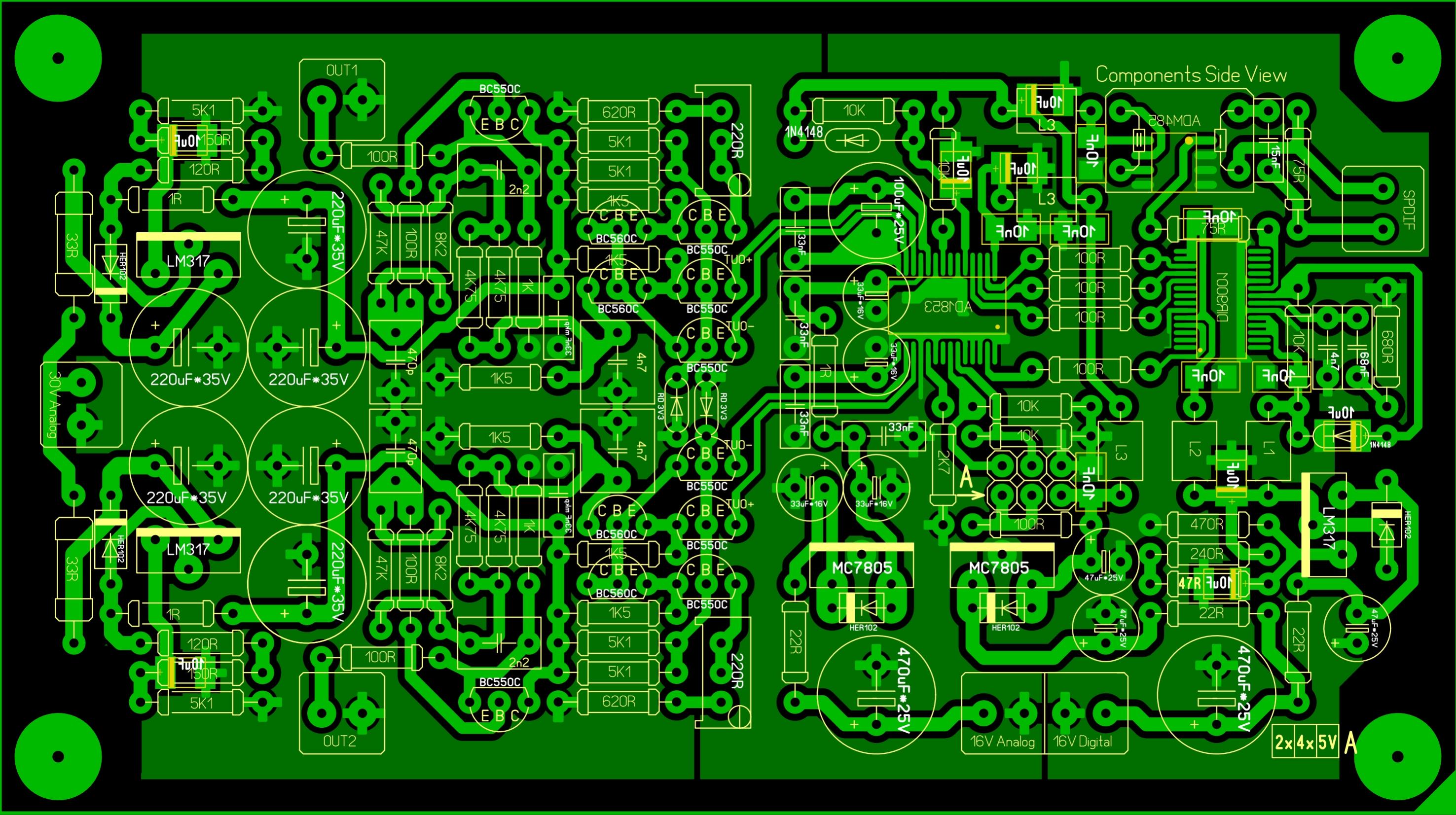

PCB for AD1853+discrete (not my).
I draw 2 layers PCB for AD1853+opAMPs, then will draw 2 layers PCB for discrete output. 🙂

Not enough information about the sound of discrete output: "the sound of discrete output differs from the traditional opAMPs" and all. Someone like - someone hates.

What does a current out DAC need?
Low Input resistance of the I/V (although a switched capacitor output stage as the AD1853 is not that sensitive, R2R DACS are much more picky). This impedance should be as flat as possible over a broad frequency range, as the DAC spits out, inherently, a high amount of HF components.
The shown discrete Output stage is NOT an OP Amp style stage, but common base open loop.
It has a low input impedance, which rises way later in the frequency band than a op amp I/V (which relies only to a high Loop gain, and it decreases quickly with rising frequency.
I suggest you to leave the discrete output stage as it is (at least from a topology view). You may look to increase the bias current through VT4-8, it gets better when their bias current is >> max current swing of AD1853 (AFAIR +/-3mA).
I'd bias them at least to 10mA.
Anyway, common base stages are the way to go for DAC I/V.

DAC will be not work on low impendance, 1 mA maximum output current. 10 mA bias can damage BJT (300 mW maximum).
I think too - build DAC with opAMPs (and to make discrete output for interest).
