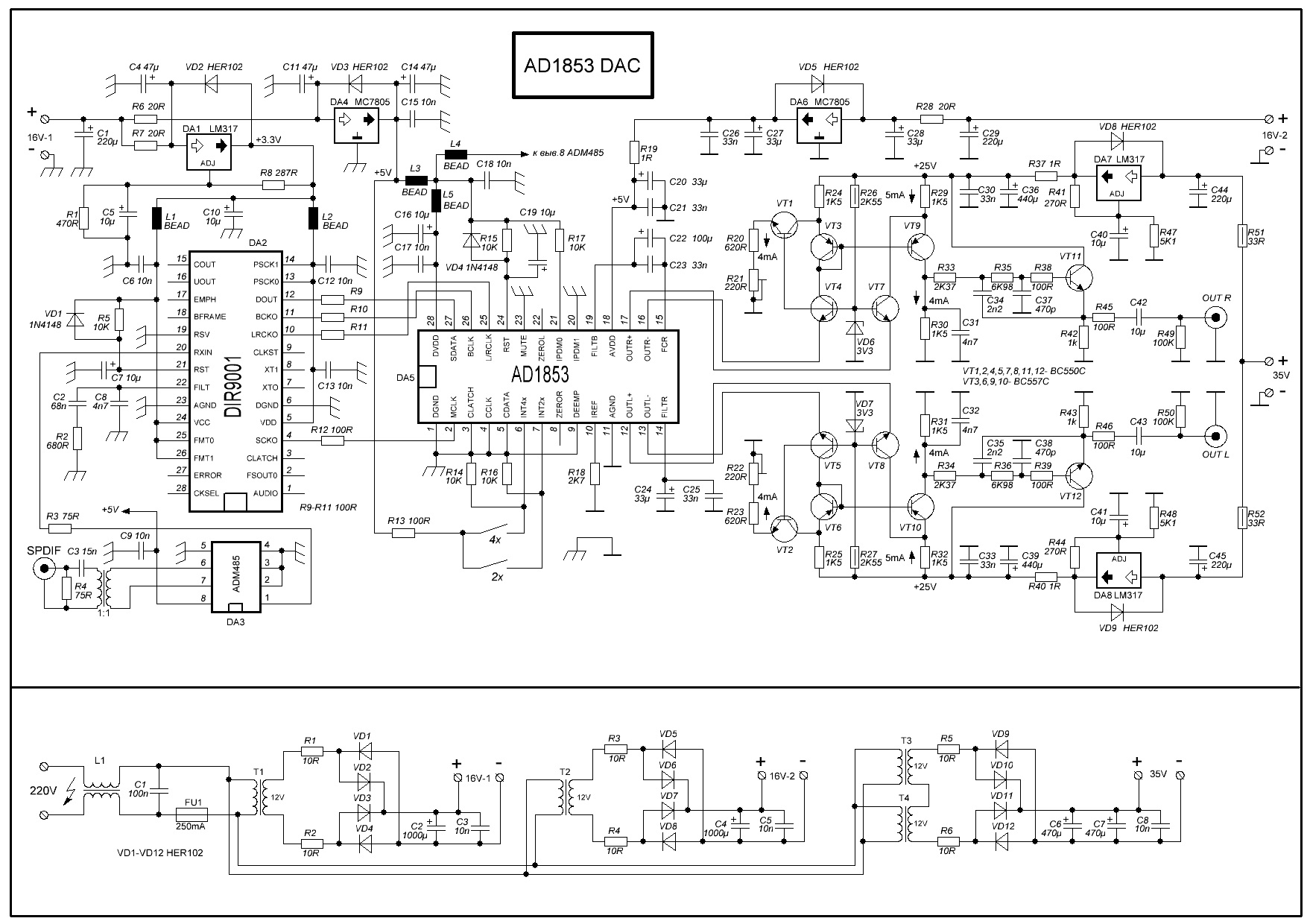

DAC will be not work on low impendance, 1 mA maximum output current. 10 mA bias can damage BJT (300 mW maximum).
what?? Are you talking about AD1853? It has a high impedance output. It needs an I/V stage, which is low impedance per definition. Look up the datasheet, and study the op amp output stages which are recommended. They have virtually 0Ohm input resistance at LF.
Your posted circuit might have about 5 to 10 ohms.
Re the bias...of course you have to chose the right transistors. 10mA would mean 30V over them for 300mW btw.........

the decision for a discrete IV stage, a openloop common-base in this instance, is a good one. ;)
The sound is regularly more authentic and more reallifelike.
Most OPamp stages sound technical to my ears.
Also as Sottomano states the lower the IVs input impedance and the more linear towards HF the better.
This is rather seldomly discussed here in the Forum and I assume that most apologets of OPamps simply don´t know about the input inpedance related issues.
Also the current through Vt4 and Vt5 defines input impedance.
The higher the lower the Zin.
Beeing a class-A stage the current must be higher than at least 1/2 of the DAC´s p-p output current.
But that´s theory ... in practise it requires at least 5 times the minimum value to keep THD low enough.
The circuit here could be twaeked in that You omit with Vt1, Vt2 and their emitter resistors and putting a resistor from each of the nodes Vt4/pin16 and Vt5/Pin13 to gnd (560R as start value).
This swill keep Vt4´s and Vt5´s emitter at the required Vref of 2.7V and allows for sufficient current (~5mA) through Vt4 and Vt5 to keep them safely in class-A.
If the heat power losses of Vt4 and Vt5 don´t suffice they may be replaced by a CFP stage, which also has the advantage of lowering the input impedance considerably.
Transistors Vt7 and Vt8 then also require the same measurements regarding their idle current.
Hence Resistors R29 and R32 need to be lowered to cope with the raised current values.
Routing Vt7 and Vt8´s current through these resistors is a nice way to do the balanced-to-SE conversion and it looks like a clever kind of THD-reduction at the same.
Other Tweaks that may reduce THD could be a change from the simple current mirror to a Wilson CM (adding just two transistors) and replacing the resistors R30, R31 by active current sources (just two additional transistors their Bases biased from VD6 and VD7).
The same applies to resistors R42 and R43 in the output buffers.
Another possible tweak could be to omit with the 2nd order output filter.
It seems that the AD1853´s output noise raises only >300kHz.
This renders a classical output filter obsolete and I´d replace it by 1st order RC-lowpass of 300-400kHz just to keep HF off of the following device.
Alternatively or additionally a small cap of a couple of pF between Vt4/Vt7´s emitters, resp. Vt5/Vt8´s emitters could remove possible glitch artefacts of the DAC and HF noise from entering the IV stage.
A last tweak regards the voltage regulators DA1, DA4 and DA6.
There are more modern lower noise regulators around.
The tweaks will lower numbers but will it improve sound?
Maybe, maybe not ... it´s not uncommon that the simplest circuits sound the most pleasant even if certain numbers look supsicious, yeah even ridicolous.
I´ve rather few doubts that the circuit has the potential to blow OPAmp stages off of their thrones with ease. ;)
I certainly like it :D
