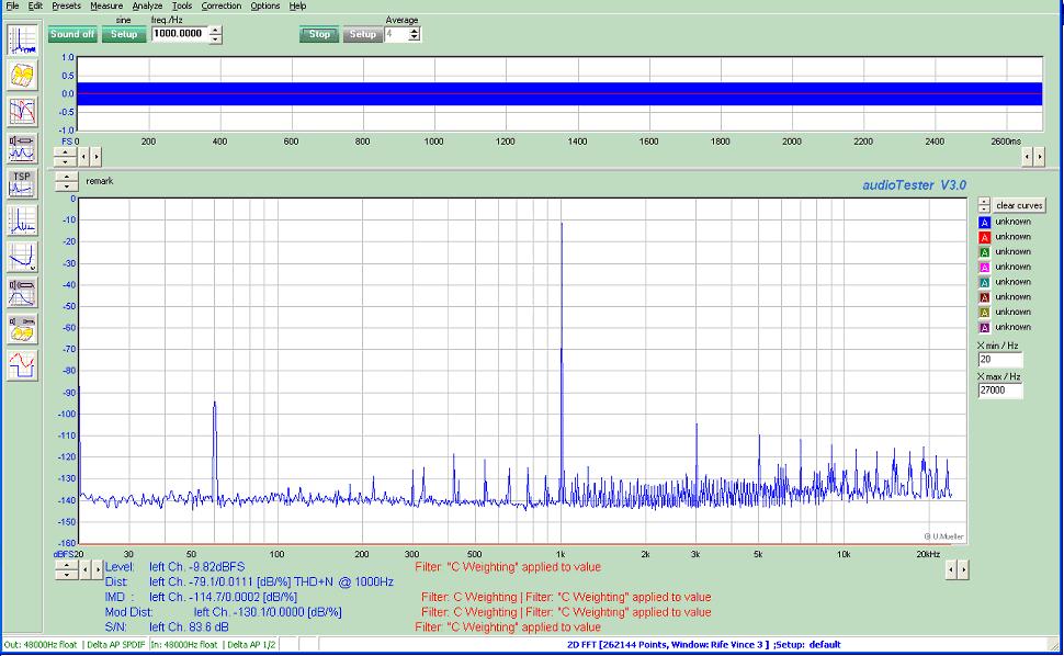

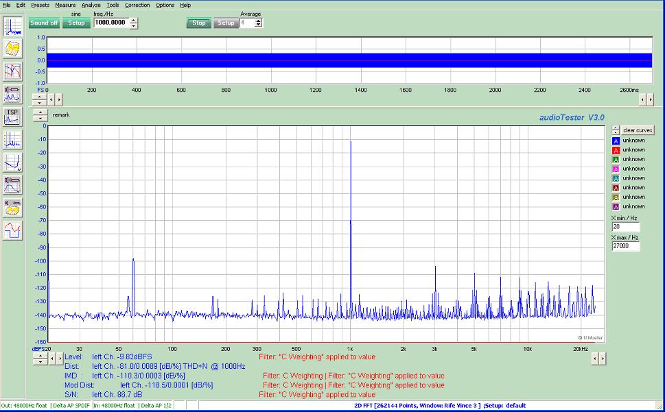

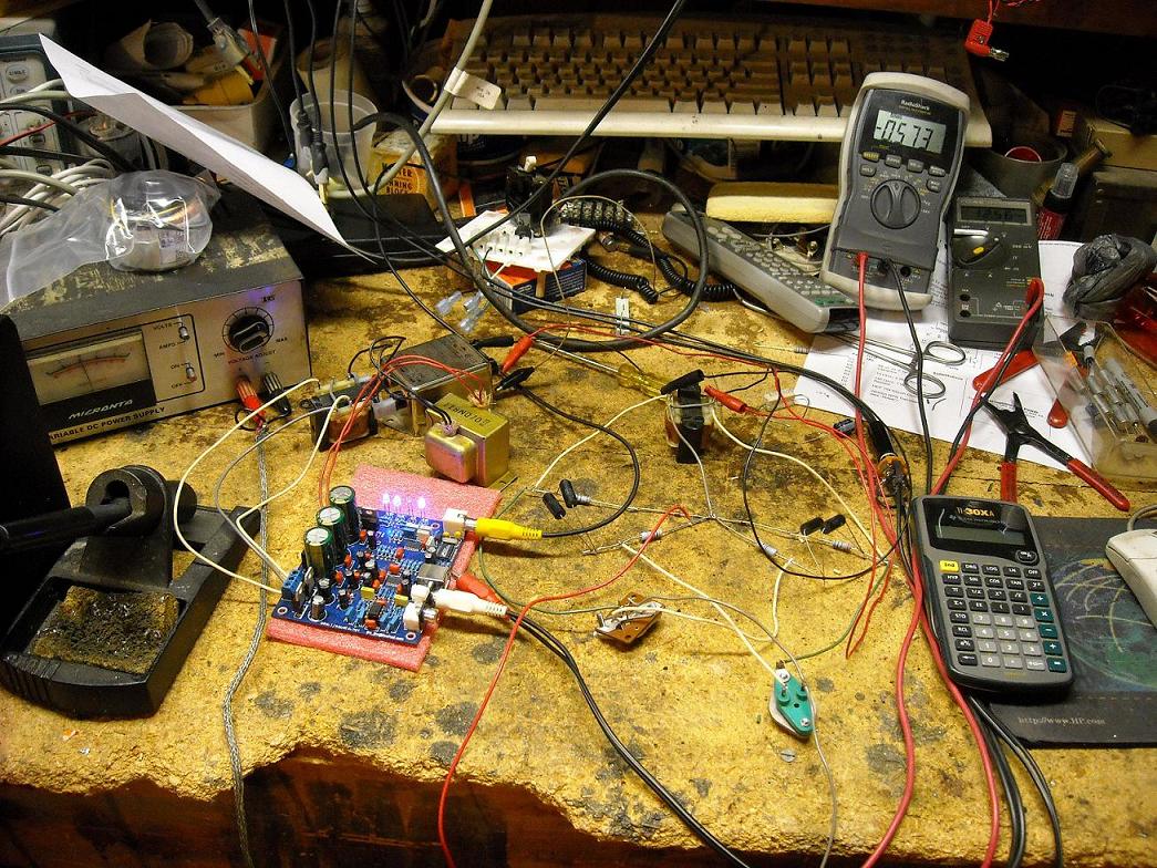

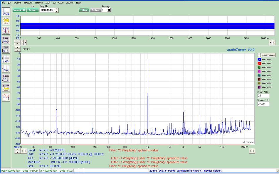

Out of Curiosity (killed the cat) I decided to try the switcher again. I adjusted the frequency up to 64Hz in the hope it would be a bit more efficient.
I then hooked my DAC board up to it, and ran a FFT to see how it compared to it running off mains.
As expected, there was a degradation in performance, although not as bad as I thought it would be.
Finally I added a line filter between the switcher output and the transformer input to the DAC board to try to filter the noise. It worked pretty well with readings within .1dB of line powered.
Input voltage is 12.56V at 0.573A. I can drop the input voltage to 9.1V before the DAC drops out of operation.
FFTs are 1. Switcher Powered, 2. Switcher Powered with Line Filter, and 3. Line powered.

The bench is covered with 1' X 12" boards of what is called 'Particle Board'. It is a low density composite from sawdust. Unfortunately the boards are over 30 year old, and the dimensions of material today (metric) is different enough that I can not replace the front one without replacing all of them. So they remain.
The graphs are FFTs with a 1KHz tone at -7dB. The higher the peaks of the noise and harmonics, the worse it is.
With line powered transformers
THD is 0.0087%
IMD is .0001%
Modulation Distortion is 0.0003%
S/N is 86.8dB
When I powered the system with a switching power supply to generate ac from 12.6VDC, the figures went to:
THD is 0.0111%
IMD is .0002%
Modulation Distortion is 0.000%
S/N is 83.6dB
So THD got worse as did the signal to noise ratio. S/n suffered by nearly 6dB.
Adding a line filter between the ac output of the switching supply and the step down transformers brought the distortion back to what it was originally.
My conclusion was the switching supply does degrade the audio quality, but can be compensated for with a simple line filter.
