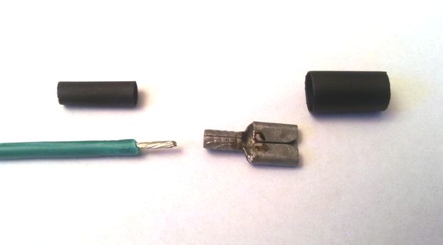

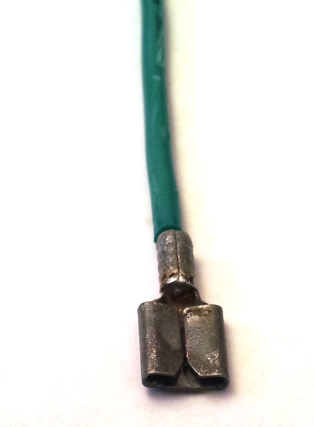

This probably should be in the techniques thread - but I've pretty much given up on the pre-insulated connectors. The most economical method with U.S. parts has been a combination of the following.
Quick Disconnects here
Heat shrink Tube here
....available in colors or all black.
Larger size long enough to overlap small tube.
I've just had too many crimped wires come apart so I solder everything.
Custom results with the ability to disassemble if needed.
The only other good value packages I've found for pre-insulated pieces are here but their shipping charges up the cost. Radio Shack "Ship to store" saves a few bucks.
I always solder to the disconnect too, just to make sure there's a solid connection. I've thought of using heat shrink tubing on them, but have never tried. HS tubing adds a degree of security to the connection as well, and looks professional. Gives it a nice 'tight' appearance. Yeah - I'm afraid we've wandered a bit OT. :D
