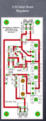

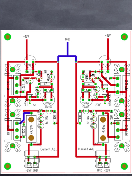

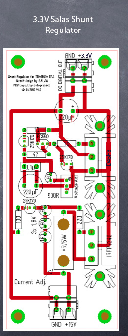

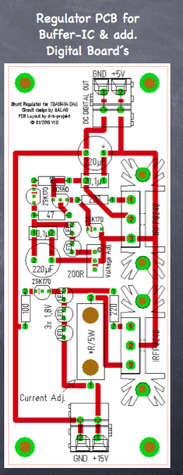

Yes Im using salas shunt

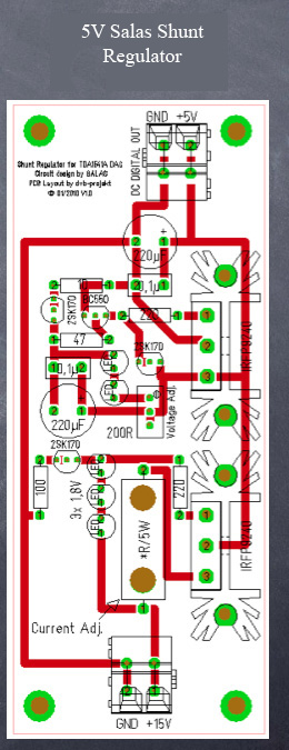

(2) 5v for digital and analog
(2) 3.3v for digital and analog

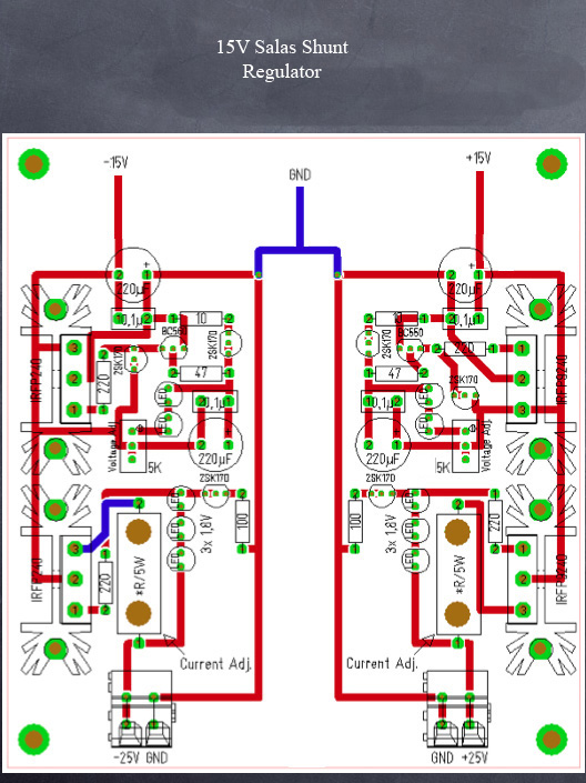

(1) 15v + for opamp
(1) 15v - for opamp

I used this as a reference for the 5v and 15v
I have the 3.3v at home. I will upload that later.

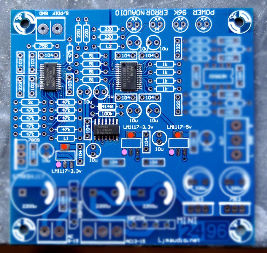

NebuK, I think the temperatures you measured are correct.
Consider the 1117-5: the dropout is 12-5 = 7 V, the current drawn from the AK4396 is 32 mA (from AK datasheet, typ. value), so the power dissipated in the 1117 is 224 mW.
The thermal resistance of the 1117 (junction to ambient) is 136°C/W, so the junction temperature will be 30.5°C over the ambient; assuming ambient is 22°C, the junction temperature will be 52.5°C.
The junction to case thermal resistance of the 1117 is 15°C/W, so the 1117 case will be 3.6°C less than the junction, that is about 49°C, very near to the one you measured (50°C)
You don’t have to be worried about these temperatures, they are quite normal.

So I decided to put everything on a test board just for fun and listen before assembly. I built the PSU first, then the output. I use 5Z4S and 6S6P tubes.
I was nervous, because I always have a first time plug in paranoia. I was thinking a cap will be faulty and pass HV DC to my system, even if I measured everything correctly.
But I plugged everything and it was visibly ok. I took my cheap HD201 headphones and check if a sound was going to play.
Great! Both channels worked. I saw "Enya" on my playlist. I put my headphones on and...
Woaaaaaaaa. My mouth was wide open and I felt so weird. I felt like swimming in a space of MAGIC. The music had its own space, the voice was distant, the instruments sounded like from few valleys ahead!
I can't describe how great is this. Some songs became so dynamic I couldn't even image they could be. Instruments I was trying to follow and I was losing before are apparent now, I catch them! The bass it's so deep I didn't think it was possible to be. The highs live! The voices are soft and sing infront of me.

- Digital Line Level
- DAC 2496 (AK4393) DAC KIT With CS8416+AK4393+5532
