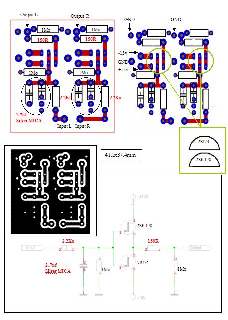

Hi ,
Actually this very simple output stage give me satisfactions !!
But you need an input capa on the preamp or amp .......
Of course the +15 -15v is a SALAS shunt reg .....
Serge
Interesting :)
Did you take in account the peculiar LPF needed by AK4396 (fc=125kHz, Q=0.692)?
