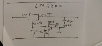

Yes you add 100R between the GND leg of the reg and GND of the pcb. Then that is your ADJ pin now. But you showed the denoiser. There's the dienoiser as well which pushes it even further. Just add a PNP and a resistor extra:
This is for positive rail LM78xx. For negative you switch all polarities (caps, diode) and swap PNP and NPN between them.
A few details:
The LM78xx implementation also needs the 220uF capacitor as in the upper photo. For LM317 you need to flip its polarity, and you need to keep track of this when doing the negative. Very easy to get confused. For example I used LM317+dienoiser for positive and LM7912 +dienoiser for negative.
LM337+dienoiser for negative is not stable. LM79xx+dienoiser aparently works with only 20nF Ccomp. If you ask me I'd go for LM7x12 +dienoiser for both rails on this dac. LM317+dienoiser is stable in my case with 40nF Ccomp. 20nF seems to be good enough for LM7x12+dienoiser.
Also for LM3x7 the 220uF cap needs to have a similar voltage rating to the output voltage. For LM7x12 the 220uF can be 6.3V rating as there's low voltage across it. That means you can even get away with 1206 in that spot, and it can be installed instead of the smd electrolytic on the latest pcb I made on that thread.
22uF needs to have a larger than reg output voltage rating on all designs and regulators used with the de/dienoiser.
R3 in the above schematic has to be adjusted according to the output voltage for best performance.
For the LM3x7+dienoiser you have the recommended values here:

Ignore the 220uF polarity shown in the 78xx/79xx post with tables for resistor values, it's put wrong there.
A few details:

Also important detail to add. For best results it's recommended you sense the regulator output at loading point. That means you install the add-on pcb close to the load, and keep short sense wires. The ADJ signal wire is higher impedance and can be ran longer without pickup issues.
In my case I tapped the +/gnd from the input of the ams1117-5.0 used for VACC and -/gnd at output opamp capacitor.
Also important note: lm317 does not like low esr caps on the output. You need to be around 0.2R for it. Don't go lower or you might get instabilities. I just replaced the output caps on both rails with a Panasonic FC 100uF/63V which has the ESR in this area. Considering the performance of the dienoiser I don't think it's necessary to go high capacitance with ultra low esr caps.
