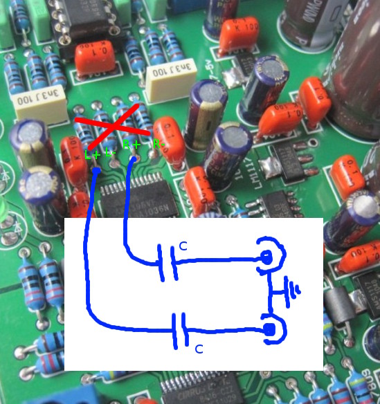

Yes I came across the drawing on page 13 before.
So if I'm correct L+ and R+ are connected to ground through a capacitor, it's value to be determined by experimentation.
Then L- and R- become the left and right output?
What are the requirements of the capacitors? Should they be polypropylene or even more exotic?
While determining what value is best, what should I pay attention to?
Not to ground. Pic shows L+ n R+ to centre of rca sockets.
If your preamp does not already have a input cap, I think 1uF ~3.3uF should be about right.

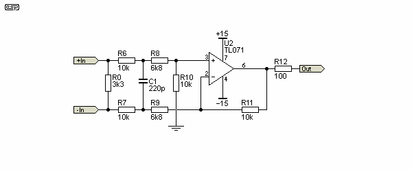

Looking at the ak4393 datasheet page 20 figure 12, external LPF with balanced and unbalanced options, it shows the DAC output goes into 47uF caps. That's quite a large value for film caps. Doable but still pretty large compared to the 3.3uF you mentioned.
Yep sounds free when you bypass LPF and Opamps, technically its not recommended but its the best way to listen to this Dac in my opinion.
Isn't the low pass filter needed? My active crossover will have balanced inputs, curious if I can drop the unbalanced conversion from the DAC.
Also how would you implement stereo volume control for balanced signal.
Ah, the 47uF is part of the high pass filter. So the cap value depends on the input impedance of the next stage/preamp.

Seems like dropping the cap is ok, removes the high pass filter. If you have some DC you can remove it later in the chain where it's more convenient. But before volume control.

Seems like I can make a small shield to convert to balanced output. It has the same type of filter, just that it uses two LME49724 opamps.
Basically I'm using the same filter parts, most of the parts used I'll recover from the DAC pcb, I just need the opamps and 4 100ohm resistors.

The capacitors are removing any DC from the outputs. You can omit them if you do remove the DC at some point. Usually preamps/amps have input caps that take care of the DC. But you need to try and see where it gets removed in the chain. It is good to do it before the volume pot.
