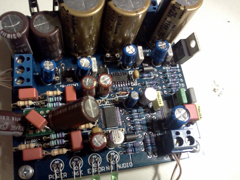

Capacitors shoot-out
This week end I've done a lot of cap swapping and hearing with these results:
C1
FKP2 BIG: better control on bass, deeper soundstage, slightly more refined
C27,C29,C34,C31
BC038 47uF 63V BIG: fuller bass, wider and deeper sounstage, more refined
C8,C9,C21,C11
SMR 100nF BIG: wider soundstage, more reverbs, more refined
C3
BC038 100uF BIG: Body, soundstage, musical, better than solid
SEPC 470uF 6.3V BIG: Body, wider and deeper sounstage, slightly warm
NCC SCC 220uF As SEPC but harsh: OUT!
LS 150uF As SEPC but slightly less warm, soundstage a bit wider VERY GOOD ALT.
Fujitsu 100uF As SEPC but quicker, slightly less warm, slightly deeper bass
C28
SEPC 470uF 6.3V BIG: fuller bass, wider and deeper sounstage, more refined, musical
NCC SCC 220uF As sopra but harsh: OUT!
Fujitsu 100uF As SEPC but slightly quicker and less warm, soundstage a bit wider, slightly deeper bass, musical VERY GOOD ALT.
LS 150uF As Fujitsu but più somewhat slower, slightly smaller soundstage
C33
Cerafine 10uF BIG: bass, authority, soundstage, reverbs
BG sTD 22 uF BIG: bass, authority
C35
BG sTD 22 uF BIG: bass, authority, soundstage, reverbs, cleaner
C12,C15
No bypass NICE: bass, authority, soundstage, reverbs
SMR 100nF WORSE: Soundstage collapse
C20
No bypass BIG: soundstage, reverbs, cleaner
SMR 100nF BIG: As with no bypass but not as good
C18
No bypass NICE: soundstage, reverbs, cleaner
C30
SEPC 470uF BIG: migliora soundstage, pulizia, bass più autorevole e controllato
LS 150uf As SEPC, slightly less warm
BC038 10 uf BIG: soundstage, cleaner
C32
BG STD 22uF BIG: soundstage, cleaner, bass gains authority and control
Cerafine 10uF Quite as BGs
BC028 47uF Quite as Cerafines with a bit of harshness but more authority
C19
X7R bass is more present but bold, not controlled, smaller soundstage
SMR 100nF A bit better than X7R but somewhat more confused and muddy
C12,C15

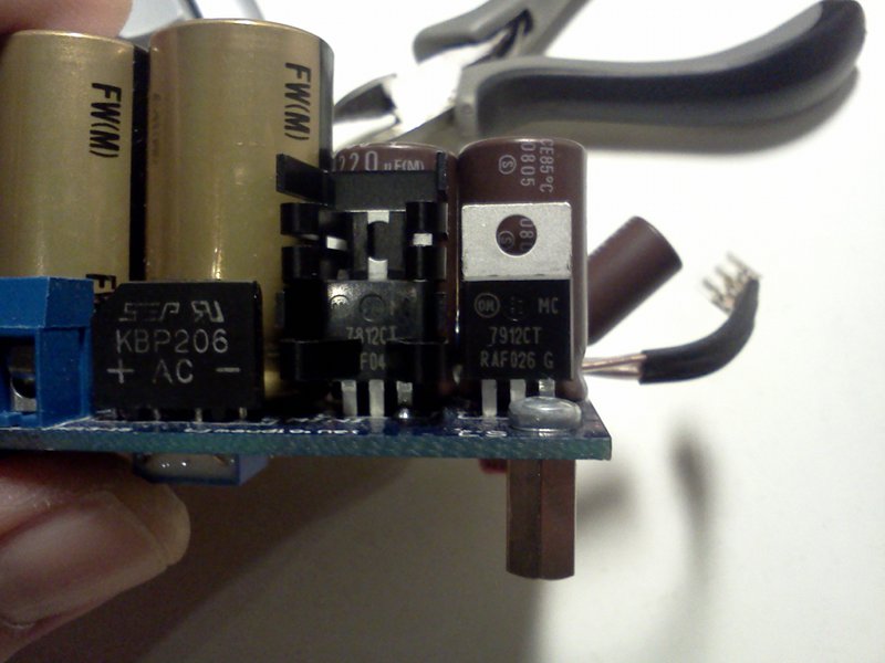

I've also swapped the two 12V regulators with On Semi MC7812CTG/MC7912CTG: BIG improvement on bass, soundstage, cleaner sound.
As per Jean-Paul recommendation I'm using a heatsink on the 7812.
So I've updated the BOM, attached with some photos too
As always it's still a work in progress... 😉

The secret is the use of sockets.
You don't destroy the PCB and cap swapping is fast and easy. 😉
I guess I am going to need a stack of sockets... I hope there is enough space for all the combinations ... in the past I have been talked out of sockets because of possible affects on sound quality. Personally I have never noticed anything bad... but do you have some recommended sockets from this point of view?
George
These are very good quality ones:
Buy Connector IC Sockets Socket,IC,SIP,2.54mm,Sn/Au,10P Tyco Electronics 1814655-7 online from RS for next day delivery.
BTW remember that they're mounted only for the testing phase, after component selection is complete they're removed and components directly soldered. 😉
If you made an order from RS Components remember to order also the heatsink:
Buy Heat Sinks HEATSINK FK237-SA-2 Fischer FK237SA2200 online from RS for next day delivery.
In the next days I'll post a real BOM with RS and Mouser order codes.
